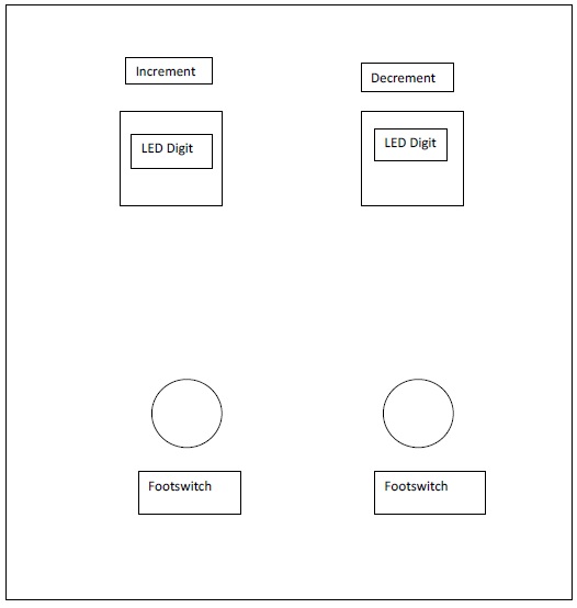

I want to build an increment / decrement stomp box for my kid. The unit to be controlled requires a TRS 1/4" plug. I think the tip is inc and the ring is dec. Sounds fairly easy but I was hoping for a couple of bells and whistles. Like maybe a couple of LED digit displays that displayed the inc / dec number he was on, right next to a soft switch that he could push. Just wondering if anyone may know of an existing diy design that I could use. Thanks.

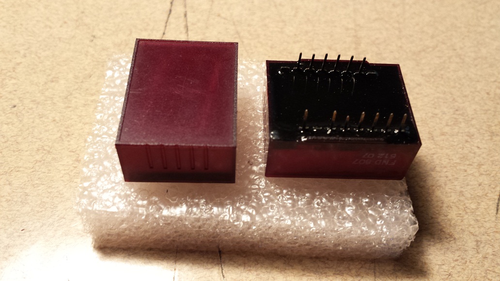

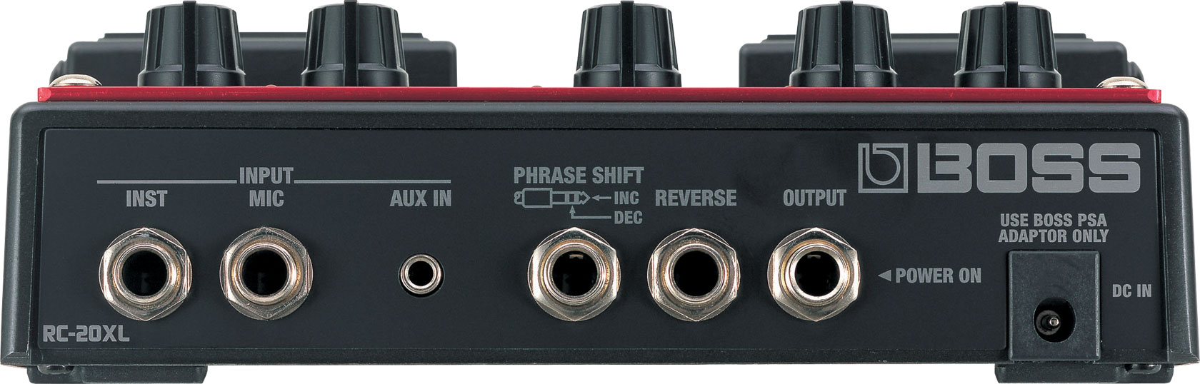

Hey Enzo, it's a Boss RC-20XL. I attached a picture of the back. It doesn't come with a pedal for the inc/dec. I have a couple of LED digit modules and I thought it would be cool if they read out the number of the inc or dec position he was on.
Here:
http://bmamps.com/Schematics/Boss/Boss_Roland_rc-20xl.pdf
That appears to be a two input logic port. Even shows INC and DEC on the rear panel. So it would be simple enough to ground out each of those inputs to see if they do what you want. So making a up/down control ought to be a snap. What I don't see is a readout on the panel, I don;t see any digital information to tap into. You could make up a digital readout, but I am not sure how you would make it a reliable indicator of where you were on a musical phrase.
