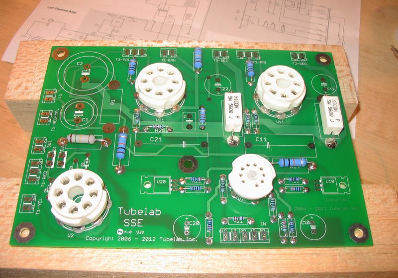

IN4007 orientation (D3 and D4)
Hello. I have finally started assembling my SSE. I'm ready to install the IN4007 diodes and I'm not sure which way they go. The diodes have silver bands at one end and red tape on the leads on the same end.
The silkscreening on the board has white bands on the sides connecting to the rectifier socket.
Any help will be appreciated as to which way they go.
Thanks.
Also verify that the banded (cathode) diode ends go to the positive filter capacitor terminal.
Hmm. I don't remember installing those. I'm not using the D1 and D2 FREDs since I'm going with a tube rectifier.
Here are some photos.

Thank you!
