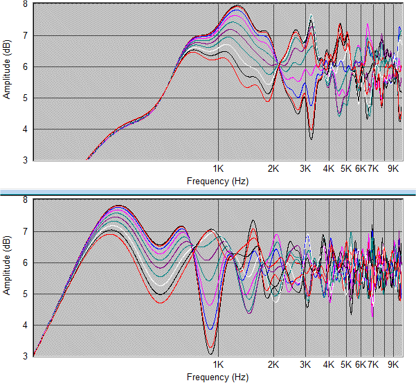

No, hence my question. A tall, thin rectangle with driver centally placed would probably be just as effective as a flower for any normal listening position.
It all tends to average, if you pick the right axis on which to listen.
(If I pull the image I referred to in post #11) Trace the average out of these angles and it's a lot more straight than the 0 degree shot suggests. Only if you listen on the axis that resembles that average, the tonal balance will be more consistent.
This is still not a cure for diffraction.
True. Following on from post #12, I'm thinking about the compromises of a driver on an open baffle in particular.
The magnitude of the variations from SL is surprisingly similar.
You might correct me if I go off track here as I'm just thinking out loud. Anyway, if there's a reason it needs to be listened to on axis, what about diffraction mitigation? Instead of just looking at the response.
There may be different ways to do this, I notice that SL went toward a narrow baffle in later times. Is it possible he was trying to reduce the diffraction delay, somewhat in line with the precedence effect?
