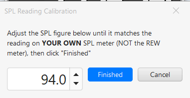

This is how I set my SPL levels in REW:
Click SPL meter:
Select SPL, Z, Slow:
Click Calibrate:
choose "Use an external signal"
Connect your (B&K) SPL calibrator to your connected microphone and play the test tone eg. 1000Hz, 94dB. Then hit OK:
Type SPL level of your test signal in the box, then click FINISHED:
Is this what you meant by SPL calibration with REW?

Yep, that's exactly the procedure I did, and the values are totally off.Type SPL level of your test signal in the box, then click FINISHED:
For me it's needed when I go back to data months later or when clients want to get data published.In practical terms, I think we all agree that actual SPL values are not important in loudspeaker design. But it is nice to be able to compare measurements, at least within a dB or so. But when taking distortion measurements it's absolutely critical to equalize and match the SPL of the fundamental...
I am talking about SPL calibration, not calibration files.Broken how? If you need individual inputs on the same device to have different calibrations make sure the option for that is selected:
That option applies to both.I am talking about SPL calibration, not calibration files.
Off how? Meaning the meter is not reading 94 dB after you click Finished while the calibrator is in place or something else?Yep, that's exactly the procedure I did, and the values are totally off.
What was your problem? I use the Class 1 precision SPL calibrator to calibrate REW SPL level, and I didn't notice any problems.Yep, that's exactly the procedure I did, and the values are totally off.
Off as in, done the calibration process, but levels from measurement don't line up with the actual SPLOff how? Meaning the meter is not reading 94 dB after you click Finished while the calibrator is in place or something else?
I used a SPL-meter, ARTA and another program to verify.

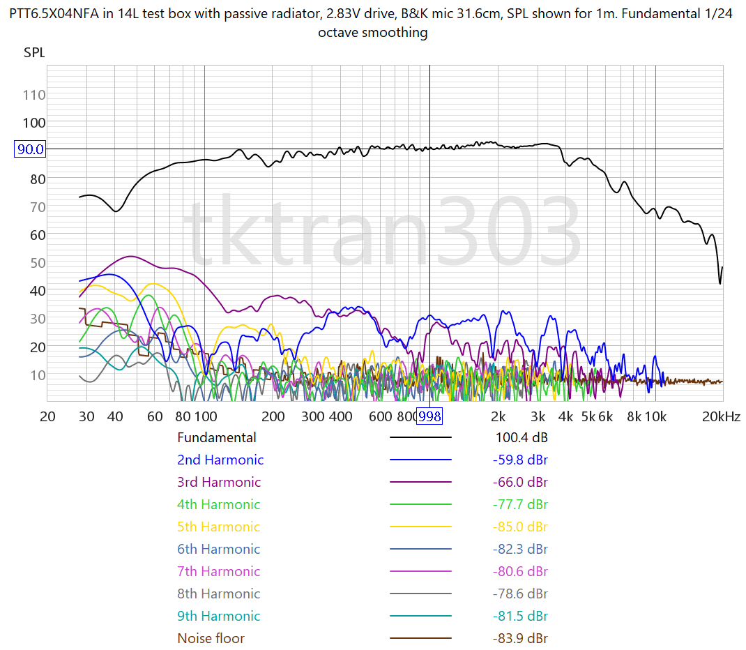

Let’s test the PTT6.5W04 again, using the 200V externally polarised microphone:
Some commentary is appropriate, I believe, to aid interpretation. Note the brown line which the noise floor of the environment.
Notice how the higher order harmonics are all bunched together- they all seem to around the same level.
Let’s see that again in terms of dB down, relative to the fundamental:
It appears the harmonic distortion noise floor is about - 80 to -90dB.
How does this compare to other measurements?

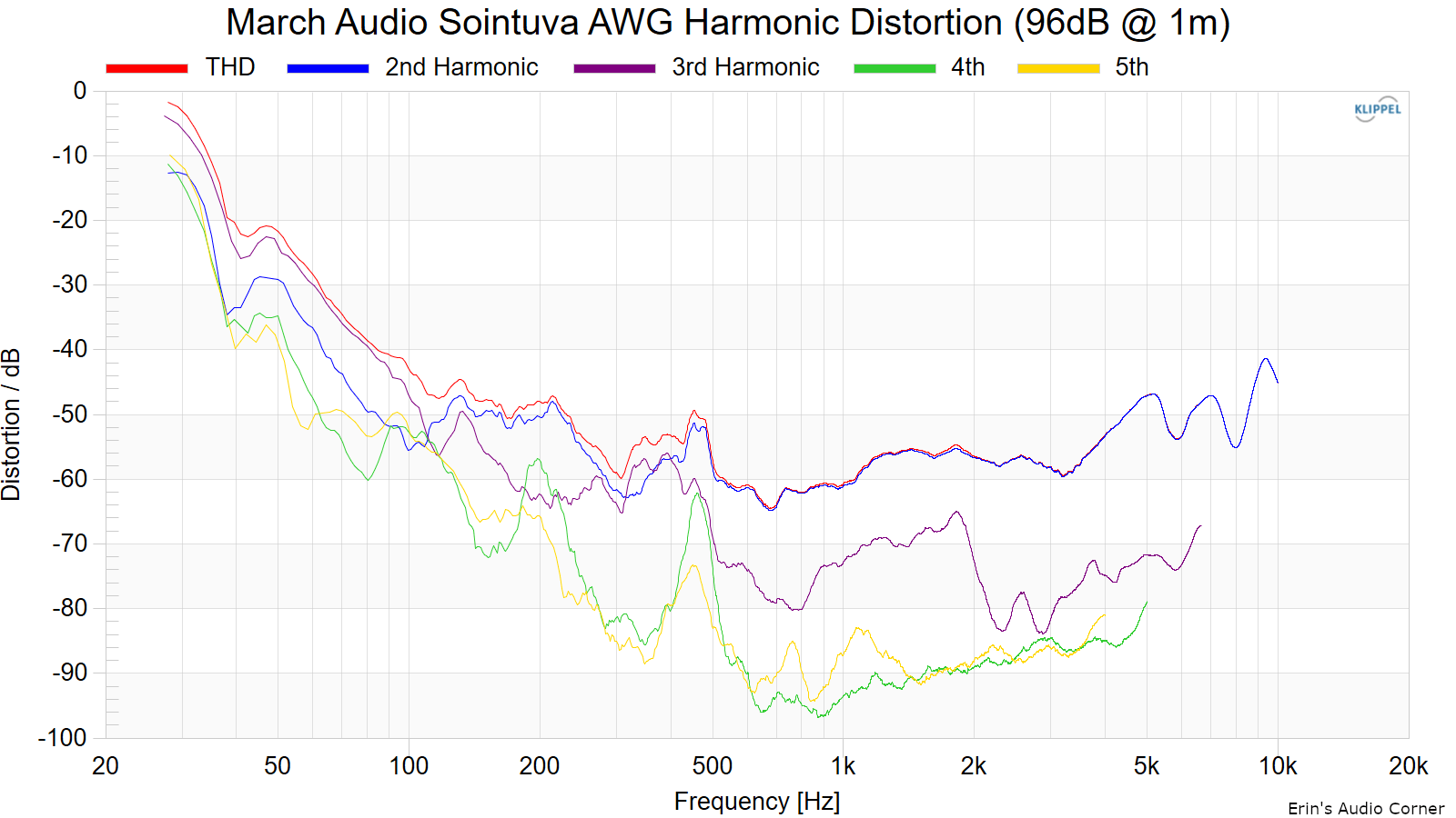

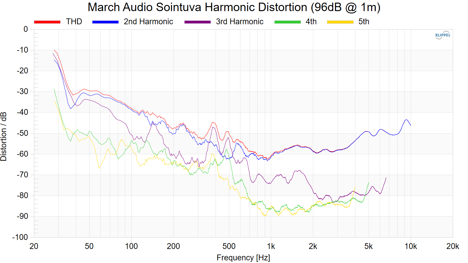

What about other speakers measured with the Klippel NFS. From fellow countryman Alan March:
https://marchaudio.com/product/sointuva-awg-stand-mount-speaker/
Reference:
https://www.erinsaudiocorner.com/loudspeakers/march_audio_sointuva/
Or the one with the aluminium cone PTT6.5NAA?
Reference:
https://www.erinsaudiocorner.com/loudspeakers/march_sointuva_awg/

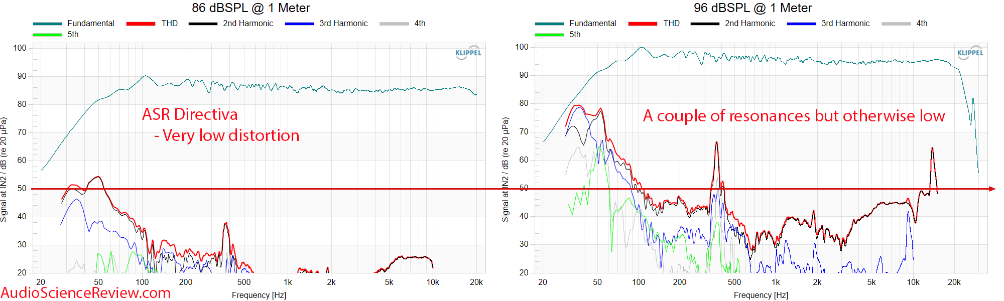

And finally one reviewed/measured at ASR, with the PTT6.5X mid woofer in a 1/4 cu foot cabinet and SB Acoustics 5x7” passive radiator:
Reference:
https://www.audiosciencereview.com/...r-directiva-open-source-speaker-review.27094/
Reference:

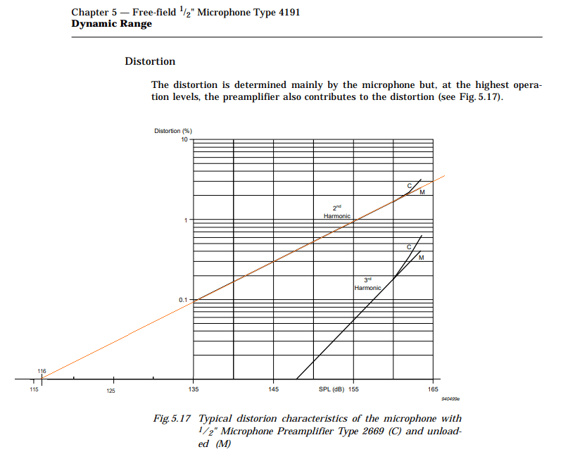

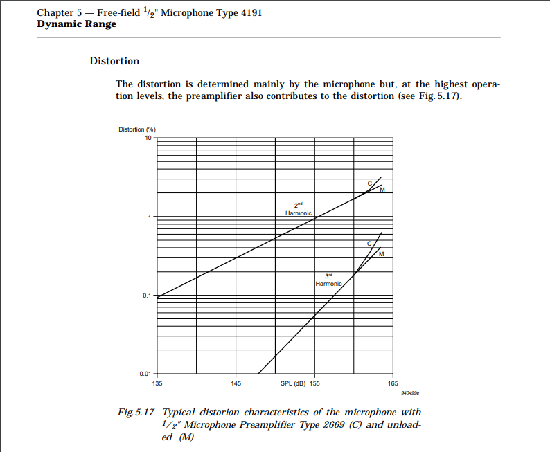

So what is going on here?
To understand we need to go back to the microphone- that is, the capsule and the pre-amplifier.
Let us extend this the 2nd harmonic distortion line to the left:
We see that the 0.01% (-80dB) distortion point is ~116dB for the 2nd harmonic.

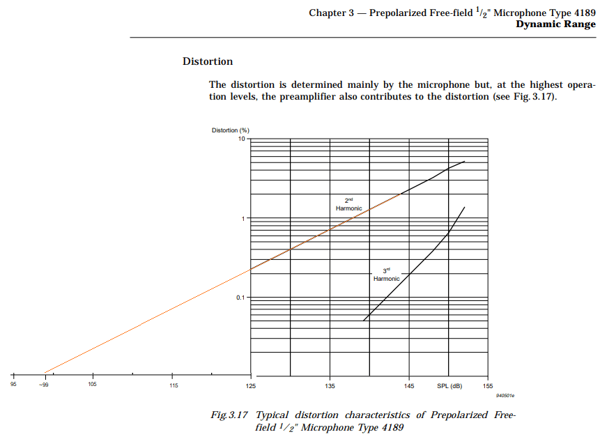

What about the 20KHz 1/2" microphone?
Here is the type 4189, "probably the world’s most popular ½-inch free‐field microphone"
Reference: Brief history of the B&K microphone
Reference:
Brüel & Kjær Microphone Handbook
https://www.bksv.com/media/doc/ba5105.pdf
TBC...
Adapted from:
Brüel & Kjær Microphone Handbook,
Figure 5.17, Chapter 5
Adapted from:
Fig 3.17, Chapter 3:
