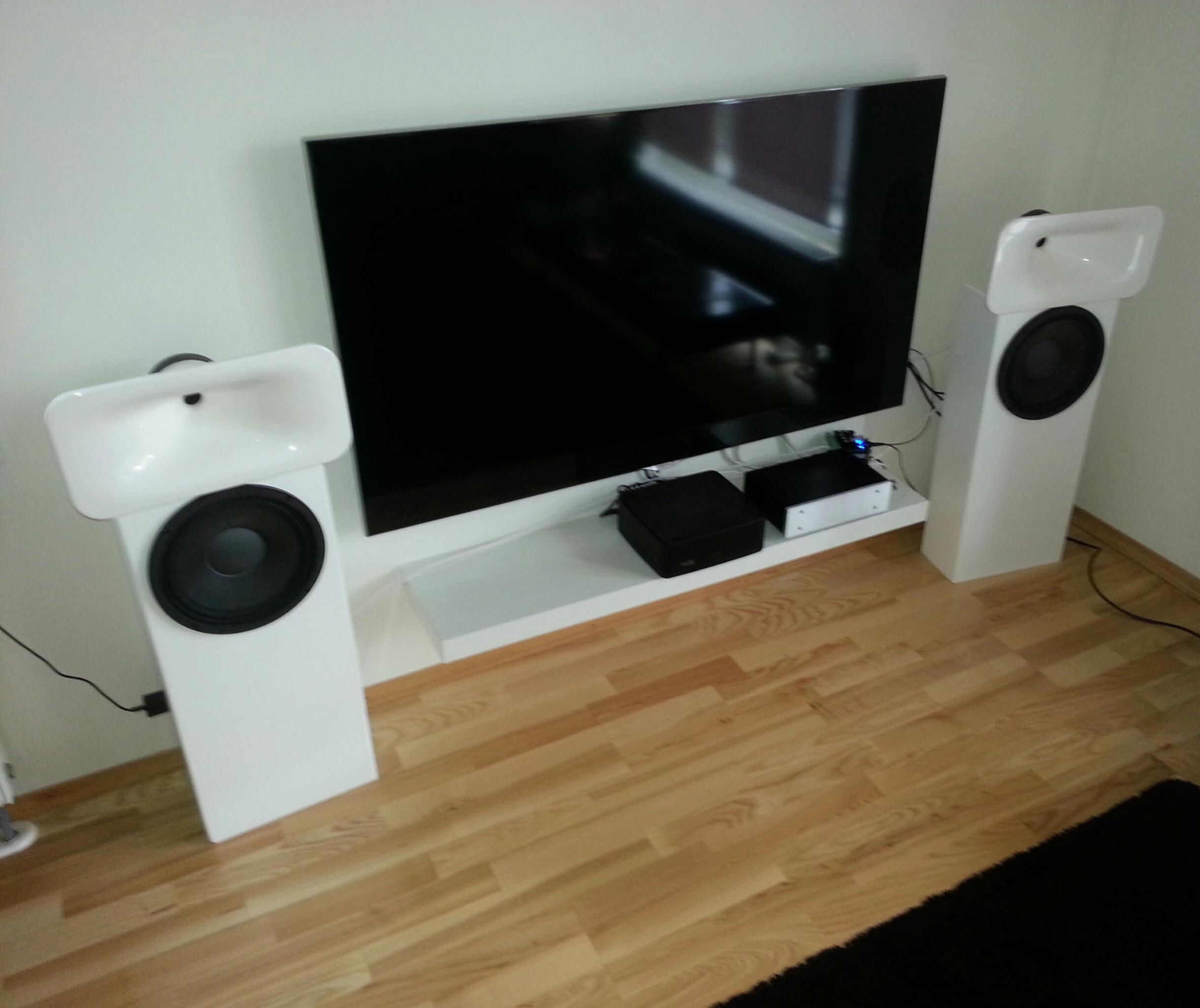

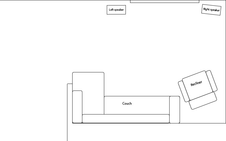

Hi!
I need to measure my speakers, and create a suitable crossover, as well as room correction etc. (everything is done digitaly through miniDSP).
But before doing so, I would love to get some input on which approach is best used for this purpose, when the speakers will be measured in-room.
How would you approach this issue?

Your room looks rather "naked" acoustically and the speakers are close to boundaries. Also the back wall will give lots of reflections! Room measurements will make you frustrated, I promise!

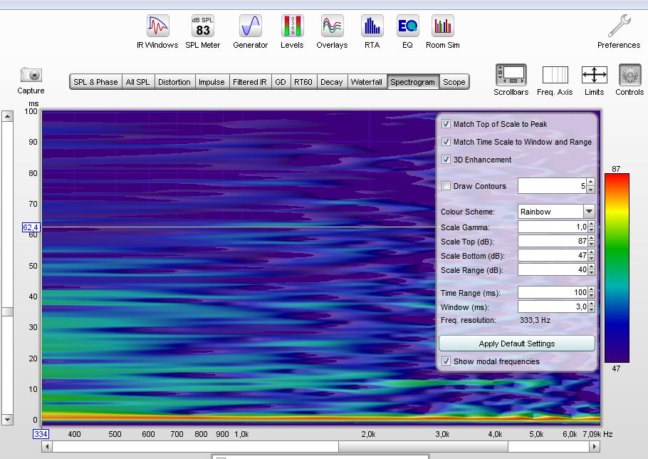

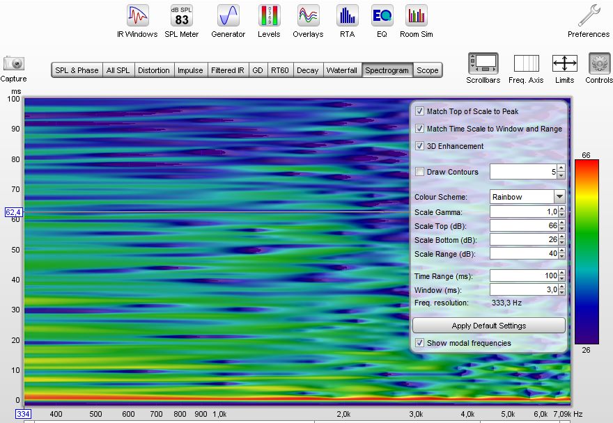

Holm and ARTA have more technical UI than REW, too much for me but fine for experienced users. The licenced ARTA is the tool to make directivity sonograms and eg. STI analysis. STEPS is sibling of ARTA and is a valuable tool too.
REW hs also decay spectrogram, it is very useful for seeing the room reflections at various frequencies, just set gating narrow.
