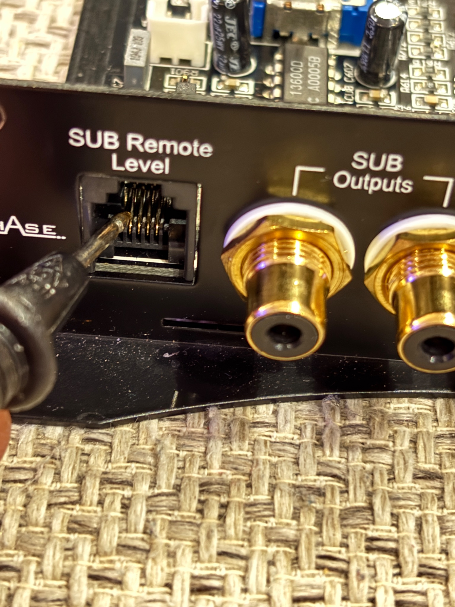

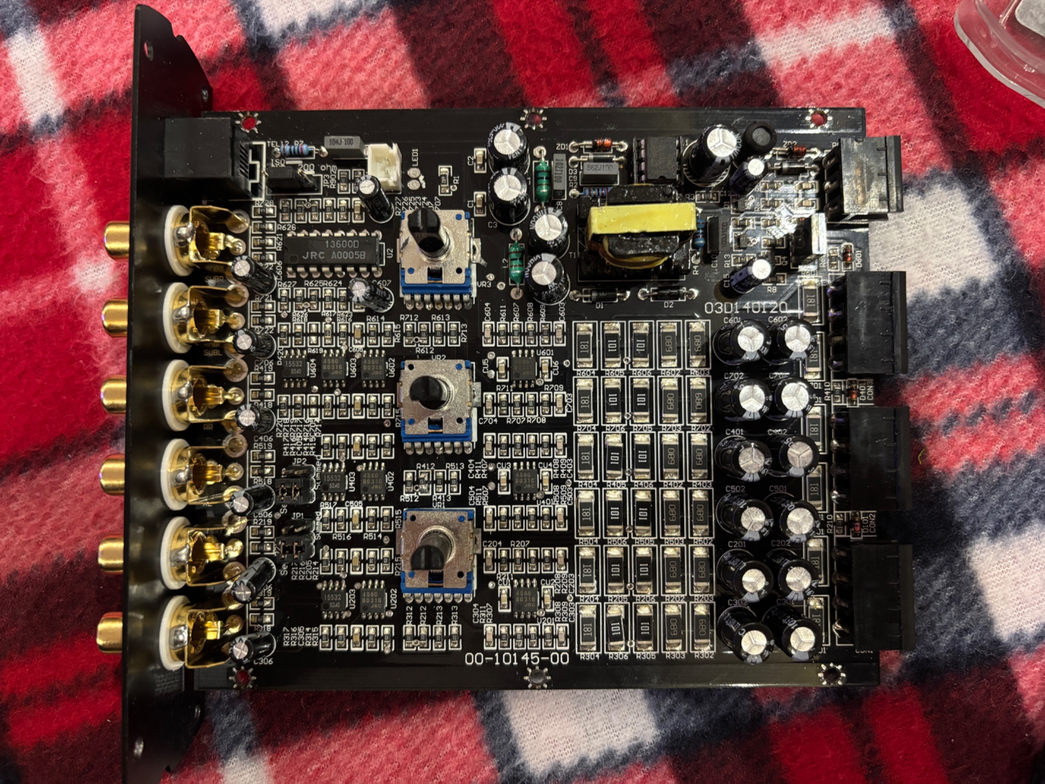

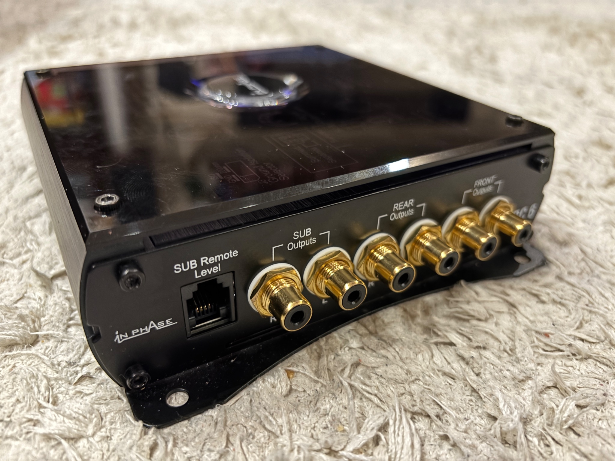

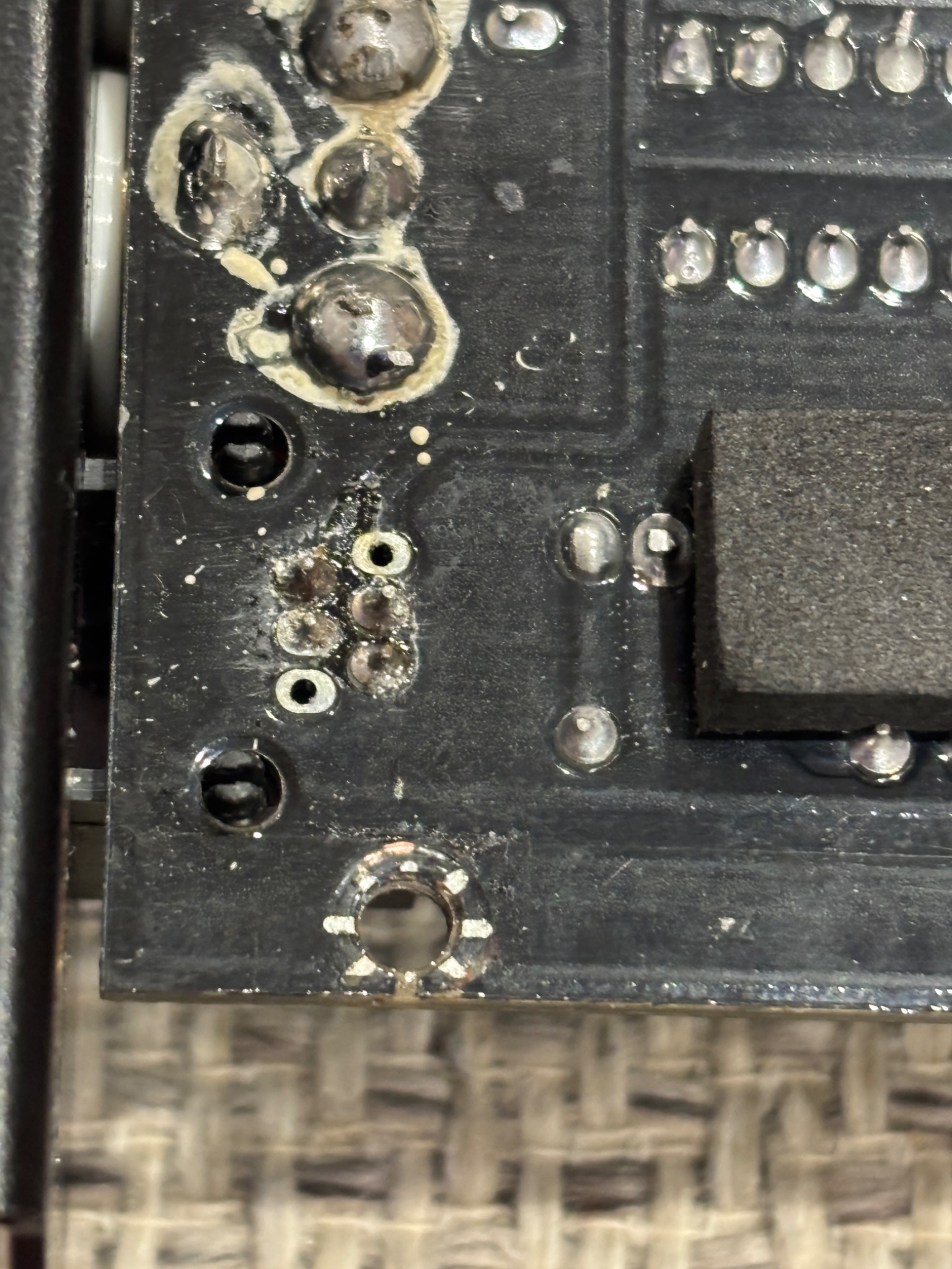

Hello all.
I have InPhase src6 high to low converter.
How can i make bass remote for this?
I can't find it for sale anywhere.

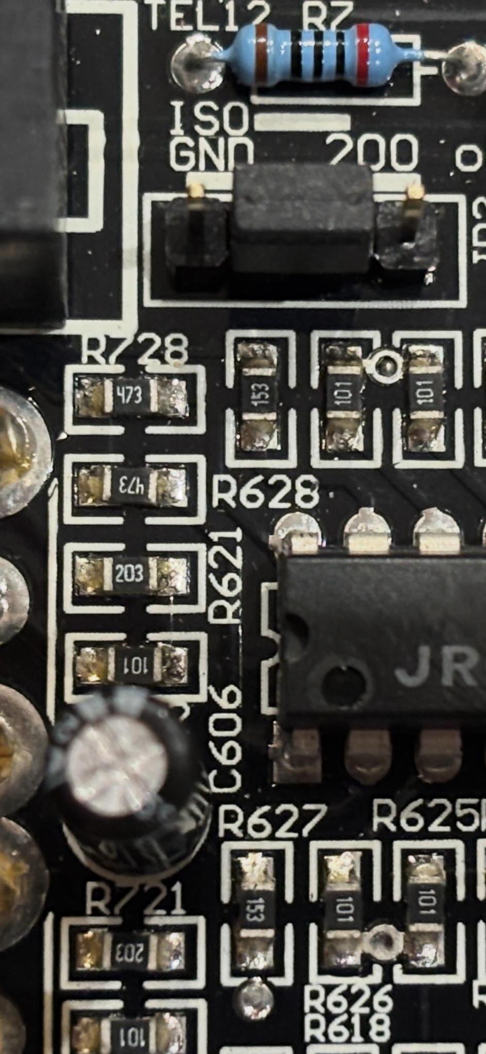

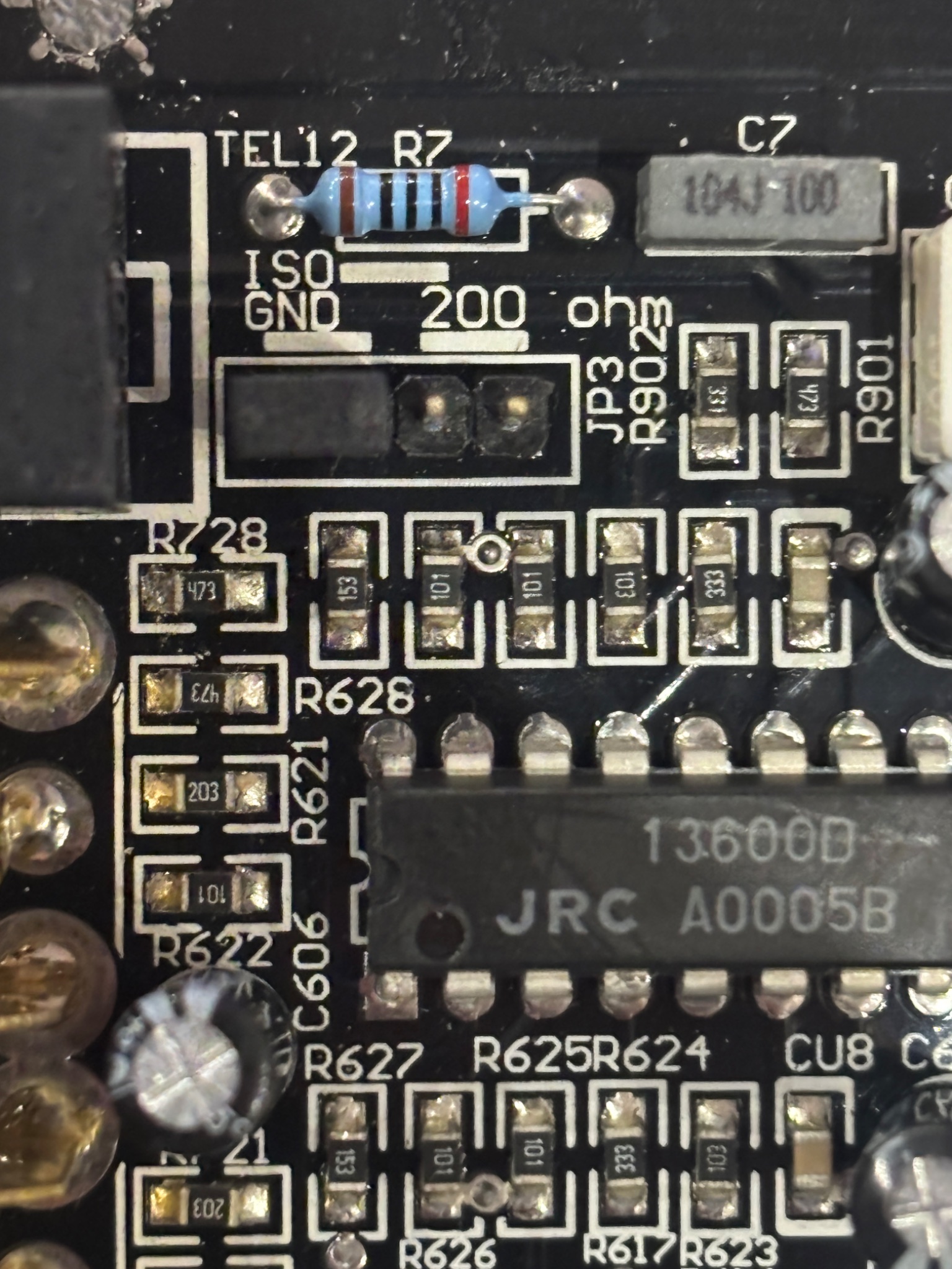

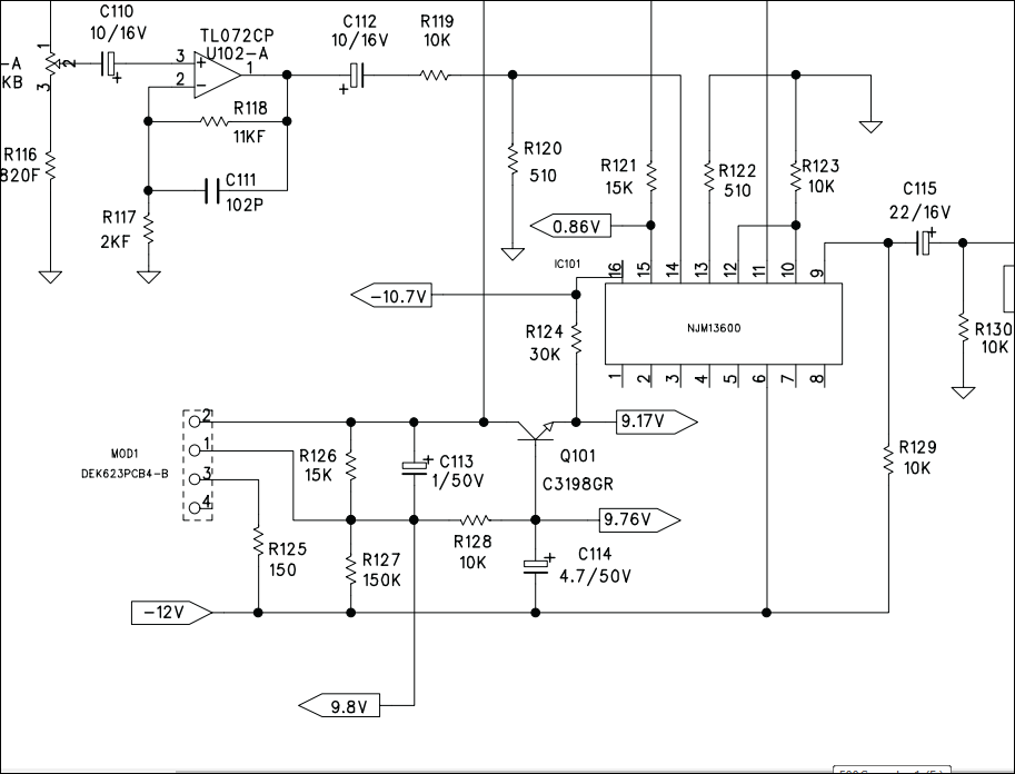

You'll have to determine the circuit components you have. The attached is a generic circuit. The output of the 13600 is determined by the current driven into pin 1 and/or 16 (only one is used for mono applications). I don't see any transistors on your board. They could be external or not used. You will need to vary the voltage feeding the base of the transistor in the diagram. When higher voltage is driving the input resistor (R124 in the diagram), the output is greater. When less voltage is driven into that resistor the output is reduced.

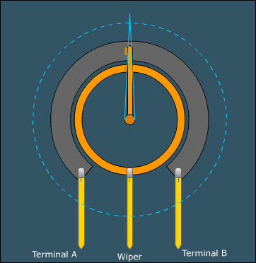

I don't know what's unclear. For the attached pot, positive 14v (connected directly [0 ohms] to pin 11 of the 13600) to terminal A on the pot.
Same for pin 6 of the 13600 to terminal B.
The wiper would go to the two resistors driving pins 1 and 16.
You want the positive terminal of the pot shorted (0 ohms) to the wiper when the pot is clockwise.
