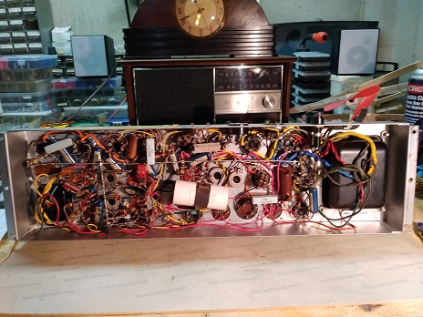

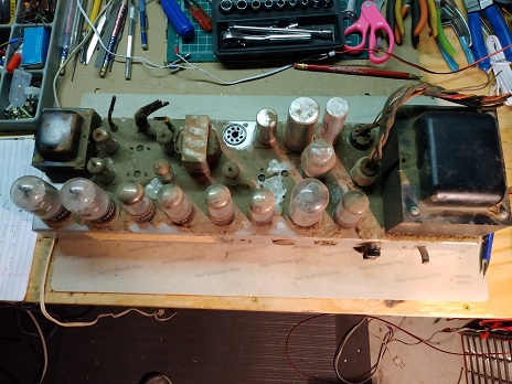

I am looking for schematic for a Conn Ltd. organ amplifier, chassis # 59092. The chassis was donate to me, covered in dust, but looks in good shape. I'd like to either refurbish it, or rebuild it to become a power amp. Any suggestions where to look?
The amp looks like this: (see attached 2 photos)

That's a lot more than "an amp". It is 2 (or 3?) power amps, main and tremolo and? Be a funny kind of stereo. Seems complete over-kill for guitar.

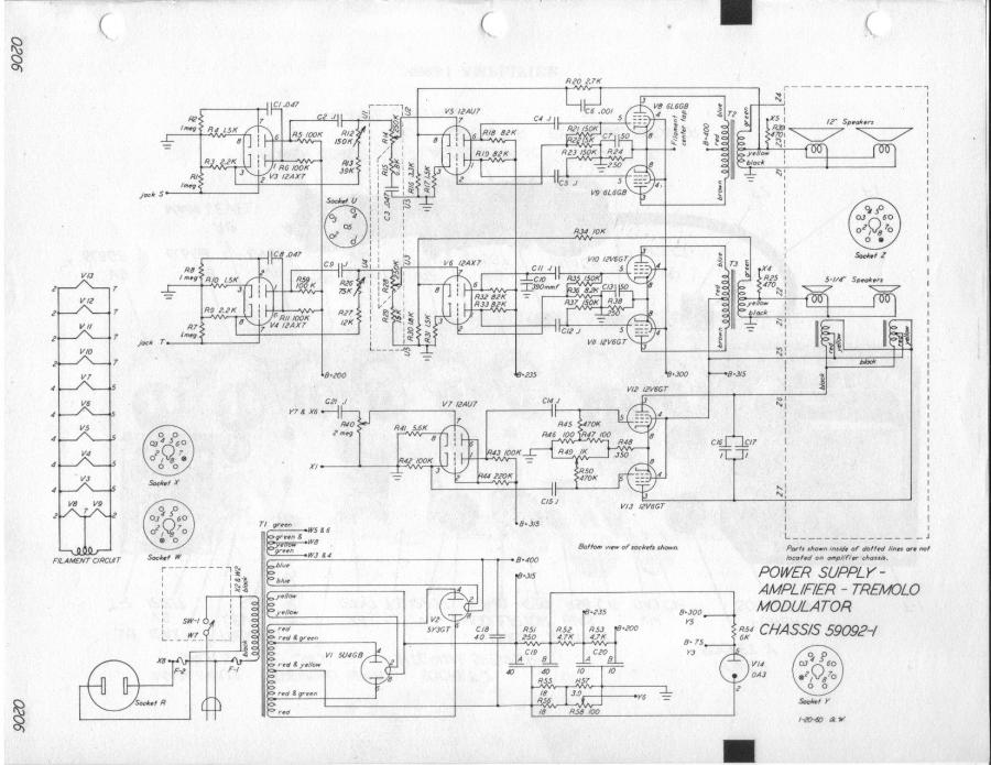

Edit: yes, a main amp 2*6L6, another amp 2*6V6 (but 12V types), and...... a low-frequency amp which *modulates the field coils of the field-coil speaker* (which is probably long gone). If you could *fit* another OT on there, you "could" have Left and Right satellites at 10 Watt, plus a 25 Watts sub-woof channel. Plus a LOT of tarnish to clean.
