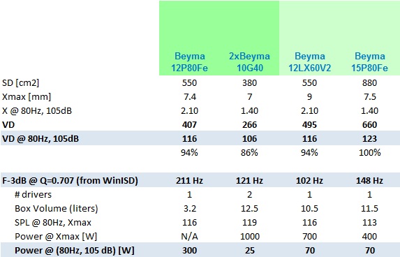

I'm going through the driver selection for 80 to 400 Hz in a 4-way active system. My goal is to achieve top dynamics and texture/detail. My listening levels typically are 85dB C-weighted, and sometimes 90dB.
I realize size of the driver matters. But driver size seems to tell part of the story. Example with Beyma drivers: 10G40, 12P80Fe, 12LX60V2, 15P80Fe. Please see the attachment.
Twin 10G40 have more Sd than the 12" drivers, but if I look at driver displacement at 80Hz and 105dB, the Vd of either 12"-driver is higher than that of the twin 10G40. The 15P80Fe has higher Sd and Vd than the other options. A 15" midbass seems like overkill, though, in light of my 12" subwoofers...
I'm probably overthinking this! 😱

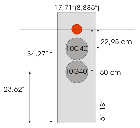

Of course a single 12" driver has to travel more of Xmax to output 105dB,
than 2 10" drivers in parallel. The Vd calculation of 10G40 is correct for one
driver ( 380cm^2*0,7cm=266cm^3). Try to simulate the response of a driver
in the box crossed over to other units of the 4 way speaker.

Hey Lojzek! I've been going through the links you provided to resources in a previous post of mine. I'm likely to come back with more questions 😀 but first I want to do my homework.
You are right: the Vd calculation for the two 10G40 is wrong. But I'm not really using that one, but rather the "Vd @ 80Hz, 105dB" and I believe that one is correct for the 1 vs 2 10G40.
I'm looking into simulating the response to the other units in the speaker. I'm working with Bagby's Woofer Box Model now as it has "textbook" hi/lo pass filters built in. UniBox requires me to input the electrical values which I don't know.
Nevertheless, how will doing this help me in deciding between these woofers?

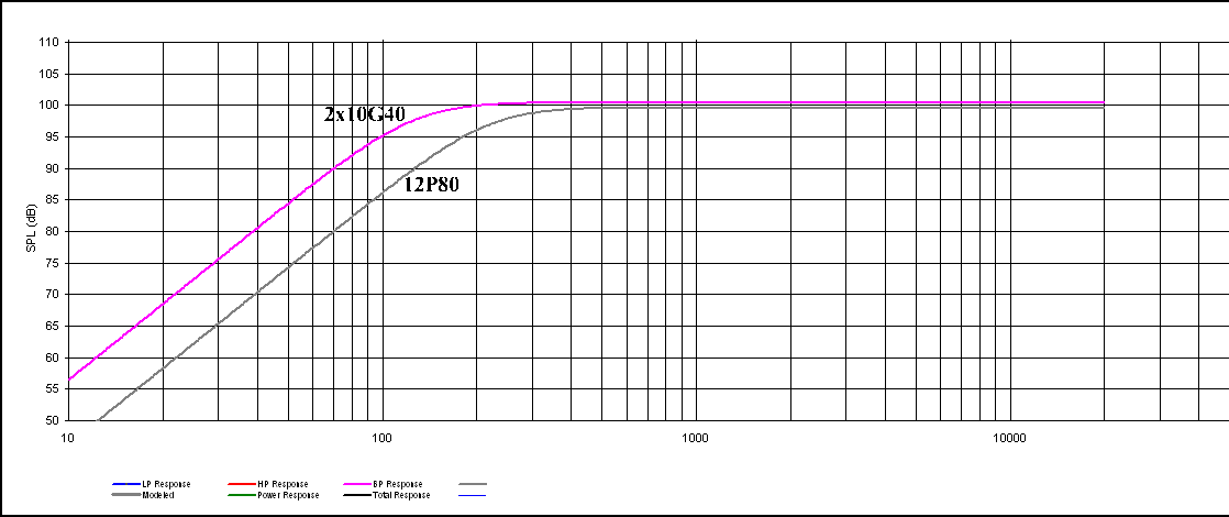

Howdy Lewinski,
That one is correct, 380*2*0,14=106,4

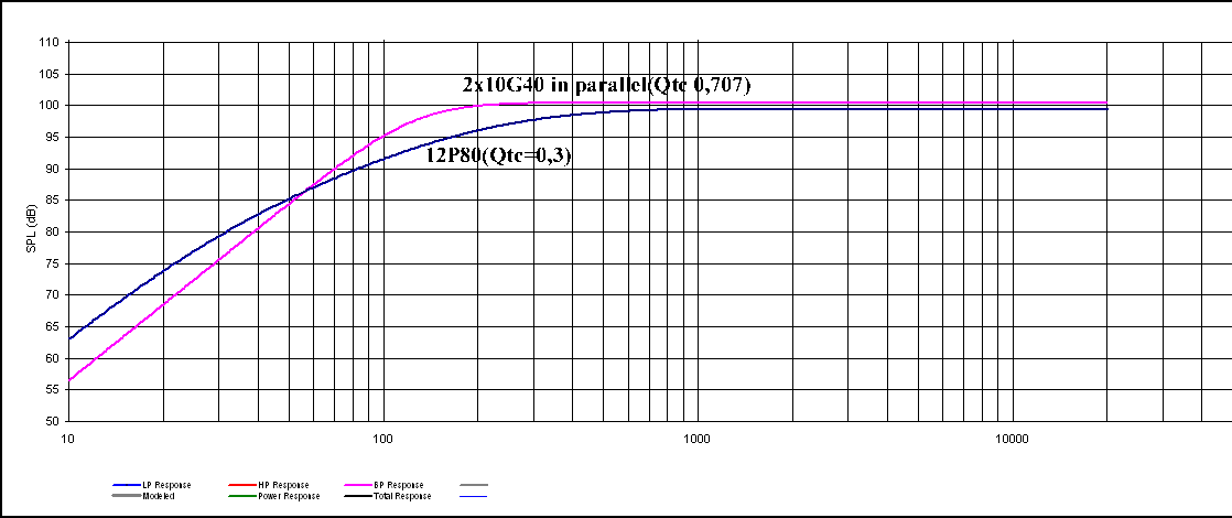

The first graph depicts two boxes with the same Qtc od 0,707.
10 dB of difference at 80Hz for the same input voltage. The second
graph is when you change the Qtc of a single 12P80 to 0,3.
post16 shows me that the Butterworth roll-off is @ ~120Hz
That requires that the Bass only speaker should also roll off at the same 120Hz.
80Hz is the wrong frequency for the bass only.

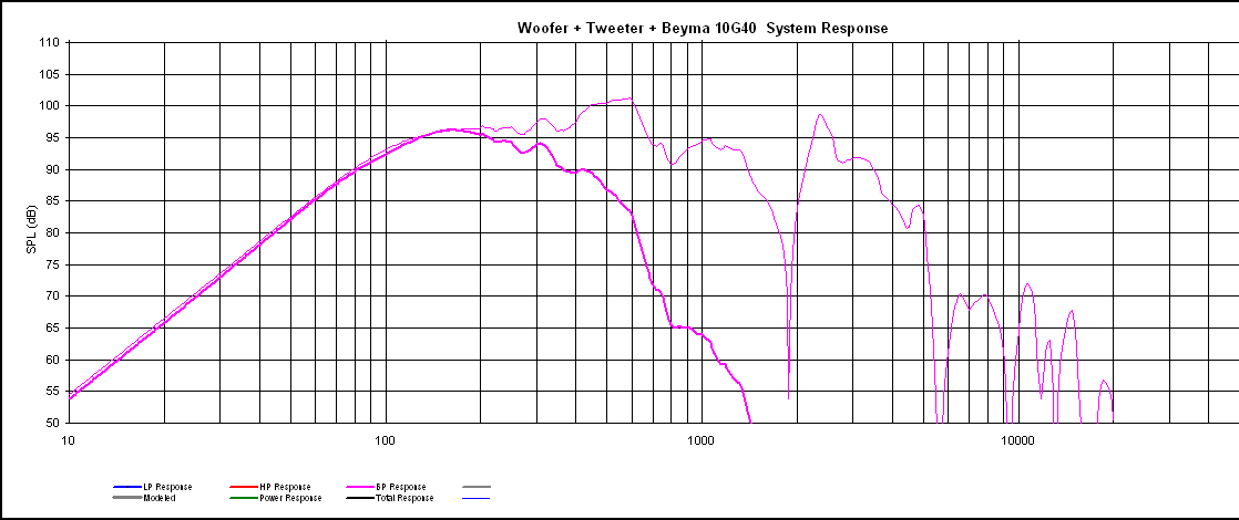

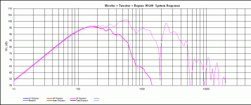

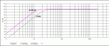

Hey Lewinski,
this is one way of deriving a point of view for comparison purposes.
The simulation is based on the baffle dimensions as shown, cabinet
volume of 12,5 litres for each unit ( parallel) with Qtc of 0,7. The
passive parts section you won't need. Try to do the same for the other
configuration types. Woofer roll-off is simulated and pasted to
manufacturer's measurement with the addition of baffle diffraction.
Mind you, there is no HP filter.

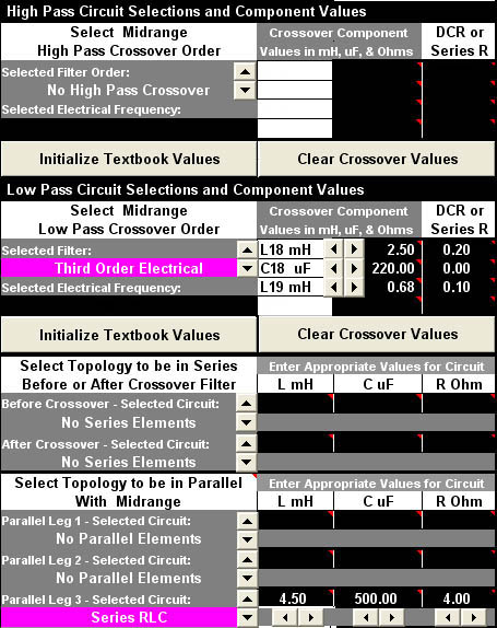

I guess by "Butterworth roll-off" you mean F-3dB when used in a box with Qtc=0.707, right? If so, sure, I included that info on my initial table and indeed the two 10G40 have an F3 of 121Hz vs 12P80Fe of 211Hz, 12LX60V2 of 102Hz, and 15P80Fe of 148Hz. I've included the table again for user friendliness. From this point of view the 12LX60V2 looks better, but this one looks more like a subwoofer driver and I'm afraid it might be too "slow" going up to 400Hz.
I can't cross my subwoofers at 120Hz; maybe I could go up to 90hz, but no further.
Hey Lewinski,
Thank you for doing that! What simulator are you using? Looks like Bagby's aesthethics, but it's not the Diffraction nor the Woofer Model simulators - I don't think.
Will study this and come back.
BTW, simulating baffle step, boundaey reinforcement, etc with Bagby's model showed that using two drivers (2x10G40) allowed for placement alternatives that minimized losses at least better than having just one such driver.
- In midbass size matters. But which size matters?
