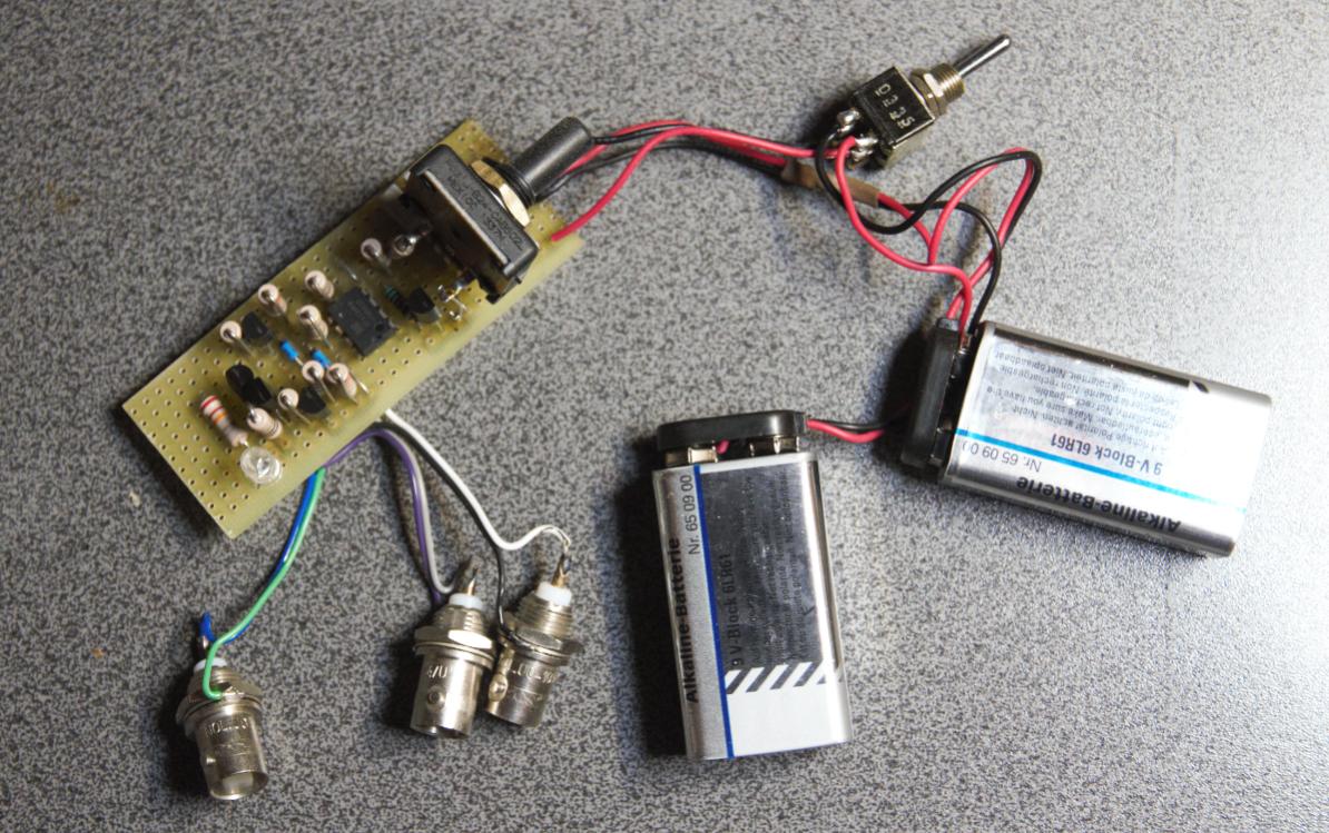

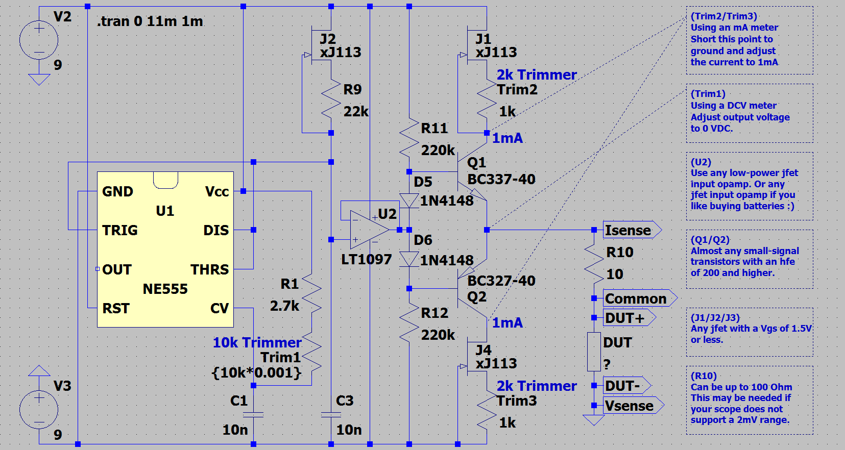

In-Circuit General-Purpose Curve-Tracer
This is an small/simple tool to do in-circuit curve tracing. The tool injects voltages up to +/- 5V and currents up to +/- 1V into the DUT (or circuit under test) and draws a curve on a x-y scope (any scope with an x-y setting). The injected voltages and current should be safe with most/any circuit.
The tester can be used to compare two circuits (one working and one that lost some of it's smoke), differences between the two circuits are visible through different traces that are displayed. This I.G.C. tester can very quickly pinpoint components or circuit parts where faults may be located. No need to de-solder any component :)

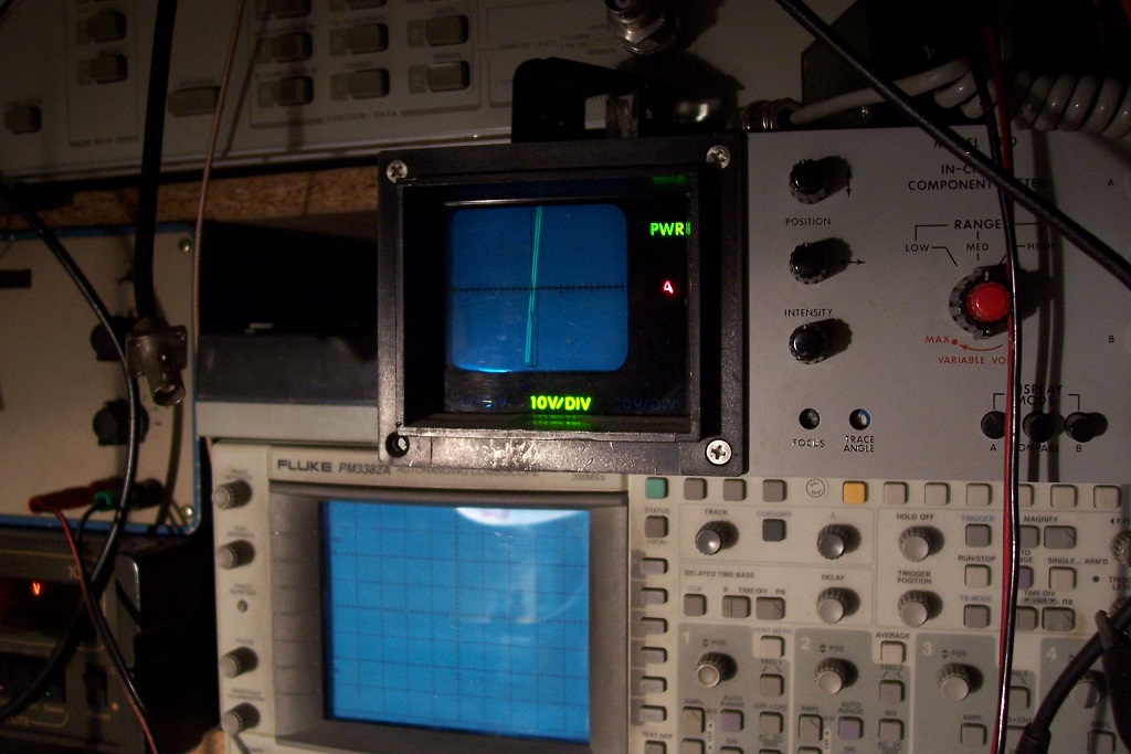

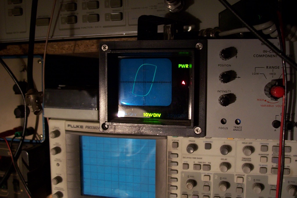

Here is an illustration of the example I gave: the first pic displays the normal behavior of a mains transformer's primary and the second is the same, but with a winding shorted. Pretty obvious, even to the untrained eyes, but a simple ohmmeter test doesn't provide even the beginning of a clue.
Lesson to be learned: do not dismiss too lightly what you are unfamiliar with, or don't understand....
