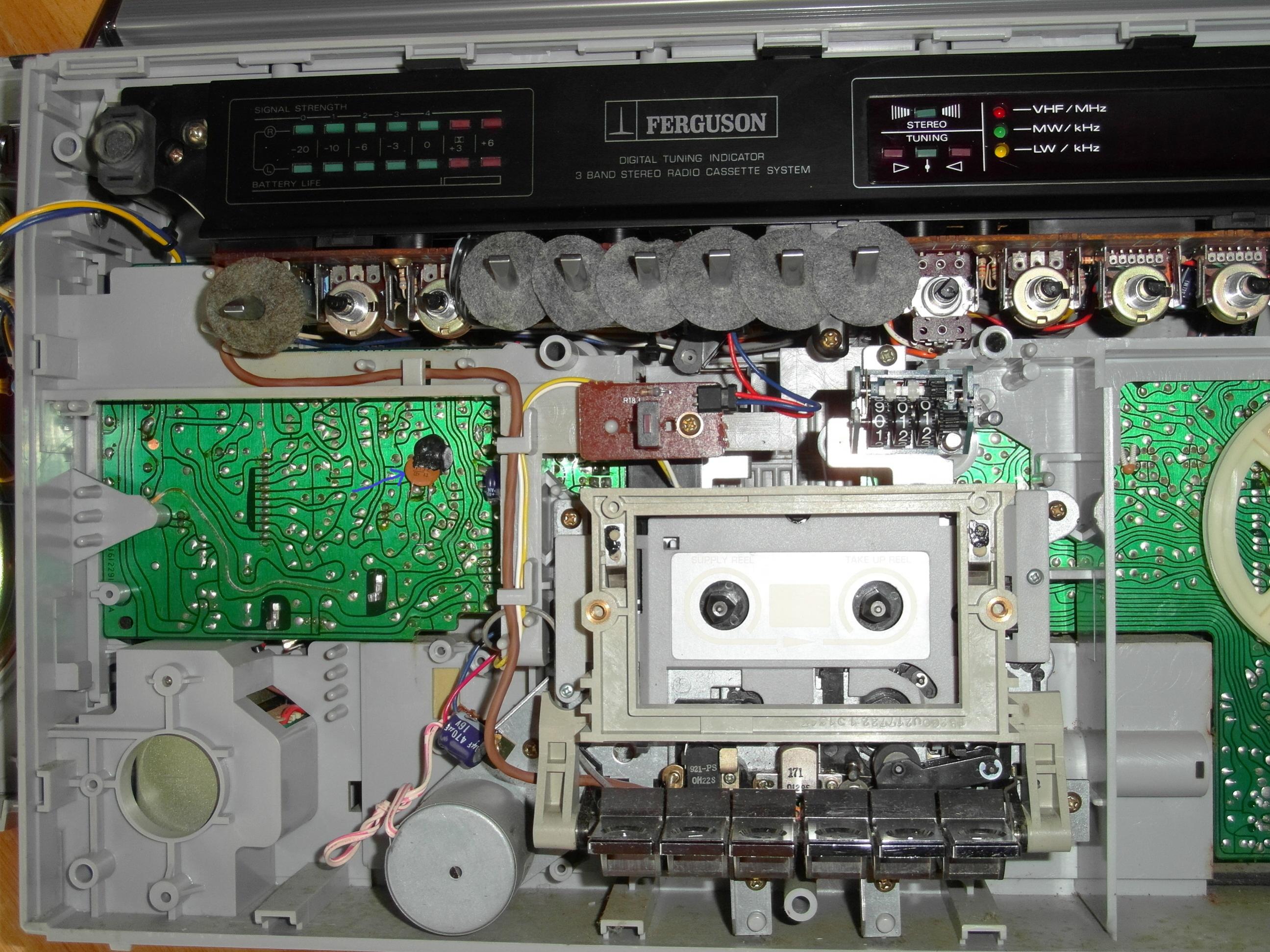

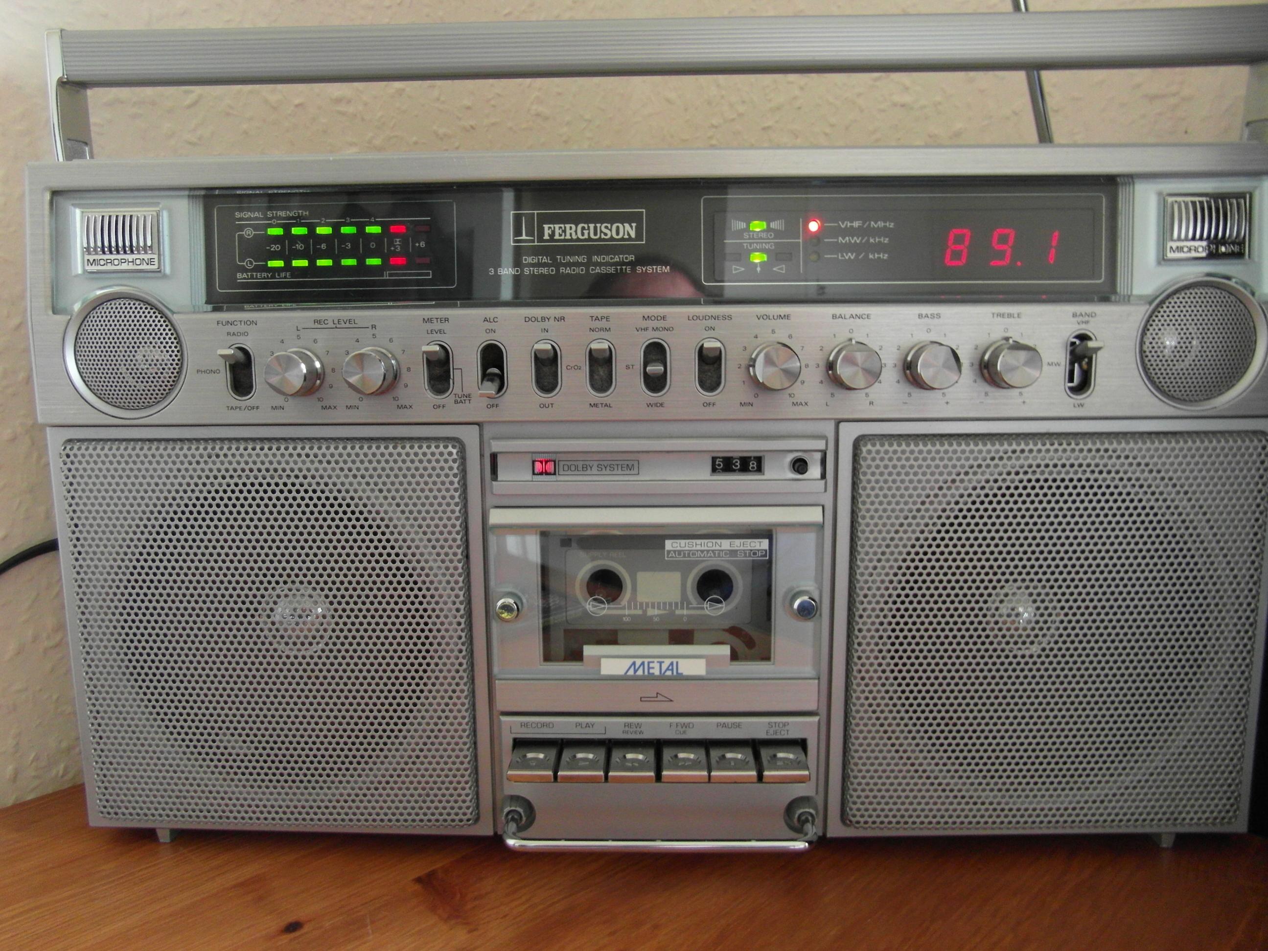

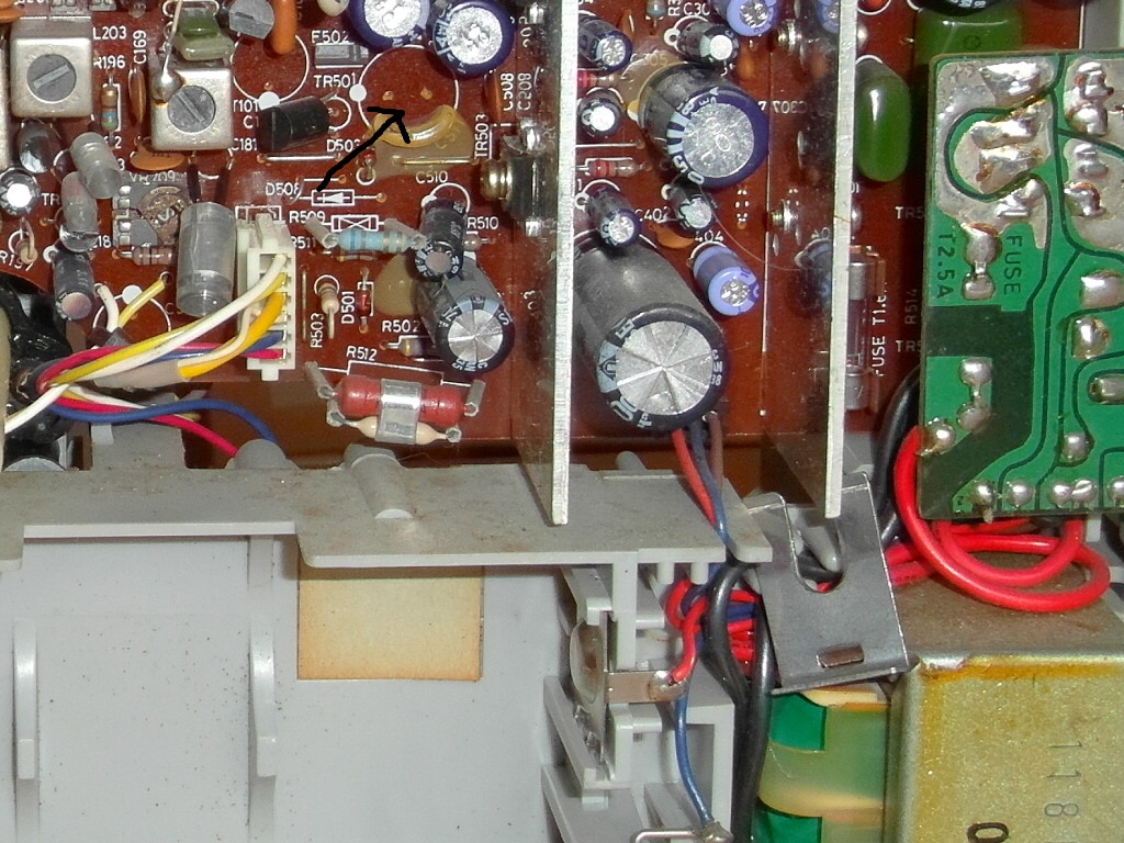

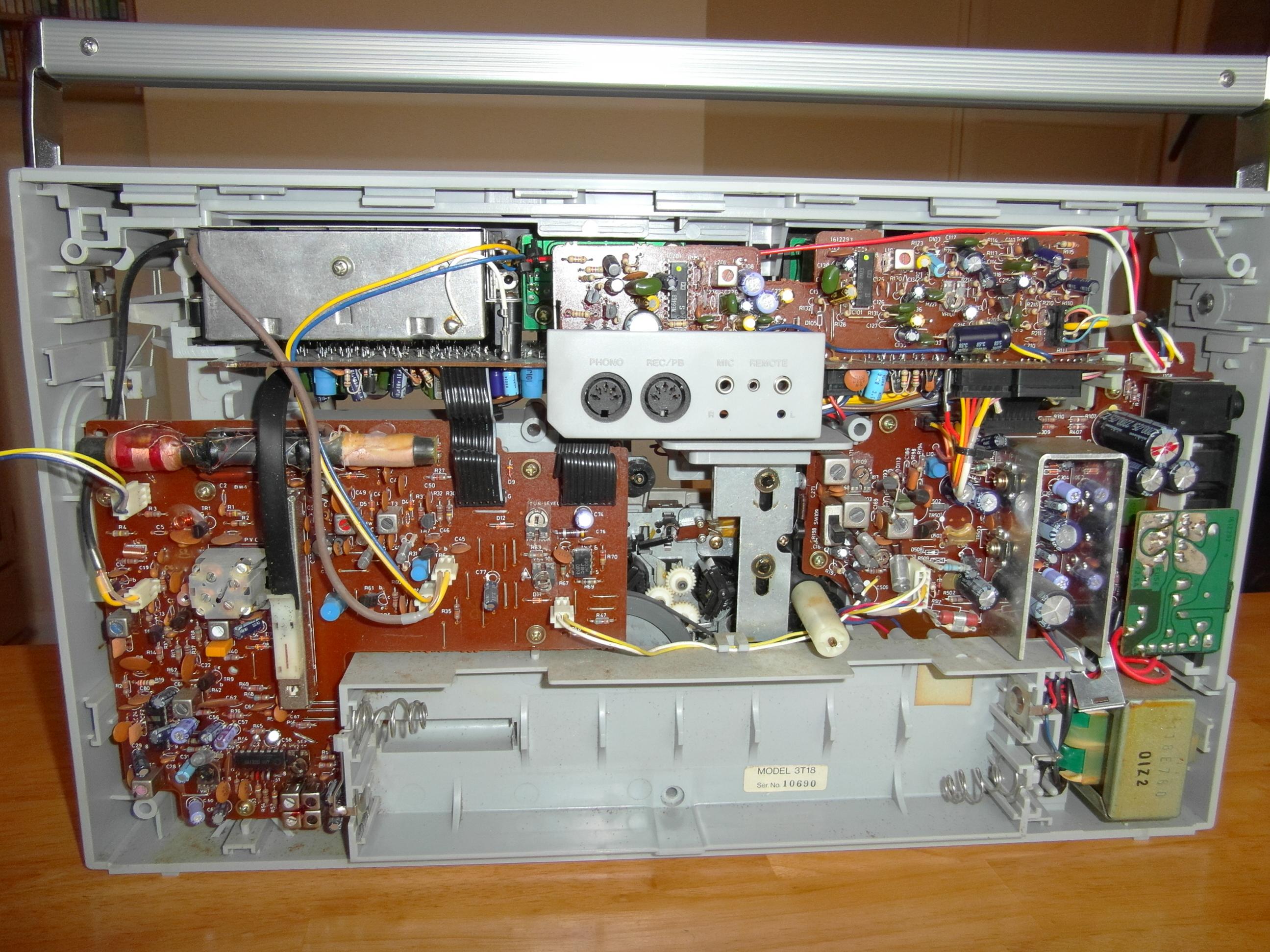

Ferguson 3T18 boombox stopped working?
Hi, I have a 1980's boombox that suddenly stopped working. My partner was listening to it at the time, apparently it made a very loud buzzing noise for about a second then nothing. Now when I switch it on the speakers make the usual popping sound as it powers up and the lights still work and the tape still goes round RR, FF etc... So I suspect the problem is on the audio board? I bought this boombox as spares or repair on Ebay a few years ago and it was displaying all the same symptoms as it is now that it is not working again ( I had it professionally repaired at the time but the guy who fixed it unfortunately no longer does repairs 🙁 ) . I don't know what he did but one thing I do know he did was replace the ceramic capacitor (picture with blue arrow with an electrolytic capacitor (picture with black arrow)), is it likely that this capacitor has failed again due to a weakness in the circuit or is it likely something else (I was told on another thread where I mentioned about this boombox (under equipment & tools section In circuit capacitor testers advice please. ) that the amplifier chip may have fried. Any ideas?

Check the voltage regulators.
I am only a novice and not sure how to do this but the boombox has a 12v DC input and I tried running from a 12v DC power supply just in case the problem was caused by the inbuilt 240v power supply unit. The symptoms are the same with the 12v supply minus the mains hum.
Hi soul music,
It does sound like you have a power supply problem. However, if t was being played loud at the time, a blown output chip is equally likely.
