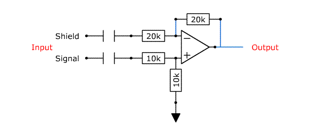

So I've done some DIY electronics stuff before, but usually stay closer to software. I've built a CMOY (but that hardly counts) and I've done some stepper motor stuff, but never a serious audio project. I'm interested in building an in-car mixer.
Basically I have a line in jack to my car, which is currently just hooked up to either an XM receiver or my MP3 player through an RCA connection (with a GLI to keep the buzzing out of the XM's signal). But now I'm looking at getting a GPS receiver, which also has a line out. I'd like to be able to have it hooked up along with the XM/MP3 player. So at first I was thinking just a two-input mixer, nothing crazy. But the MP3 player can have trouble with the car speakers, so maybe I'd add a post-mix amp, too. And then, well, why not add a toggle to choose between a few inputs. So the final idea is:
Two-channel stereo mixer. One channel is always from GPS. The other toggles between three inputs. Amplify it post-mixing. All powered through a cigarette adapter (ugh). I've got 15A combined power through those, so I'm thinking that should be enough to power the mixer, the XM radio and the GPS.

You can use a couple of op amps to do the trick.
The inverted input of the op amp will be at virtual ground, so you just parallel the input signals with a series resistor per input.
Gain is adjustable, so if you need a little extra output from one signal, that can be covered with resistor values.
Rather than switching inputs out of circuit, you can use you switch to mute the signal from the unwanted device.
15A is a lot to draw through the lighter constantly. If you're going to this effort, grabbing an accessory lead behind the dash will be a simple effort.

What I’m talking about is using op amps (IC’s in small DIP’s) to make an inverting voltage follower. They have two inputs, one inverts the signal 180 deg, one keeps phase intact.
The inverting input can be used as a summing node. Because it presents a very low input impedance to the source, current from an incoming signal will flow only towards the input, and not back into another device that may be connected to the same input. As a result, signals into this input are mixed.
The output from the op amp can be inverted back to 0 deg by another inverting follower if you’re one who’s concerned with absolute phase.
Gain can be adjusted by a resistor or two in the circuit, and modern op amps can pass output signals that swing pretty much to rail voltage.
This would be a fairly simple and inexpensive circuit, but would need to be built well enough to hold up to vibration.

To avoid noise from ground loops and so you don't need ground loop isolators, you should use noise cancelling input circuits for each of the sources. Something like the attached circuit will work.
When prototyping the mixer, you should build the first one on a breadboard (the type with spring-loaded contacts). This will allow you to test the circuit and make quick revisions.
Have you decided whether you'll use a split supply (positive and negative voltage) or one with a virtual ground (reference voltage at 1/2 of the supply voltage)?
