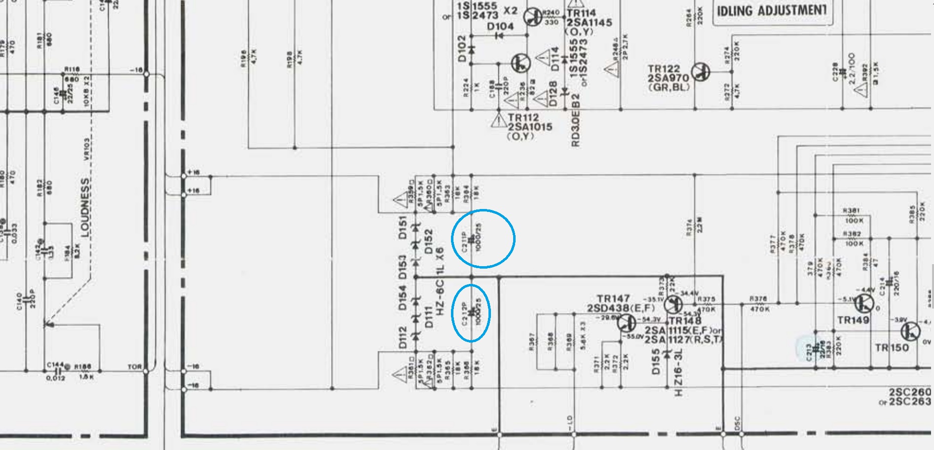

I want to make some mods to this A700 amp .
Regarding the 2 x 1000uf caps posted in the photo .
Those should be the 16v filtering rails for the pre right ?.
I was thinking to increase the UF to 2000uf for that location .
This will be safe for all components ?.

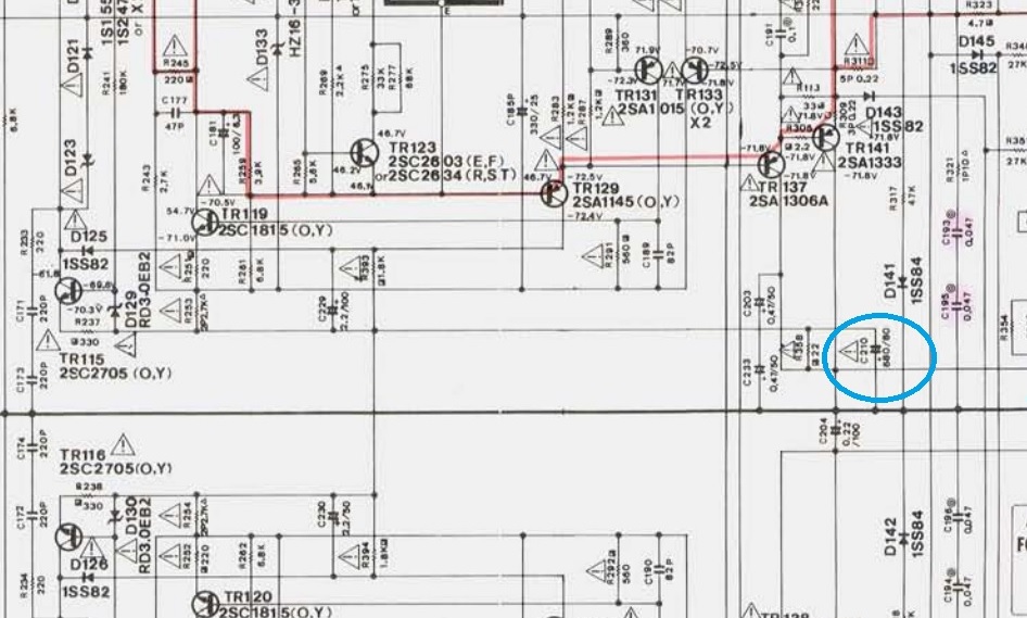

Also what about the 680uf 80V ones from the other photo .
It is safe to increase those to 1000uf ?

I agree, do not arbitrarily change values, it might make no difference at all and as said above could risk damage.
Once you change one ecap, then logically they all should be changed if the thinking is that they are out of spec, so need changing.
If you know of specific parts that fail prematurely then by all rights change out the weak links.

I would probably make the same cap changes as posted and
replace/increase the main filter caps. As pointed out, I
wouldn't expect any significant improvement in SQ from the
regulated supply.

Upsizing C211P/212P seems uncritical. It only affects resistor dropper loading on powerup, and since that is not a great deal different from idle to begin with, I don't see any major issues. I would note down their diameter and then look up what the highest capacity is that you can get in a 35 V rating from a good-quality, lowish ESR cap series (e.g. Panasonic FC). If that happens to be a 2200 µF, go with it.
C210 is a 680µ/80V part... it's not trivial to find a replacement for that, let alone an upgrade. From the Panasonic stable, I would probably use the FC 680µF/100V part, as while they have some other series with 1000µ/100V parts, their ESR appears to be a factor of 2 or 3 higher if you do the math. They're making an FS series 680µ/80V with even lower ESR, but that seems a bit tight.
I would always go up in voltage rating with modern caps - they have become so much smaller mainly because of tighter process control resulting in far fewer defects in the oxide layer. Back in the olden days they would basically oversize the voltage rating considerably, until the rate of rejects was acceptable. This also means, however, that a good sample of an old cap may have sustained substantially more than its rated voltage (even up to 2-3 times as much). With modern parts, cherrypicking will be met with much less success, as the probability distribution will peak more sharply at a narrower voltage.
