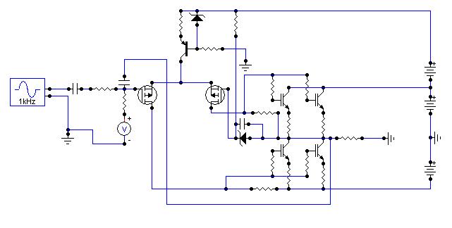

This output stage is a follower, so the gain is near 1 and the output impedance is low.

it is amazing
the whole picture which you post above is a follower, isn't it. just like
common drain circuit (emmiter follower) .
so if i want to build a amplifier with this circuit, i must add input and VAS circuit. is what i think correct?
and another question. i only have irfp240 , so how should i do this circuit beacause of zvp3310 bias problem. i can not connect gate of zvp3310 to output directly. give me detailed resolution, pls.

Yes, that is correct.
You can not use this particular circuit with irfp240 - only Logic Level N-ch MOSFETs will work (i.e. IRL540 or 2SK1530 etc.). For IRFP240 you would need to change the arrangement to include an additional bias for P-ch device. I did not try it so I can not offer you a ready circuit for that. It should be possible, thought. One more thing about using IRFP240 - you'll lose much more voltage out of the supply rails , the current source would need a boosted (by 5-10V) separate supply and the temperature compensation needs to be be different.
Overall - it is not easy to replace the o/p devices here for "non LL", sorry. Look for IRL540 - they are quite common and cheap - and good for up to about 50W output per pair.

accomplishing several things in one blow sometimes mean compromising. The task of a phase splitting stage is to generate two balanced differential signals, most importantly, being accurately 180° out of phase and equal in amplitude. The gate-source and gate-drain properties are not equal. To noticeably linearize the output devices, the CFP could be a way to go.
Klaus,
that`s a nice circuit in post #18, when M5/M6 JFET, M3/M4 bipolar.
Klaus,
I am happy to invite forum members to have a look at my short article:
http://www.ant-audio.co.uk/Theory/N-channel D-MOSFET output stage with improved linearity.pdf
In this thread I will try to answer questions about that circuit configuration and also about the last diagram from the article - a practical example of an output stage that can be used with or without an overall NFB with either tube or solid-state VAS. I attach this circuit diagram here as well.
