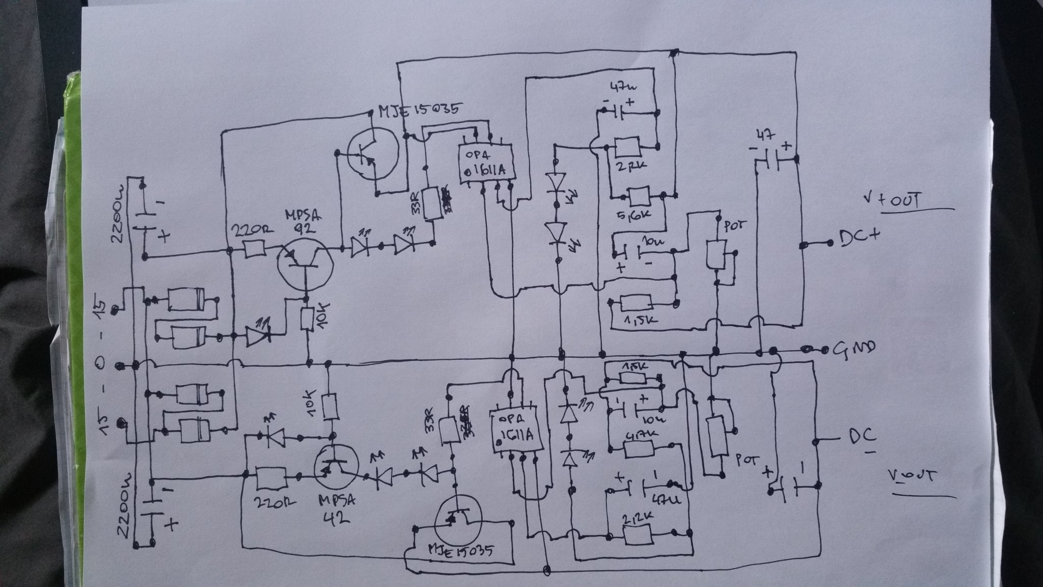

I have got a Chinese PCB board and its called a super regulator by Jung, not sure if it is one of W.Jung's designs but it works quite well, I tried it with a NOS DAC chip, not a but result but it sounds very forceful, a bit too much of a good thing I would say.
I have drawn the schematics of it and it would be great if the design can be improved if can to be improved obviously 🙂.
...please have a look at it and add your comments.

If you have some equipment you should measure noise at different loads, I believe a oscilloscope, or even better a soundcard could provide answers

Did you read the article posted with the kit at diyaudiostore.com? What is unclear?
Jan
yes, I did manage to get it running, and to be honest, it does perform exactly the same way as the Chinese version,...sonically at least,
would you mind looking at the Chinese one and letting us know what you think?,
