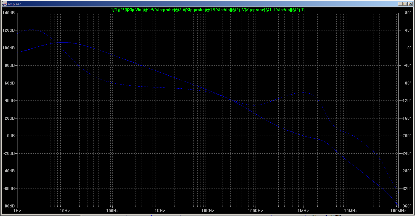

Thanks Dave and Shaq for encouraging me to try Wiedmann's loop gain probe. It really is plug and play.
Here's the Tian return chart, using the same circuit from post 18, with the big inductor removed and the probe added at the same location.
Is this the right location? There are two feedback loops, the TMC loop and the global loop. This benign-looking graph locates the probe outside of the TMC loop.

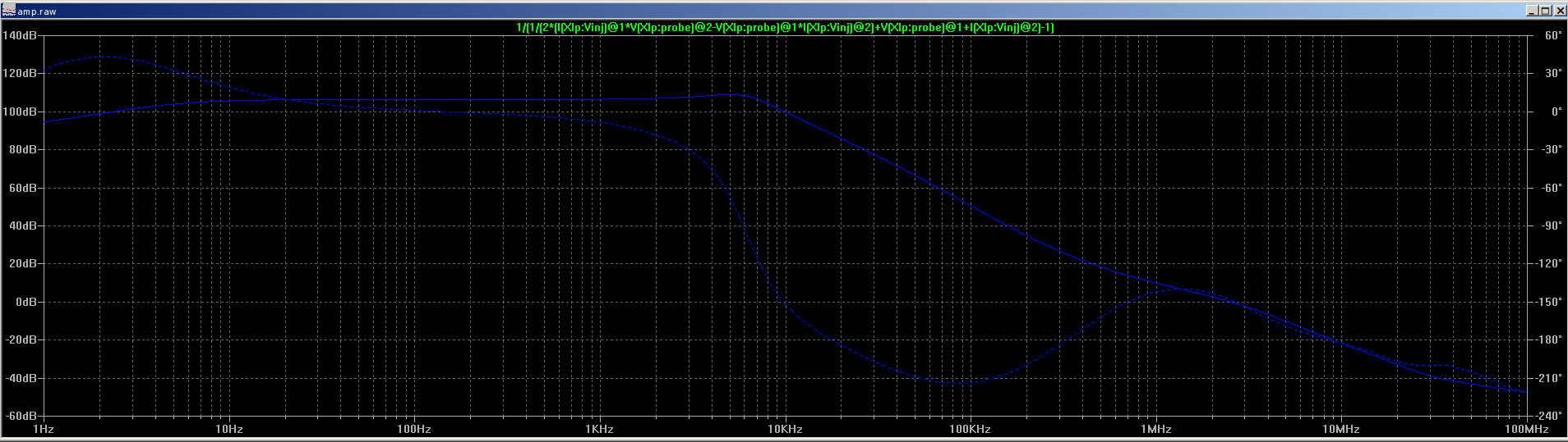

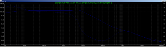

Here's the return ratio plots after locating the loop gain probe inside both TMC and global loops.
The phase lag exceeding 180 is superficially scary. But, it's similar to plots posted here which show that for a typical TMC amp, in-band phase is -90 when probed outside the TMC loop and -180 when probed inside both loops, for the same perfectly healthy amplifier.
I'm tempted to hazard a guess, based on nothing but pattern matching, that the maximum safe phase is -225 when probing inside both loops (with -270 being the point of no return, instead of -180.) If that's true, it would make the phase margin here close to 50 degrees regardless of where we decide to probe.
I'm tempted to hazard...that the maximum safe phase is -225 when probing inside both loops (with -270 being the point of no return, instead of -180.) If that's true...
Unfortunately it's not true.
What you have is "conditional stability", search on this and "Nyquist" to learn more.
You are quite close to no stability at all, the amp is likely to oscillate if it clips or from load and component tolerance, power supply variation etc.

I haven't checked every parenthesis and detail but the text at the top of the plots looks like a Tian expression for Return Ratio (AKA Loop Gain).
The plotted data in #28 looks plausible for Two Pole Compensation (so-called) or similar variant (TMC).
The plotted data in #26 looks plausible for a common incorrect position of a probe intended to check TPC/TMC😉

Ok, a bit more detailed response.
First, be careful when you read that thread, Damir is excellent with circuits but his use of the term Open Loop Gain looks incorrect in some early posts.
Even native speakers in this forum often mess this up, so no disrespect to Damir.
Someone sorts it out towards the end, maybe read the thread backward.
Also note that Damir's amps are usually unconditionally stable, or close.
Yours has an extensive zone of conditional stability.
#28 shows your amp PM is only 30, Damir usually around 60 or more.
The probe position for your plot #26, if I understand your description correctly, is not useful.

Both plots 26 and 28 show loop gain measured using Wiedmann's implementation of Tian's method.
