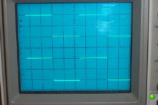

Hi all,
If anyone is interested in how the Aikido looks, as built, with the boards that Bas and Bonny provided us with. Well here are a few tidbits.
First a disclaimer and some history. I am not a tube Guru, just an engineer. I am plotting the load lines for this circuit and I’m still not sure they look right, but they do work well and I know enough to tell that tubes are not in death mode .
More of that on a different post. (tube gurus sharpen your pencils, thank you)
Anyway, I built one with 6n1p in the front end and 6n6~ (I just can’t get the hang of the Russian alphabet), as the second tube. My lashed up power supply only netted 170V.
Oh well, lets try it anyway.
Sounds OK. Not world class, but the dynamics are very promising.
I dust off the scope (literally) and can see that one side of a 1k sine wave doesn’t match the other. Nothing harsh, just nolinearity. A check of the bias shows .8v at the grid with a 430 Ohm Resistor . That seem a bit too close to 0v. time to fix the power supply.
I do so.
Now I have ~240 B+ and more like 1.6V at the grids. Thit's more like it .
A check of the inputs and outputs. Shows not much to report. They look pretty much the same. I fiddled With the scope controls , to overlay one trace over the other. They look much the same, except one is 2vp-p and the other is 40vp-p.
So, what do you think?
In this photo the top trace is the input, 2V P-P . 40khz. Scope set, at 1V /division
Lower trace 20v p-p scope set at 10v/ division @ 40khz
Remember this is 40k not 1k If anyone has tips as to present this better, please help…John

John, the picture you posted of your scope is exactly what I get using a variety of frequencies, and finding power supply noise at the outputs is next to impossible.
