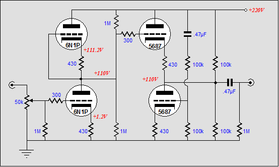

Guys, I'm new in this thread...
i try to understand about the calculation, but i'm still confusing about how we calculate the cathode resistor for the 1st and 2nd stage...
can someone told me how to calculate that since i tried calculate the resistor in JB's article (Aikido 6n1P and 5687)... they're far from my drawing...
thanks
here the schematic :
