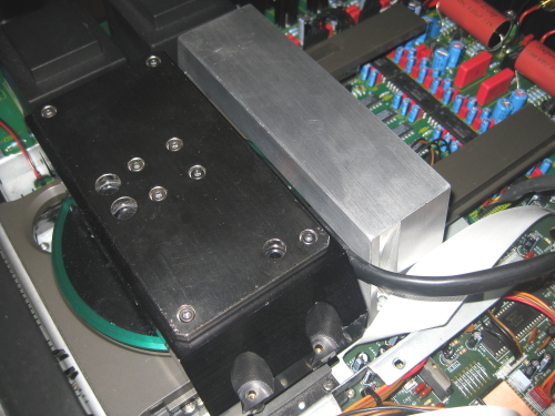

I bought (again, again, again) another VRDS-10 and used the servo board and the CMK 3,2 drive.
The connectors on the CDA-288 Mk. I and the MK: II S.E. are different in a very nice way: they became lazy at Copland in Copenhagen, and used some of the connectors directly from Teac. Well, to be honest, I don't know if they are lazy, they just did it. There could have been mechanical issues, production matters or other reasons. Anyway, it made it all the more easy to install the VRDS-10 servo board into the Copland CDA-288 Mk. II S.E. Thanks Copland! It fits right in and all connectors are ready.
The remaining connectors (most), are from the CMK 3,2 drive: laser, sensors, switches and hall bridge motor etc. Fits as well, as it all come directly from the CMK 3,2 driven VRDS-10.
So, on the Teac, the display sits below the drawer. On the Copland, it sits above the drawer. There is no way the CMK 3,2 will fit hight-wise and also in width. Hmm...
Fortunately a sanding of the underside of the lower composite plastic chassis is easy, use a mask, and it can be trimmed down.
Doing this, there are a few observation points, that have to be solved:

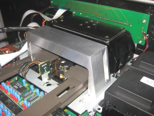

1/: the motor assembly that raises/lowers the lower center spindle, is mounted on to a metal bracket that is screwed down from above into the lower chassis. This make it hard to sand the chassis from below. Therefore I chose to alter the installation of said motor bracket to be as flat as possible, including cutting up threads to 4mm instead of Teac's 3mm, and use pinol stainless (un-magnetic) screws from below with a dab of 10-seconds glue to each (undoable/redoable). This solves that.
2/: the laser sledge lock mech have to be undone, by removing the white plastic tab. I will later on redo the small bracket and reinstall the laser lock tab, just in a lower, flatter version.
3/: the small flat laser cable transition pcb that sits under the lower composite chassis, have to be raised as much as possible. So I took off the standard stays and installed two new very low stays. Both 3mm screw versions. This raises the small pcb to lower the lower chassis that the whole CMK 3,2 drive can stay on 25mm stays and clear the bottom chassis plate on the Copland cDA-288 case.
4/: the next thing is to have a longer flat cable from the aforementioned laser cable pcb, to the Teac servo pcb. The standard used is 17cm long. I need at least 20cm to reach the connector on the servo pcb reliably. So I found that on fleabay. It works well, and the fresh lanes are most welcome.
On the Copland, there are welded in some 30mm stays to support the CMK 4,0 drive from underneath. The two front ones must be cut off. I then installed two lower 24mm high 3mm bolt stays on the front edge of the CMK 4,0 metal upper chassis plate and when all else was finished, I gave them a dab of strong glue and installed the drive into the Copland case, waiting 24 hours for it to cure fully. The rear one to the left side is copper and makes a ground. This and the rear to the right are cut down to 24mm and drilled out and new 3mm thread cut, to support the modified CKM 3,2 upper metal plate chassis, which have to be drilled to suit the mentioned two stay on the rear. This is done by marking them with a dab of white tusch and install. Then lift the chassis and drill the upper metal chassis plate in the two spots now marked white. Finetune the stays in relation to the installed cd tray, before making it final, so the tray is centered in the opening of the front chassis plate on the Copland CDA-288.
Next is drilling a 10mm hole to support the HDCD led on the front of the Copland CDA-288. Then the connector can easily be installed/undone.
Then the sides of the upper metal chassis plate must be cut to suit and clear the Copland power supply pcb on the left and the Teac servo pcb on the right. A couple of corners have to be trimmed as well. I retained a few mountings points from the VRDS-10 sub chassis, so all it reversible. Also, new male-female stays in brass are ready to reverse the mods on the rear stays of the Copland CDA-288.
On the lower composite chassis, there have to be done a few trimmings on the sides as well, mostly where the chassis have protrusions to support the upper bridge. They can be angled and still fit well.
Next, the rearward right side spring have to be removed. It will still function well with only 3 springs.
Lastly, the right hand side of the button control logic pcb of the Copland CDA-288 have to be trimmed down a few mm's to clear the CMK-3,2 chassis.
That's all.
Of course, I have to retrim the laser to suit, as it's been handled around and need new precision adjustment. Just follow Teac VRDS-10 service manual, and it's done.

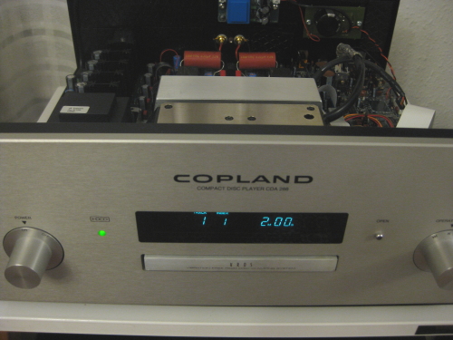

It plays! A CMK 3,2 drive is now working in a Copland CDA-288 Mk. II S.E. and is MUCH more precise and well working. I'll report back on sound quality etc, once everything is scoped and adjusted properly again.

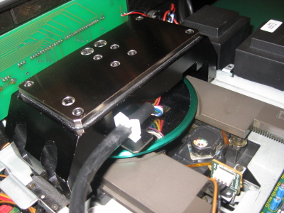

I took the upper CMK 3,2 bridge apart and kept the hall (sony) motor coils as they are important. N need for voltage and amp changes then.
I then measured up the CMK 3,2 upper composite bridge and it's important dimensions: inner height to coils, spacing, drillings etc. A friend is now making a fat heavy stable aluminium one for me. It's only reinstalling the upper platter and the platter brake, and reinstall on to CMK 3,2 drive.
Improvement 8:
I also feel that the upper bearing which is a plastic grey cap and a dab of grease, can be improved. Note: the tightening of the upper 3 screws can determine the brake and resistance.
So, I made a design for a better top bearing, which uses a square top cap in metal and a bore that supports a ceramic ball. Less wear and more precision and less contact area to the spindle/top bearing relation. A ceramic ball is more round and wear less.

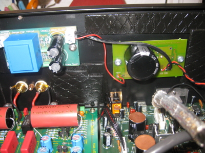

As with all things, matters can usually be improved and the clocks that Teac/Esoteric used in the old players, there are certainly things to be done. I installed an LClock XO and a separate power supply to avoid any transfer and get a precise stable clock.
Now, some years later, I want to get an even better clock, and lo and behold Larsen Audio made another much better version: LClock XO3, which have better shielding, lower ppm's (now 1!), and other improvements. Same power supply can be sued, so I'll do that, unless of course, I find a better one still.
Improvement 14:
Capacitors.
I unsoldered the two most important ones in the signal path in the output stage and soldered in two bigger ones from Jantzen audio. It did take some hours to make them fully sing, but that made an improvement.
Improvement 15:

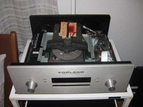

On my two Copland CDA-288, the Mk. I and the MK. II plus it's a special S.E. model with K selected BB PCM63 dacs instead of the normal BB PCM 63P, there's the good sounding CMK 4,0 drive, but I want to obtain a better output from the drive, before it enters fintering, conversion etc. So hence the wish to build in a CMK 3,2 Teac VRDS drive into the very confined space on the Copland CDA-288 cd-player.
This should in theory give a lot of advantages:
1/: better laser, glass kss151a. Improvement 1.
2/: magnetic drives laser sledge - fast and silent, and far more precise because it's not snail or tooth driven. Improvement 2.
3/: big hall motor on the upper stable platter. Improvement 3.
4/: thick heavy cast aluminium upper stable platter. No noise from the cheap Mabuchi made in china brushed motor that bestows the CMK 4,0 drive. Improvement 4.
5/: a stable composite non-twistable upper bridge. Improvement 5.
6/: better upper bearing - larger, more precise. Improvement 6.
All this should in theory help with better output and mechanical stability/precision, which should lead to less errors and less error correction 😉

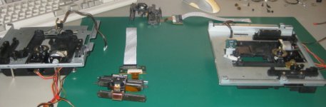

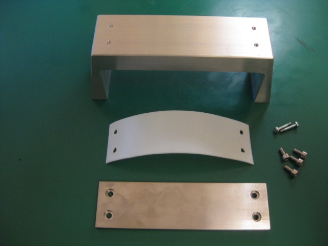

As Teac actually did the bridges with a lot of precision, and it's slightly curved 0,5 degree, it's difficult for me to replicate the upper stable platter. So BRIDGE it is.
The later Teac/Esoteric Neo bridges and the last old series upper bridge have a construction that I can replicate. Thais can be done as long as I retain the CMK 3,2 upper platter as this has a certain weight and dimension.
Improvement 7:

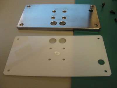

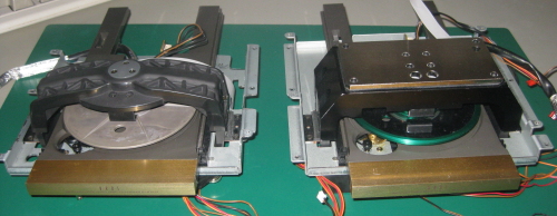

Improvement 10:
I wan to obtain more stable rotational speed. On say a car engine, there is a flywheel. This acts as a stabiliser to the engine, so torque is retained better than with a light flywheel, which makes the engine pick up rotational speed faster. The exact same thing is the case with the CMK drive in our VRDS-drive cd-player. So I want more mass. I cannot make this myself though. But it would be nice to have, to obtain and keep a far more stable rotation in the rpm's that a red book reading does. More mass brings rotational stability.
On the Superdrive CMK 3,2s, is a far better upper plate in relation to stability. It is a better cnc made platter, rather than a cast low quality aluminium/zink thing. And it is heavier. Like on the CEC belt driven thing, the belt is not the only smart part. Rather the mass of the puck. Same here.
To improve on matters, Teac also made better magnets and an improved bearing, plus a stronger hall motor. I got what I wished to improve on.
Improvement 11:
On that Superdrive, there is a far bigger more stable well executed upper bridge and it will absorb and prevent vibrations from doing harm. More later.

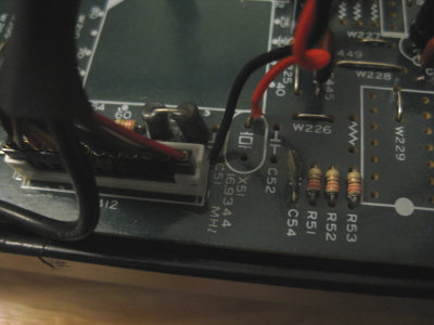

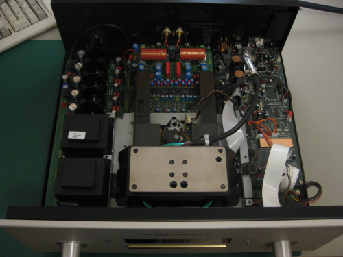

All right, so I experienced a few problems with the sound from using a Teac cmk-3,2 drive and it's specific servo board in the cmk-4,0 based Copland CDA-288 Mk. II SE cd-player.
I had some noise coming out the speakers as well as it it played the music.
Together with a friend we looked at the two servo boards, and noticed that Copland modified the cmk-4,0 fitting servo board around the digital signal gate towards the dac board. The simply soldered in 4 little shorting wires, which then surpases a few components, which may act as a sort of filter.
Anyway, today I modified the cmk-3,2 servo board to be the same, and voila, it plays well.
Later on, I will try to finalise the practical install and then I'll experiment with the cmk 3,2-Super drive, from the Teac P70 and the Waida 861SE, which I happen to have.
I already looked at the motorsystem on that Super drive, and I rebuilt it to fit one of my VRDS-10 cd-players, and it works well. Definately a sound improvement. Better sound all over, firmer bass and more black background. Mechanically, it seems to be far more stable.
Later, I will also try to see, if i can improve the servo system on the VRDS-10 setup, because that servo board is also now in one of my Copland CDA-288 players.

Here's a picture of the testfit that plays perfectly from tonight, with Diana Krall on the speakers.
Kind regards,
Redfox.

All right, so now I've played with some laser changes. Still need a scope adjustment for fine tuning.
Then it was time to rebuild the drives to higher spec as for example from cmk-3,2 bridge and platter, to cmk-3,2 Super bridge and platter.
I also needed to borrow a cable clamp from the wobly cable bridge from a cmk-3,2 VRDS-10 drive, so the platter motor cables are guided correctly inside my Copland CDA-288 Mk. II SE.
I also took the liberty of dismantling the Super drive completely and clean all parts and relubricate. I used a drop of light teflon oil on the platter axle to endure smooth running and less wear over time.
Finally, I could install the new reworked drive in to my Copland cd-player. And it plays flawlessly and super smooth.
Next up will be evaluation of rebuilding either my existing Clock XO to either a newer XO3 or maybe even the new "New Class D" made super clock.
We'll see.
Kind regards,
SFC1000
We'll see.
Kind regards,
SFC1000
Okay, so I now transferred the separate clock generator "Lclock XO" and the "Lclock Power supply XO2" to my modded servo board from the Teac VRDS-10, to the Copland CDA-288 Mk. II SE.
Looking at the two pcb's there are similarities and differences, and on the Copland servo board (Teac T-1, VRDS-7 or similar, one have to unsolder the crystal X51, C51 and C55 which is an orange trimmer.
Then solder in the clock out wire into the hole where the crystal used to be, that is towards the center of the whole pcb. The ground wire have to be soldered into the hole of the removed C51 towards the outer circumference of the whole pcb.
Connect power from the extra transformer, and you are good to go.
Using other servo board from Teac VRDS-10, there is no orange trimmer C55, but there is an extra capacitor C52, that have to be removed instead.
Solder in wires as before and it plays.
Here's some pics.
Kind regards,
SFC1000
Here's some pics.
Kind regards,
SFC1000
Okay, so what came out of this cmk-3,2-Super drive installation and the accompanying servo board?
Well, from a mechanical point of view, the platter itself spins more silently and smooth. I'd say a small but noticeable improvement over the standard cmk-3,2 and a bit more so, over the original cmk-4,0 drive in this cd-player. The magnetic moving of the laser bridge is silent and snappy. And the motor for the platter is also speedy and silent and far less wobly.
The sound on the other hand, is noticeably better. On many aspects, the sound has improved to the better, for example details are more clear, the already big sound stage has expanded more, and one of the aspects this cda-288 (in Mk. I standard version) was originally criticized for, was that it was a bit soft in it's sound presentation, lacking a bit of attack and dynamic. Well, that is surely there now, being both in for example a drum beat (e.g. Havasi - Drums and Piano), and when a symphony orchestra explodes. And when Jean-Michel Jarre or Dire Straits hit the notes. So, I'd say a definitte improvement on any parameters, and worth the effort. It's a bit rare in my humble experience, that one can obtain an improvement over such a broad scale.

Improvement 16:
So I spent some hours with some tech friends who tested a drawing I had made, and which was then fabricated, to obtain more mechanical stability and ressonance-deadening on my modded MCK-3,2-S drive. The VRDS-10 does have a thin metal sheet folded support bridge for stability between drive (upper) and the two-layer casing chassis. But it's only bent and now welded in corners, so I thought on doing that. But in the meantime, I thought why not make something different and maybe look at the CMK-3,2-Siuper drive upper bridge, which is big bulky and heavy, plus it's a sandwich construction, so there's a thin teflon sheet between the aluminium and a 6mm stainless steel plate on top.
I started by having the aluminium bridge tested and it's very effective. It's now been installed for a dew weeks, and I'd say it made a small improvement to the more black background and a little bit more details. Like a small improvement on for example guitar strings and a drum skin. Okay, so next is the sandwich design, which I am working on now. We'll see if that brings any change, improvement or not.
Another plus on this new implementation is, that the drive is now really insensitive to bumps, jumps, tapping, vibrations etc.
Next will be a complete design of possibly a double bridge, like the two connected, and with a heavily improved bearing design as well as using the platter and spindle from the Esoteric P2s drive that I have.
Here's the new bridge in action. It's now bolted down more firmly than standard.
More later.
SFC1000
More later.
SFC1000
Times passes by when one have a good time listening to music, so here's an update for the rear bridge that I made earlier on as described in the above.
The idea is to replicate what Teac developed (together with Wadia). So this consists of the bridge itself, then on top of that, a 1,5mm teflon sheet cut to suit, and finally on top of that, a 6mm stainless bridge, cnc'ed from a hardened piece.
The original Teac CMK-3,2-Super looks like this:
And here's the present day parts for the stabilizing extra rear bridge:
And here's the parts installed and playing:
Regarding sound, I can firmly tell, that bass is sharper, as in drums comes in quicker and more solid. The drums on Shade "Soldier of love" stands out as a prime example of how fast that actually is played. Another example is the "shooting sounds" on Dire Strait's Private Investigator, which also kicks in with an amazing speed. This general handling of speed and precision is greatly improved. I will soon take the drive out and finetunes it a bit here and there. For example I will have the rear bridge anodized black to prevent an eventual reflection of any source of light. Just as Teac did.
Another aspect is a greatly improved ressonance dampning. Now, there's no way I can make the cd skip by stomping or playing really loud. Not that it really ever was so, but I can knock on the cd-player, and there's absolutely no skipping or otherwise. Great.
I am also looking into other means to prevent any externa light to enter the cabinet as a whole. I have a couple of ideas, that I am now experimenting with. More later as I implement it.
Kind regards,
Redfox.
Kind regards,
Redfox.
