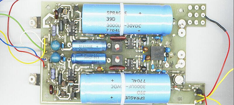

Hi, In the good old days Tom Colangelo came up with the PLS-150 supply for the Mark Levinson ML-1 preamplifier. We were shocked by the abundance of parts and by the fact it was not potted. I reverse engineered the supply and found it is somewhat similar to the PLS154 used for the ML-7 preamplifier of the same brand.
The PLS150 is not a dual-tracking supply and has two 1N5526 zeners that are filtered and one is used for each supply (positive/negative)
The PLS154 is using the same reference, also filtered and used as a reference for the positive supply. The negative supply is then obtained by inverting the positive supply with an unity gain inverting amplifier.
So far so good as I am inclined to believe Tom is convinced a dual tracking regulator is better than a conventional dual supply.
But the Mark Levinson company went down for about a year and Mark Levinson (the person) founded a new company Cello. His favourite engineer Tom moved with him. And what do I see as the regulator of the Cello Encore preamp? A LM317/337 STEEL (TO-3 case) from National.
Anyone can shed light on this?
Attached picture is of the PLS150 supply.

The examples I gave are not the whole story. The PLS150 supply is dead quiet and the PLS154 also which cannot be said of a LM317/337 setup. The latter is simply not quiet enough powering a MC-cartridge preamp.
I did see some extra circuitry around the LM317 in the Cello so maybe Tom Colangelo designed something along the lines of Fred' s suggestion........(Improving the LM317 regulator thread).

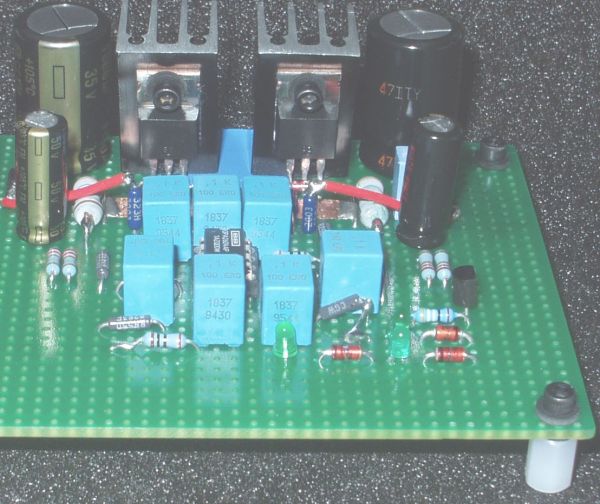

"A message from the Space Wanderer (Malichi Constant):
Another pic of the finished regulator. Output +/-5 V to +/-22V (or 0/+44V) up to 1 Amp (with bigger heat sink with some resistor value changes and higher voltage caps on input. Drop out voltage about 5 or 6 volts. the dual op amp uses the regulator's output for it's rails but is decoupled from the supply starting at the point its PSRR starts to drop. RC output decoupling for best stability and no noise peaking. All the filter caps after the Voltage reference circuit and for op amp decoupling are polypropylene. The voltage reference is tapped for 5 10 12 and 15 volts. Op amp runs AC unity gain and the Mosfets are preloaded for decent transconductance. This took only three days to design and build. This is real straight forward stuff and not that hard. The posted design is not even up to doing the basic stuff right as outlined in the original Sulzer op amp supply article in TAA nearly a quarter of a century ago! The best part is not putting a gate resistor on the power mosfet. Something that is known to anyone who would dare call himself an audio designer would know better than to do."
End of message. Stop.
We hate Malachi Constant because..........

Fred: If you have some solutions you would like to share, why not publish the schematics also? I did .. ;-)
Lars
Fred says:
Sometimes it's essential to have this resistor and sometimes you don't need it. If you don't have a problem with oscillating mosfet then you don't have to fix this.
Sometimes you can't say for certain that something is totally wrong or totally right.
