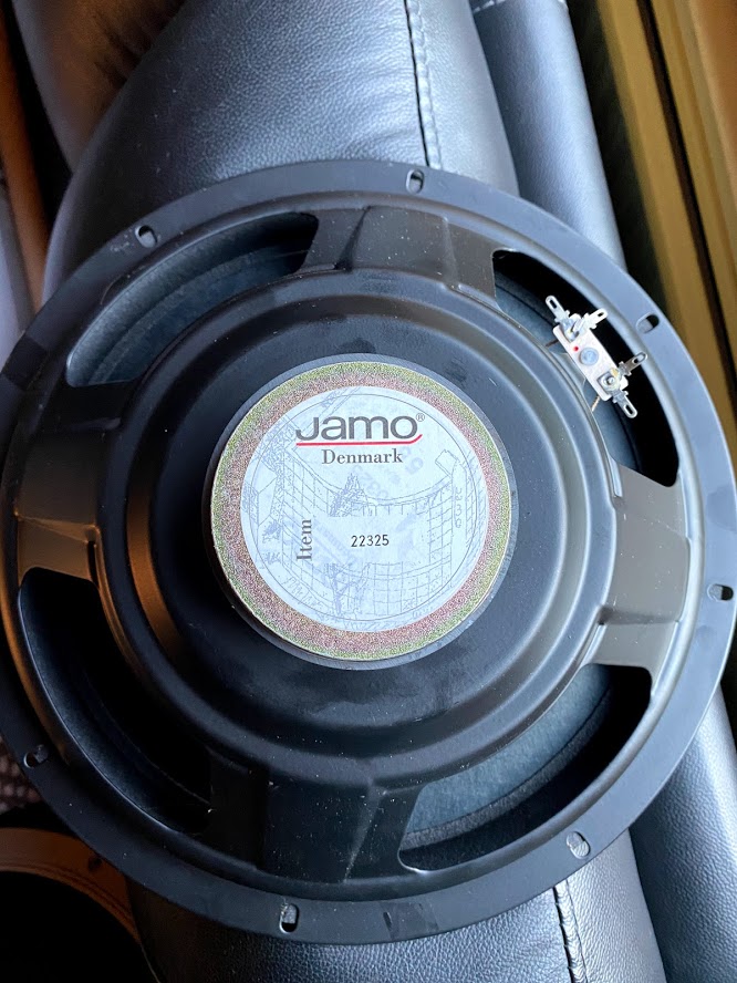

I am thinking if someone could help me on my project - Upgrading a pair of Jamo D 265 C speakers on the cheap! While I know you can’t make a cheap speaker great, certainly we could make these better without spending a fortune, all while learning something along the way. Isn’t that the spirit of DIY? 😉
The speakers are Danish made, vented box with a 12” bass driver, a 5” (or so about) midrange and then a tweeter which I ain’t familiar with yet. The speaker box itself is made out of particle board with a decent thickness. But it has no bracing and very minimal damping. Also the bass / mid are quite badly fastened to the box, using plastic rings to compress driver to the box, without any sealing material in between the speaker and the box. The crossovers are pathetic, as is the cabling which has a diameter barely visible to the eye. These I would like to improve by learning how to build new crossovers, of course not using any high end components but standard ones of decent quality.
So my first mods will be: Bracing the cabinets lightly, adding some damping material to surfaces except baffle and add light stuffing. And then I would like to upgrade / make new crossovers. But with that I really need help.

Not sure on those speakers, but my experience with "improving" commercial equipment has been unsuccessful...
As you said bracing and damping the cabinets would be an obvious starting point.
Improving the mounting and sealing might help, you might be able to cheat and use a decent silicone sealant to seal them back up (not bathroom sealant, a slow curing type). Or you can get decent sealing tapes (not draught excluder/door sealer).
Anything more, if it starts costing money, you might as well put that into better speakers (second hand) or start building something from scratch?

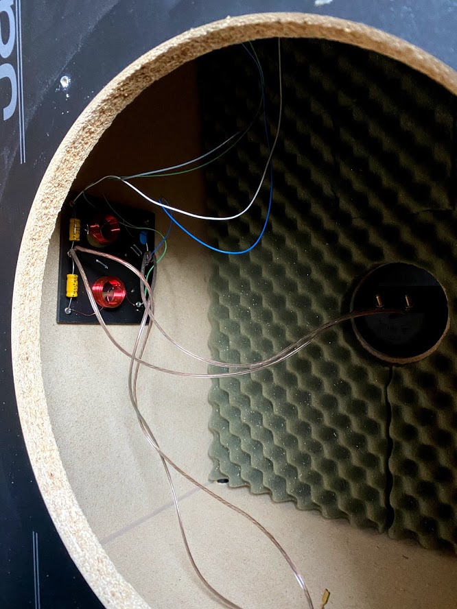

Post some photos of the crossover components. At least it will be worth replacing any old electrolytic capacitors.
Yes I will try to give you some pictures today. The crossovers are very poor looking things. I think I will try doing the bare minimum to filters and enclosures to see if it makes any difference, otherwise I'll mount the speakers in the garage 😉
A crossover redesign will probably help, though it will not be cost effective. It is a big challenge and you will learn a lot, so that could be a reason to do it.The crossovers are pathetic, as is the cabling which has a diameter barely visible to the eye. These I would like to improve by learning how to build new crossovers, of course not using any high end components but standard ones of decent quality.

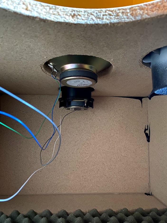

The tweeter is a dome tweeter in a small ”horn”. The mid driver is a closed one ”Jamo item 22470” and the bass driver is ”jamo item 22325”. From the crossover the green/blue wires go to mid, grey/black to tweeter. As can be seen there isn’t much damping inside the box.

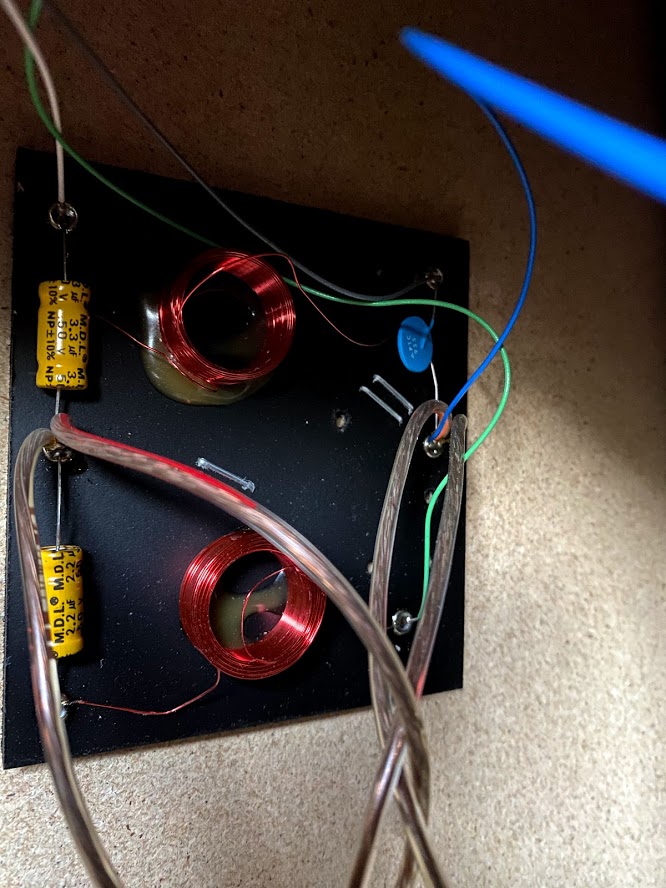

Very basic crossovers - 2 coils, 2 NP electrolytic capacitors and a polyswitch speaker protection component (the blue disc).
Probably not worth changing the capacitors, but they're all you should bother to change - apart from the wiring, if you want to tidy things up a bit.

It's worth attaching some damping to the walls. One way was suggested earlier. Bracing is also a possibility.As can be seen there isn’t much damping inside the box.
I see the rear wall has foam absorbent attached - I would add some to the top, bottom and side walls on top of some damping material.
Note: Do not 'stuff' this reflex cabinet - absorbent on walls only.
