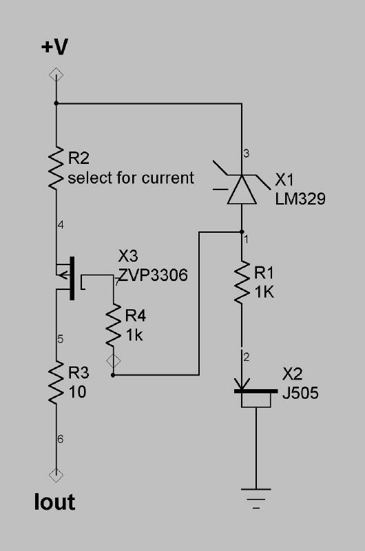

the proposed design is not optimal
Says you........
If I wanted bipolars and and feedback I would have put them in.
If you put a cap across the LM329 the current source will come up slowly and you will get the turn on thump from hell. This is the third time I have explained this but I will keep explaining and save some poor soul from killing a speaker during power up or down. I put the resistor in series to damp any resonance from the inductive output impedance of the LM329 and capacitance in the current diode or fet use to bias the LM329.
Thanks for your help though......
H.H.

Thanks Harry,
Good point. I use output protection circuitry (delayed on, DC sense, extremely fast output relay off-switching, ac-loss detect) so I don't "see" the thump, but it is a good point since this will likely be stressful on the device itself and protection circuits can fail. Perhaps I will consider going with .1uF alone in the future, but there is no way that I personally will forgo without any capacitance in that position.

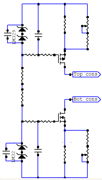

Another point. If you ever need symmetrical current sources (one on top, the other on bottom), you might want to feed the two voltage sources driving that current device directly between each other instead of to the traditional ground. I have standardized on this approach. I see more and more postings indicating this type of approach, the latest by NP, but in a slightly different scenario.

The ap notes shown the noise voltage rolling off above 10kHz and the gate resistor and Mosfet capacitance are going to roll off high frequency noise.
The ap notes show no caps across reference. I believe 0.1uF will still thump a bit. I assume no blame for bent voice coils and jumpy pets and family members......

You are right again, HH
And I had forgotten that I have been drawing RC circuits lately as well .... Thanks for reminding me!
Shown with matching negative current source to illustrate that one does not have to go to ground.
The curious 3 resistor setup is what i use in low power situations to get maximum use of each turn, while putting minimum current through the adjustable resistor. I call this "triplets" and there is an excel spreadsheet (using linear optimization) to work out "optimal" values here.

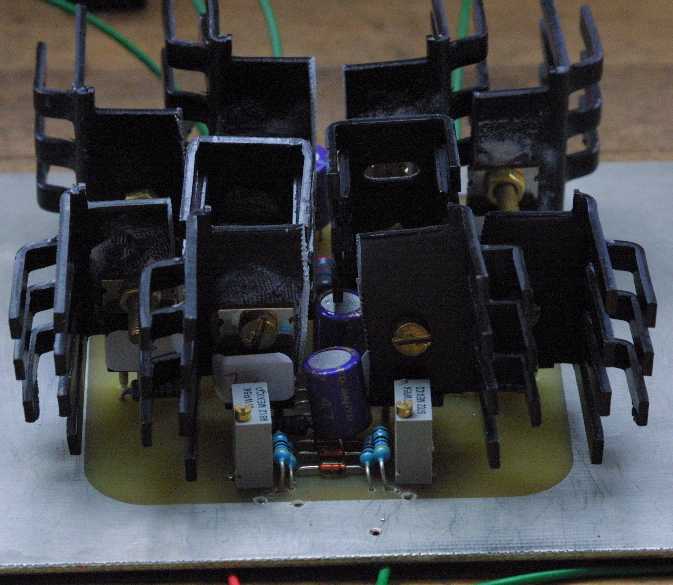

I must admit that building the X100 version 1 (referenced here as an abstract sculpture 🙂 ) was a bit painful, particularly after I had spent a lot of time essentially compressing the X1000 input stage into 5cm*5cm ... and realizing that I needed much more cooling than anticipated. It does look somewhat abstract and I am pleased with it, but it does rather miss that Peter Daniel touch and finish ... Even then, for being the first audio unit I ever built it is not all that bad.
I have since laid out a Eurocard sized version. I now use component footprints that include the heatsinks which is much smarter. I also learned that splitting components evenly between top and bottom was somewhat painful 🙂
