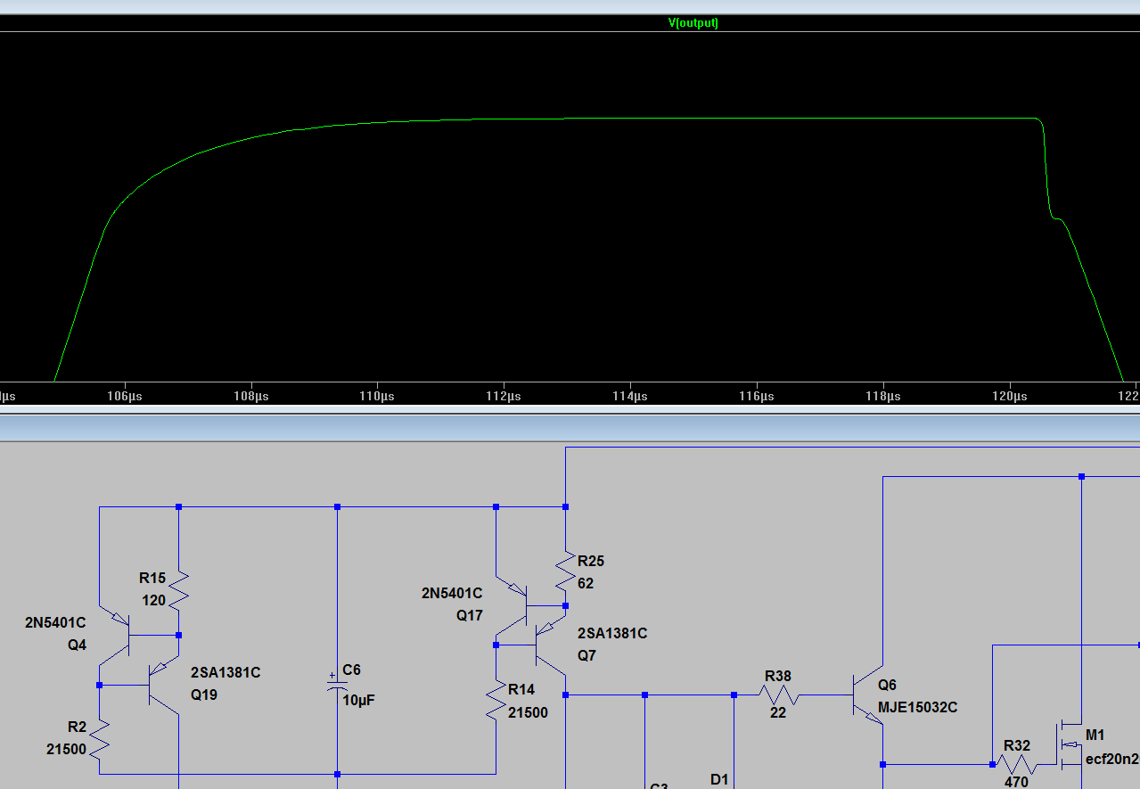

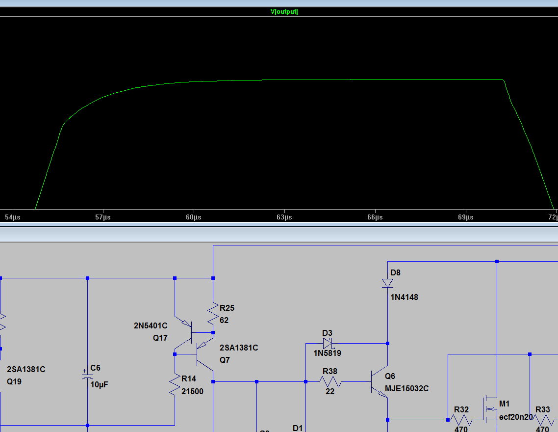

Wanted to make some improvement to clipping performance of my BJT LTP, BJT VAS, BJT Driver, Lateral FET output amplifier.
Simulating with a 2 Ohm load to get a worst case scenario(my speakers are 8 Ohm dipping to 4 Ohm in the bass area).
Clipping, driving an 2 Ohm load occurs at about 3.7V p-p input, which is about 80 V p-p output.
To take it to the extreme I raised the input to 6 V p-p to get some serious clipping.
Attached is result without any measures to improve clipping performance

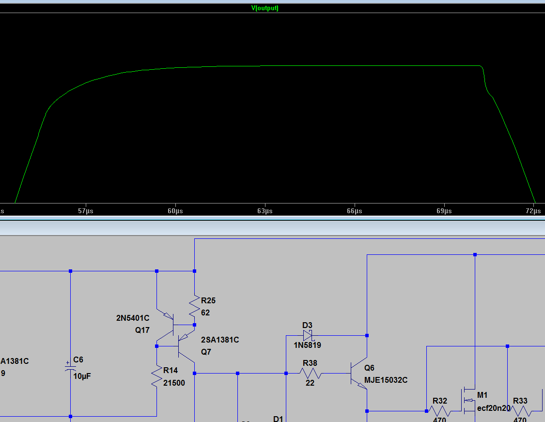

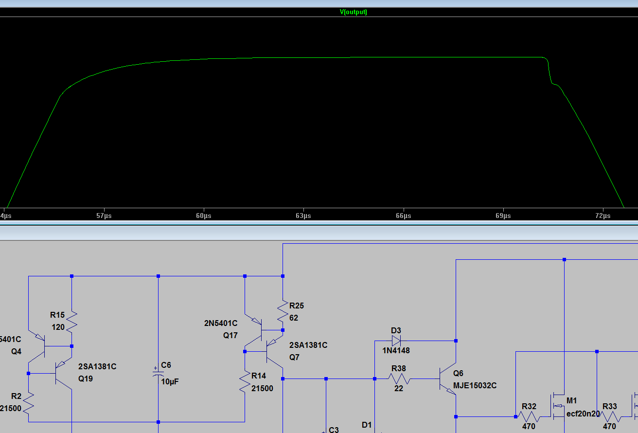

Adding to that, in a real world scenario, when an amp starts to clip continously it will start to sound distorted and unpleasant and people would turn it down.
So 6 V p-p is not realistic at all.
But for short music transients that might make the amp clip on peaks, having some sort of improvement on the clipping performance is a good thing.
"Sticking" on a clipped waveform, even if it just on very short transients peaks, would not sound that good.
The 6 V p-p was just taking it to the extreme.
