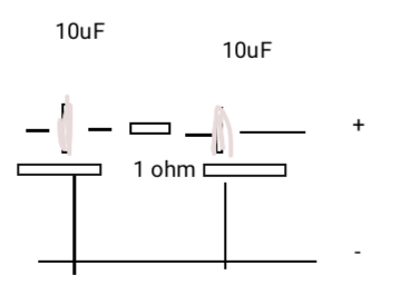

Is a simple filter like this not more effective? 2x10uF between plus and minus and one ohm in line in between

Assuming the wallwart is a traditional EI transformer-based one (i.e. not a switcher) the load capacity is set by the transformer itself. The capacitance on the output is there to smooth the AC but adding more will actually cause the output voltage to drop. More capacitance will not improve the load capacity rather it'll slightly decrease it. If the wallwart's a switcher then things are a bit different but more capacitance won't increase the load capacity in that case either.
I reckon you're better off spending money upgrading your wallwart to a higher output current one than shelling out on that Ali filter.
