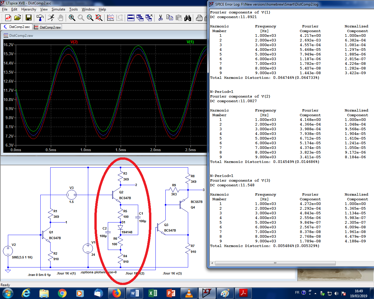

This means that in practice, both circuits would require a follower, to eliminate the influence of the load on characteristics. With this in mind, it is better to act directly at the source of the distortion, the emitter circuit, rather than the collector circuit. Here is an example using a diode to compensate for the non-linearity.
With this sim, the THD improvement is only ~10dB, but that's simply because the compensation is not tweaked to the optimum. With a suitable compensating junction and resistor values, the compensation could be similar to the two other ones.
However, there is an even simpler solution: use a CFP composite instead of simple transistor: the improvement is >20dB, and importantly, it does not require matching or tweaking to attain that performance level (circuit 3). That amounts to negative feedback of course, but the topology remains simple....

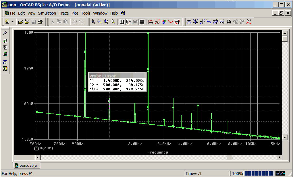

...I used to use Spice 20 years ago in its more primitive state. ...I didn't know that it is now possible to simulate THD on it...
I use a version from 1999 (20 years old). The old-old SPICE .DISTO was notoriously bad and mine does not seem to offer it. It has .FOUR which computes THD, and with good agreement to pencil and breadboard if used properly. The Probe program has a FFT function which will find non-harmonic byproducts.
Here's 1KHz and 2.4KHz mixed 1:1 in FFT. We get products at 1k*, 1.4k, 2k, 2.4k*, 3k, 3.4k, 3.8k, 4.4k, 4.8k, 5.8k, 7.2k, 8.2k, 8.6k, 9.6k, 14.8k..... Roughly as expected, though 4.0k is not showing.
Hi Elvee,
Do you mind just posting the circuit alone. It doesn't seem to appear properly in your screen capture.
Thanks.

Just try it!.The circuit and its gain formula are very simple.The gain formula is on the first page of one of the links in the photo.You have google too.Given the fact that you have an internal feedback you also have very high input impedance and should also have a bit lower output impedance compared with the naked common emitter. The audio electronics literature is full of simple and very good circuits that are ignored just because some other's big talk...More complex circuits doesn't necessarily mean better circuits too.Thanks for the advice.
