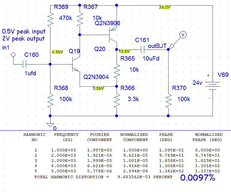

Why not "addition of" transistors? They are hardly more expensive than diodes. You could pay more for a simple box than all the electronic amplification.
Here's a 5 minute jellybean design which gives pretty low THD.
If you want a *real* design, you need to specify input and output levels, impedances, supply voltage..... for all we know, you need to amplify 70V to 280V (say an electrostatic headphone booster) or a 1 Ohm load (ribbon speaker).
like PRR I´d suggest a CFP (complementary feedback pair) or Sziklai pair.
As the name implies it uses local feedback.
Like PRR´s circuit it may come in pure bipolar fashion or with a JFET master transistor as hybrid CFP or hybrid Sziklai. That would allow for simpler biasing.

Interesting, and a emitter follower after that to bring down the output impedance.Dropout common emitter and use common base.

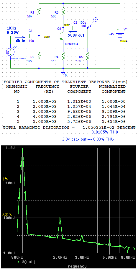

1) Gain approaches Vcc/0.030V, so at say 10V supply the gain can approach 300, which is more than the "about 4X" specified.
2) THD at maximum output approaches 26%, which while an exact THD goal was not specified is probably more than we want. THD is lower at lower output: 13% at half-max, 2.6% at tenth-max.
_THE_ way to resolve *both* problems is to forget this nebulous "global" buzzword. Use a high-ish supply. Add an emitter resistor.
Take a 48V supply. We can approach 16Vrms output @ ~~20%THD. We will probably expect more like 1.6Vrms, so 2% THD.
Gain naked approaches 1,000. Add emitter resistor to make gain more like 4X. The 250:1 reduction in gain makes 250:1 reduction in THD. 2%/250 is <0.01% THD which if simple is amply low for hi-fi.
Now we get to the stuff you are NOT specifying. Power consumption, do we care? Input impedance? Load impedance? Output impedance? Will it be driven from a tube? Will it be asked to drive one to eight power amps with NO change of gain? "Just simple line level will do" won't do.
The "simple" fix for output troubles is to run at high current. So power consumption is on the table. A simple BJT of practical hFE working at high current has low input impedance. (Emitter NFB helps but may not be enough until a *specs* are given and a sketch is made.) It comes down to a game of try more try less and find a best-fit to all the specs.
The 2-Q plan above is a dollar's worth of parts and will probably suit you. Why isn't it built yet? When we know what it doesn't do for you, we can suggest other strategies.

BTW PRR, you are saying that a common emitter amplifier with the emitter resistor can achieve a distortion figure of 0.01%? That's actually more than sufficient for me. I was expecting numbers approaching 0.5%.

> How do do the distortion simulation.
On my thumbs.
I asked the Idiot Assistant and it got similar numbers.
On my thumbs.
THD at maximum output approaches 26%,.... THD is lower at lower output: 13% at half-max, 2.6% at tenth-max.
Add emitter resistor to make gain more like 4X. The 250:1 reduction in gain makes 250:1 reduction in THD. 2%/250 is <0.01% THD...

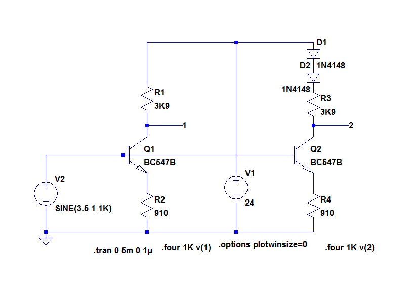

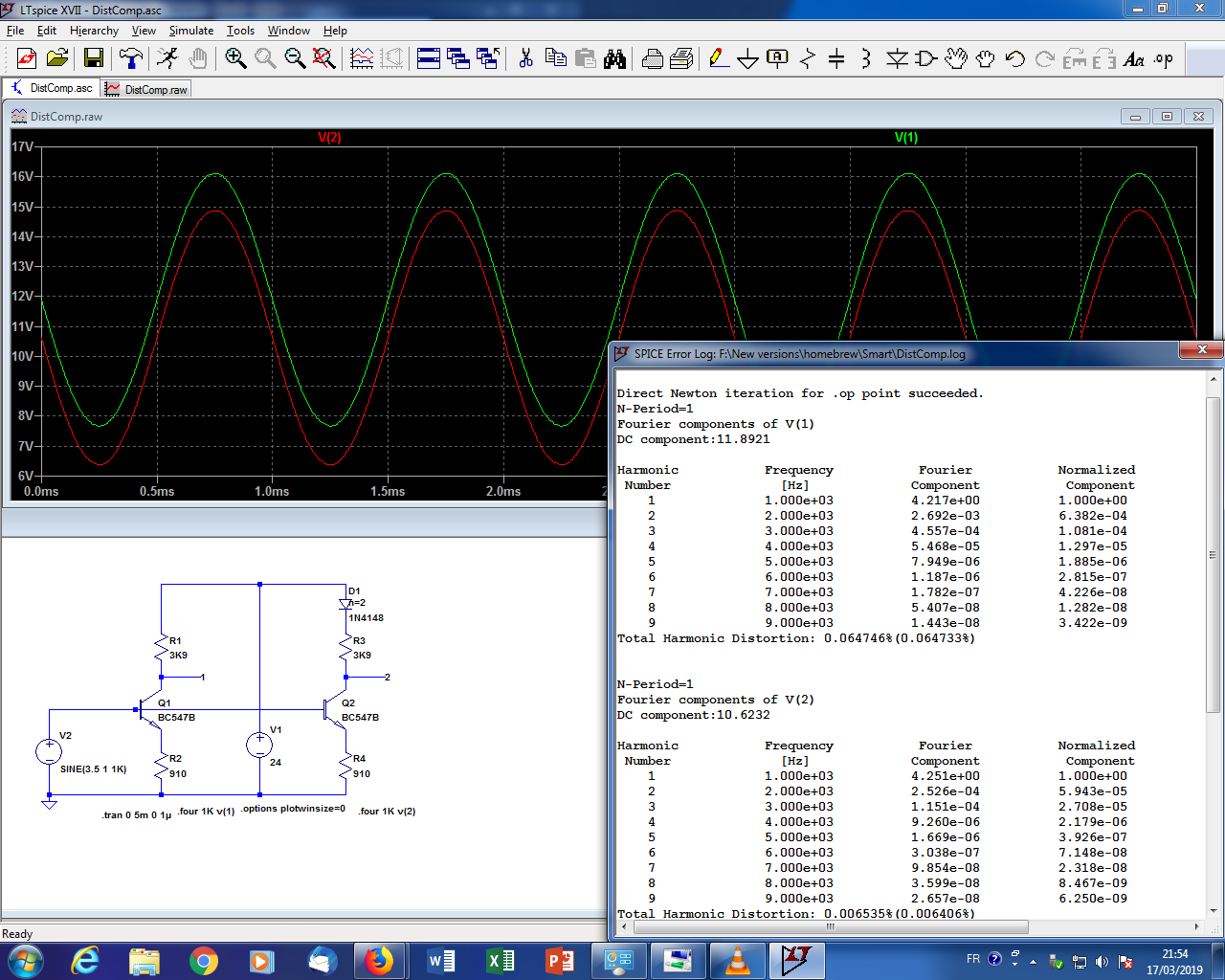

Using compensation methods, it is possible to further improve the distortion without resorting to feedback, be it global or local.
In this example, 2 diodes compensate for the non-linearity of the B-E junction, yielding a ~20dB improvement in THD. Why 2, when 4 should be needed because of the x4 gain? Because the I/V law of ordinary diodes is significantly less ideal than that of a transistor, meaning half the junction number is sufficient (depends on the exact diode type of course).
There are other ways to achieve the same result with a single diode in the emitter circuit and judiciously located capacitors, but taking into account the cost of a diode, the "diode-intensive" method is probably the best nowadays...
BTW, this was simulated with LTspice

Here is the verbatim schematic.This is really interesting results and pretty much what I was looking for. But the image capture is not very clear. Did you put the 2 diodes at the collector resistor?
Note that in order to achieve 20dB correction or more, you will need to adjust the number/type of diode, and to extract the last 0.0001% you will need individual adjustment, for example with a trim resistor across one or more diode, to shunt a little current away, to arrive at the ideal correction law.
Thanks, I don't have big targets for this, I think anything below 0.1% is adequate.
