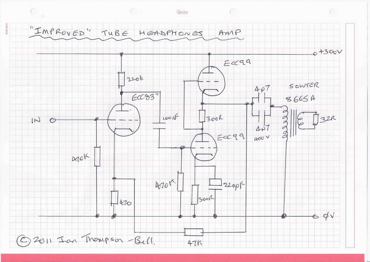

I am well aware there are standards. What I asked was what are normal listening levels i.e what levels do people actually listen at rather that the levels they are supposed to listen at.

I like your question or thought about the required design power or db output of a headphone amplifier should have. The same question could be asked of a power amplifier for loudspeakers. I am afraid that if we look closely there will be some disappointed audiophiles. I believe clipping is the rule. Put the question another way, how much headroom is needed above average listening spl’s to avoid clipping of the peaks. Somewhere here or in the other current headphone thread someone said that headphone amplifiers have power to burn.
The answer is; it depends on the source or program material. If the source is digital, say a CD that is uniformly compressed and uniformly loud where the maximum output voltage from the CD player is 2 peak volts you can follow that maximum peak voltage through the chain of components and you can know with certainty that there are no clipped transients coming out the other end. I saw this illustrated this way. I put the sound track CD from the first Pirates of the Caribbean movie on the CD player and attached the oscilloscope probes to the output of the headphone amplifier. Wow it was a surprise to me for a given setting of the volume knob there was an absolute maximum voltage output. It was like a stone ceiling.
The short version is that the amplifier headphone combination needs to produce the program peaks without clipping.

Headroom is indeed the big issue and you are quite right that so much of today's music has the life compressed out of it such that the level is almost constant. But for recording, for example, where there may well be a lot more dynamic range to the signal, there will often be peaks well in excess of the average level and the headphones amp needs to be able to handle them cleanly. I think the ability of my current design to handle over 110dB SPL with any headphones gives it a more than adequate margin.

I would like to thank Ian for all of his help in finishing the design of his Improved Headphone Amplifier, getting a small pcb run made, and then answering all of my stupid questions that I asked when assembling his amplifier. A birthday present for my brother turned into an inspiring learning experience and an excellent final product.
It took me a couple months to assemble all of the parts that I needed to build his amplifier as it was the first time that I built an amplifier from scratch. Fortunately, everything came along well and I got enough of the design assembled to test his amplifier for about an hour today.
I would like to mention that a couple modifications were made to reduce costs and adapt Ian's headphone amp to 120v power here in the US. Following his recommendations, I elected to go with two Edcor XSE10-50-8k output transformers since these are each only $18. Although these only have one secondary winding, their impedance is well-suited to the 38 ohm headphones my brother is using. $18 sure beats the cost of two Sowter 8665 output transformers which cost more than $200 for both.
For a mains transformer, I purchased an Antek AN-05T240 on Ian's recommendation. Due to these savings, the amplifier cost less than $300 (including the case).
Anyway, while I don't have an Oscilloscope to empirically verify the quality of the audio on this amplifier, I can say that the sound I am hearing on a cheap pair of test headphones is excellent! Even at very high volumes, my music sounds very clean but warm. Ian's implementation of the NFB circuit must be great because distortion is much lower than it is on most less expensive tube amplifiers that I have heard, however the characteristic "tube" sound is still there.
I would like to independently give this design an A+ for its simple but incredibly effective layout and usage of parts. I will take and post some pictures once I get the case assembled.
