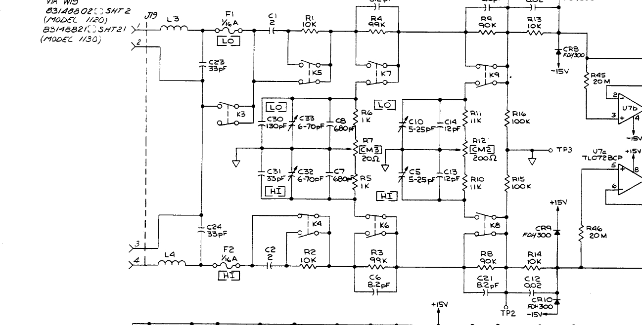

Try using an Tektronix AA501A analyzer front end circuit as a possible guide to protection ( basic clamp) with low distortion.
Brilliant! Literally... they used an incandescent lamp. 120V nominal with a cold resistance of 1k. Perfect!

How about we just insert 900k in series with the BNC input (bypassed with a switch for normal unbalanced measurements)? Then a 1x probe becomes 10x, and a 10x becomes 100x. If you're measuring a plate circuit that should be fine, right? A 10x probe with the input set to 2V full scale would give you 200V full scale...
Pete
But that's worst case- no shunting by the input source and low signal level. If you implement the series resistor, what are the HF losses?
I think Cin will be pretty small. And HF attenuation could be mitigated by a small cap across the 900k...
I was looking at circuits like this. I tried various MOSFETs - need at least 100V VDS to be worthwhile. The problem is that the rds(on) increases as the signal voltage deviates from zero. We are shooting for very low distortion (<.001% contribution from this, I would say) and I was not getting there.
How about putting a smallish resistor where that central FET connects?
Trimmer, of course. 😀 What this doesn't do is buffer the circuit under test from the 150pF or more of test cable capacitance.
Yeah, but it's only ~15pF with a 10x probe. Which would act as a 100x probe...
