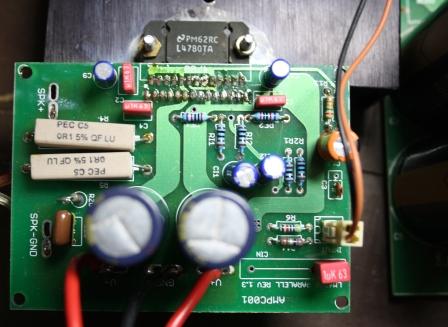

Ah, wait a minute. 38c? less than half the temperature of boiling water?I was testing the amp on a very small heat sink 100 X 100 MM with fins around 20 MM height, after playing for around 2 hours with ambient temperatures ~ 27C heat sink temperature was around 38C. I am not using a servo to correct the offset, I have an offset of around 12mV. . .

It's in non inverting mode.
Speaker was a 4 ohm car audio unit ( Blaupunkt THx 542 ).
PSU rails are +- 28 volts.
The PSU board again is copied from a national application note on audio amp power supply design. I had around 20000 uF per rail of capacitance.
Input was from a TDA7449 based preamp,the datasheet mentions output resitance as 2k.

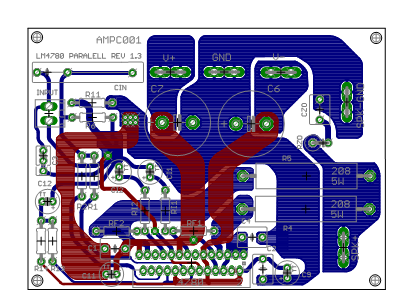

This is the schematic, the zobel resistor i used was 2.7 ohms although it is mentioned as 10 ohms in the schematic.

I wanted to check to see if there was some easy to find reason that the amp is remarkably cool. There isn't.
The only thing that I found is 10uF on both rails, which is quite similar to 4.7uF across the rails and either case removes some power noise. That helps a little bit, but not to the remarkable extent illustrated. However, this in addition to under-volting (28v rails) and good stability, should run that cool. Kudos!
Your offset is because of R6's high value (not enough input load). You could use 20k or 10k for lower offset. I also spotted the timer cap for the mute line seeking ground at signal star, but possibly it should have gone to power star instead of the input.
Unless C11 and C12 are (and remain) properly matched within a few %, there will be large cross-currents when the amp is hit with very low frequency signals.
Matching time constants is the main reason for DC-servos (by using precision film caps) in paralleled chipamps.
Things may get worse here because the cutoff of the input RC is lower than that of the feedback network, instead of the other way round.
Things may get worse here because the cutoff [roll-off] of the input RC is lower than that of the feedback network, instead of the other way round.
For that amplifier would you recommend downsizing the input cap until the bass becomes cleaner, not necessarily less loud, just cleaner? The two amplifiers would have more in common that way, since there's only one input cap. Oh, and what would it be? 3.3u? 2.2u?
Instead of making the input cap too small, shouldn't the nfb cap values be increased by at least 220uF ((220u+3R)//47u//10n) so as to bypass the bass blocker with a larger capacitance value?
I'd put the roll-off of the feedback network at least one decade below the input roll-off (say, 1Hz vs 10Hz). This will result in large 'lytics ot large resistors. Another option would be to make the roll-offs identical, at some 1..10Hz corner freqs and then force the feedback legs to same relative AC potentials by placing a capacitor 10x the value accross. At start-up, until circuit parameters have settled, high currents might flow in either case, and the more capacitance you throw at the problem the longer this time period will be.
Of course you can just monitor the sharing resistor's current (at these freqs any AC multimeter will do) and watch for any cross current flow at 20Hz or so, with no load connected.
Although my schematic shows a 4.7uF input cap, if you see the pic of the test board I was using a 1uF input cap. With a 1uF input cap the roll off for the input and feedback are at the same point. Should I move the roll off of the input a decade higher than that of the feedback network. I am not facing any issue with the current values. May be this issue will crop up if I use the amp in a subwoofer kind of application ?
