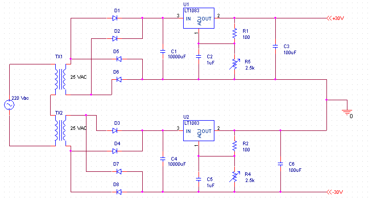

After detailed diyaudio.com investigation for dozens of LM3886 topics, found one piculiar design here that would definitely build 🙂
Initially it uses 2 LM3886 per channel, however I suppose I will simplify it to a single chip due to the lack of space and 90db sensitivity of my speakers.
It uses regulated PS based on LT1038. As my speakers have 4Ohms, I will need some decent toroid of about 200-250VA 2 x 18-21 separate secondaries for both channels according to the posts related to Lm3886.

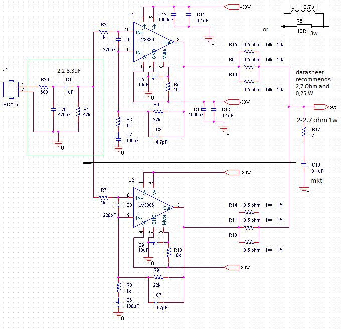

I have attached the schemes below and kindly ask to clarify few points:
1. Will 0.7uh inductor give any benefit along with several 1w resistors (R15)?
If yes, could I substitute it with 1uf or perhaps build one by wounding around the body of R15 as it's mentioned here.
2. the block marked green on the scheme is some kind of complication if compare to other LM3886 power amps. Should I leave it or abridge to 2.2-3uf mkp cap?
3. Is it worth building regulated PS? Or maybe the one from chipamp.com would suit more?
4. Is it worth to order some cheap factory made PCB and try to upgrade it according to the scheme or simply make the layout similar to shine7.com?? Perhaps, to build my own?
5. C12 & C14 really should be that big and close to the chip? All other modifications on the web stay with 100uf...
thanks in advance!
cheers

Well, you should probably use a paralleled chip amp if driving 4 ohm speakers. The Shine7 looks well made.
Either Regulated or CRC power supplies work well for audio amplifiers.
The chipamp.com power supply is neither.
Regulated needs a margin so your transformer would need a higher voltage than you would use otherwise.
It is difficult to compare the power output of Spike system chips, such as LM3886, because the clipping performance is useless (a screech), but in any case this means that if given the choice between 26vdc rails versus 37vdc rails, you'd really want the higher voltage option because of less clipping.
Parallel spike system chips make less of that spike noise because no two chips do that at the exact same instant in time and therefore parallel turns a lot of noise into a little bit of heat.
A fully optimized support circuit for LM3886 exists and it is named "myref" and these sound good because of current-pump/nested/composite topologies override the sonic signature of the power amp, thereby reducing noise.

I found that for 4 ohm speakers LM needs about 18-21VAC what equals to ~28VDC on the output of PS. 25-28VAC (up to 35VDC) would be suitable for 8 ohm speakers.

To recapitulate, building LM3886 power amp according to Shine7.com scheme is not the best solution in comparison with "myref" design?
Parallel: Each chip spots half the load.
Parallel amp running 4 ohm speakers uses same operating voltage as solo amp running 8 ohm speakers. In both cases, the chips spot an 8 ohm load at their outputs. Personally, I'd give the amp the normal pair of rails within the range of 32vdc to 37vdc. Under-volting = clipping.
Solo amp running 4 ohm speaker load is the case where you decrease the operating voltage dramatically. . . but that is not directly applicable to a parallel amplifier where the load per chip is half.
Is a Parallel LM3886 or a MyRef better for you? I do not know that answer.
However, both are better than standard/common single LM3886 designs.

Parallel amplifiers will produce less heat compared to an normal amp provided that both are running on the same rail voltage driving say a 4 ohm load.
Most speaker systems available today are nominal 6 ohms, which may go down to 3 ohms , so a parallel amplifier will definitely have some advantage over a normal amp.
If compared driving the same load. . . Parallel LM3886 has half the heat into EACH chip than solo LM3886.does it mean that parallel design bring less heat to LMs. . .
But the total amount of heat into the heatsink, had no significant change.
So, it is still necessary to double the heatsink size when driving 4 ohm speakers instead of 8 ohm speakers.
Likewise, since you are driving 2 chip, you do still need to double your transformer amperage rating when driving 4 ohm speakers. These apply because a 4 ohm speaker load is double that of an 8 ohm speaker load. Parallel is not magically more efficient--parallel is merely able to do double the work load.
The chip is made with the expectation of 8 ohm speakers, and so if you double the work load, then you either cut the operating voltage dramatically or double the number of chips (because of double the work load).

In all three examples, each individual chip sees the same load as an 8 ohm speaker.
Here's two more examples:
Solo with 8 ohm speaker
Parallel with 8 ohm speaker
The heatsink, transformer requirements, and power output are identical.

thanks, Daniel, so I've got the point:
1. using 4 ohm speakers will require more grave heatsink
2. transformer stays the same for 4 and 8 ohm speakers, the only thing that changes (according to other chip amp threads) is V and A in accordance to some 120-150VA transformer for a single channel using 3886.
