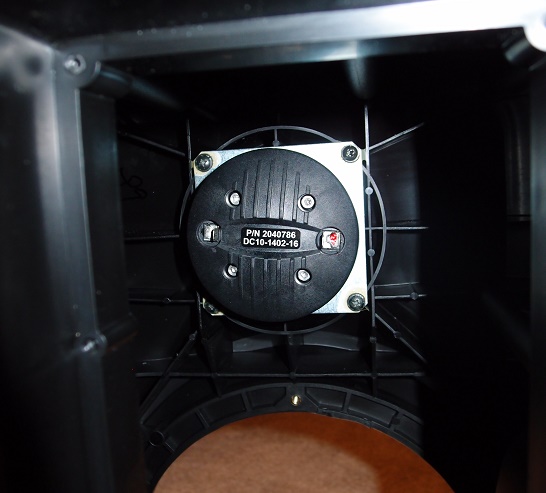

If you aren't quite up to DIYing ( for HT ) at this time ( that's alright ) go buy something ( from the pro-sound world ) that has a suitably sized ( 8 or 10") woofer with an @ 95db sensitivity.
The plastic boxed Mackie C200 does a very credible job ( in the home HT category ) for easy money.

That's clearly a Celestion compression driver ( very good quality ).

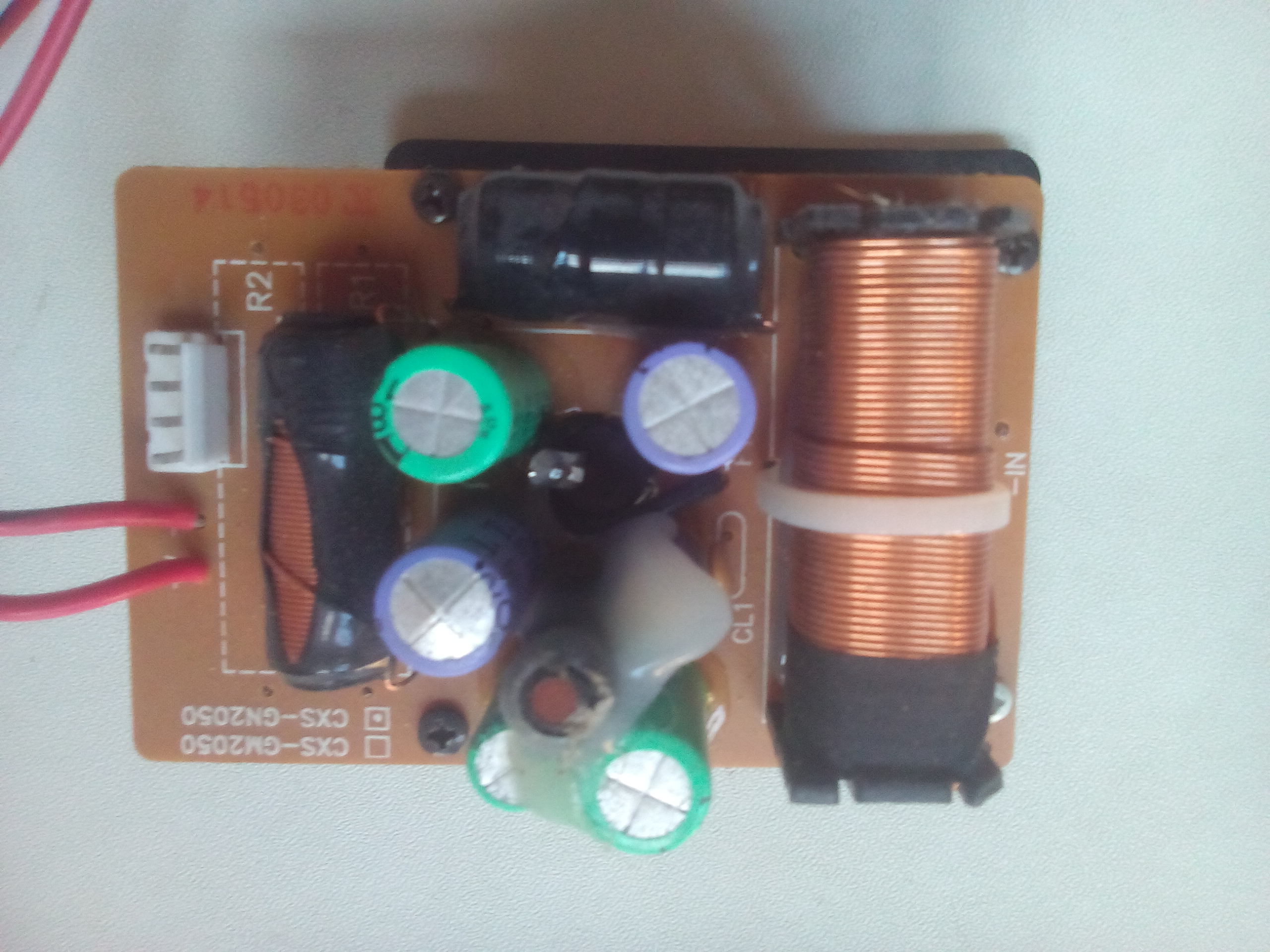

Before going any further you should document the existing crossover .
Take pictures of it in place ( if possible ), make notes of which wires connect to what, then completely remove one and draw out it's schematic .
Take pictures and measurements of the existing mids and tweeters ( show front & backs so that people can get an idea of their Q-factor.
Measurements of the existing midrange dog-house are necessary.

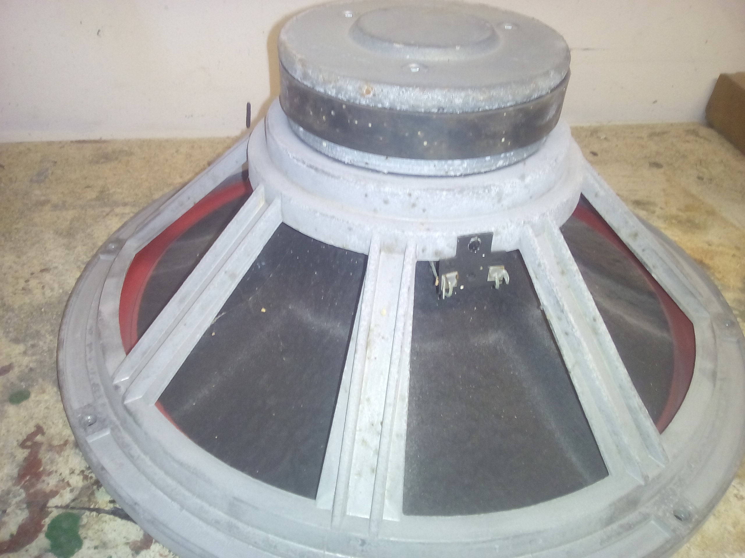

Finally got around to pulling them apart,bought some audax pro 170 mid range and ordered some audax TWO25A26 tweeters,can someone recommend where they need to crossover and a made up crossover or has anyone got a schematic for certain vega crossover CXS -GN2050 ,also can anyone suggest a alternative 15" woofer for these 6.75 cufoot boxes thanks in anticipation.

This pic is returned by a Google search for your woofer type ( & I assume its yours ).
It seems to show no midrange sub-enclosure ( which needs to be rectified ).
If you intend to use the existing enclosure you will need to find a way to retrofit a separate sub-enclosure into that cabinet.

Your Audax components are going to require a new/custom crossover.
I guarantee that the existing one is not applicable.
I think your best approach is to hire someone local ( maybe Falcon ) to design a custom network for your drivers.
Cross-over points ? @ 350hz ( for woofer to midrange ) + @ 3Khz ( midrange to tweeter )
