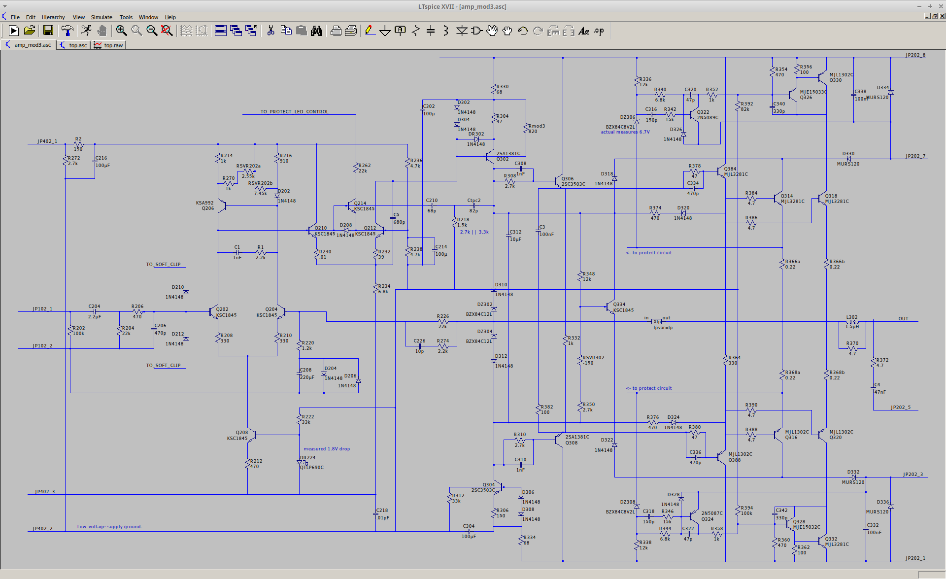

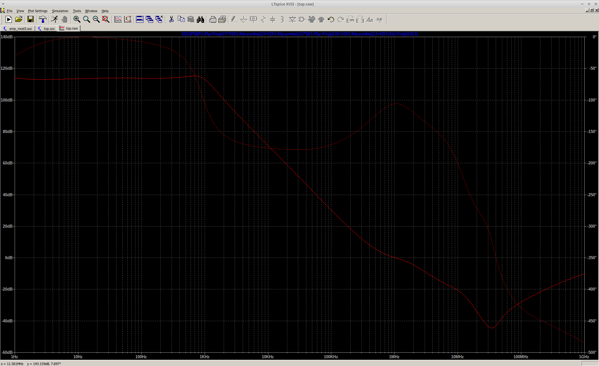

One more change! Now it's really final :-D
As in comment 6, this change concerns solving the ~1kHz peak in loopgain that can result from TPC.
I deleted the series R1=390k and C1=39p across the VAS transistor. It turns out that this arrangement depends on the beta of the VAS buffer, and we don't want to depend closely on any transistor's beta. Whoops.
That's OK because here's an even better arrangement. It loads the VAS less, it adds minimal load to the IPS (maybe less than before) and it's very easy to shape the loopgain plot and choose how much you'd like to reduce the 1kHz peak.
The new R/C pair at the IPS tail reduces loopgain a little bit, so I shrunk the IPS emitter degeneration resistors to cancel that.
This sounds better! (I think!) It sounded a bit nasal before, like there was some treble exaggeration. That's gone. I was surprised that this change was audible. Why was it audible?
The new R-C network reduces differential-mode impedance at the IPS tails, especially at treble frequencies. That could make the IPS less prone to pick up stray EMI from halfwave-rectified output currents. That's a guess. (The layout doesn't do as much as you'd like to isolate the IPS from halfwave rectified currents.) I can't quantify the benefit, but it can't hurt to lower IPS impedance at treble and above.
Final (haha) schematic and loopgain plots below.

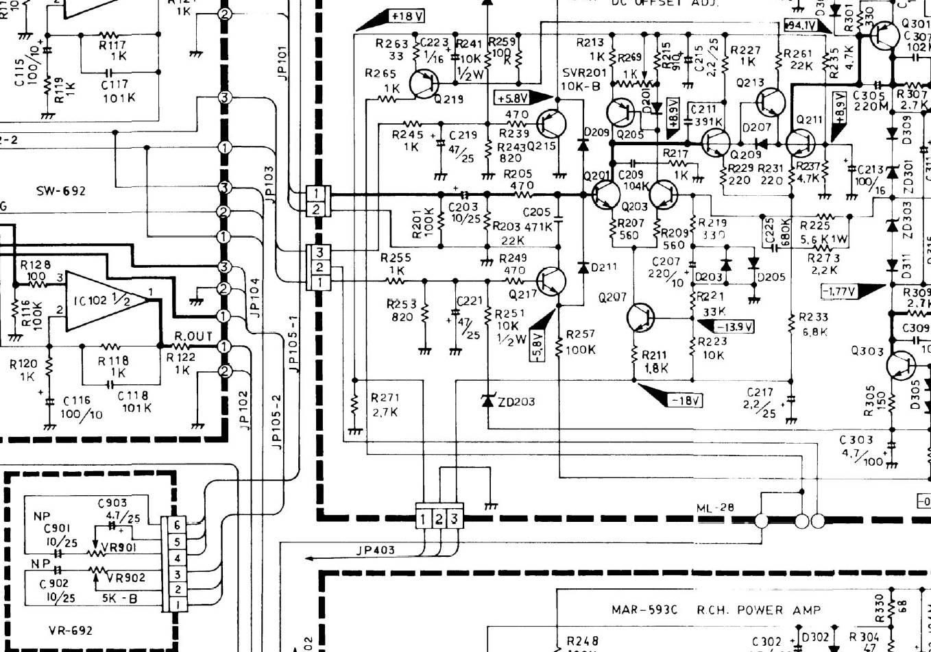

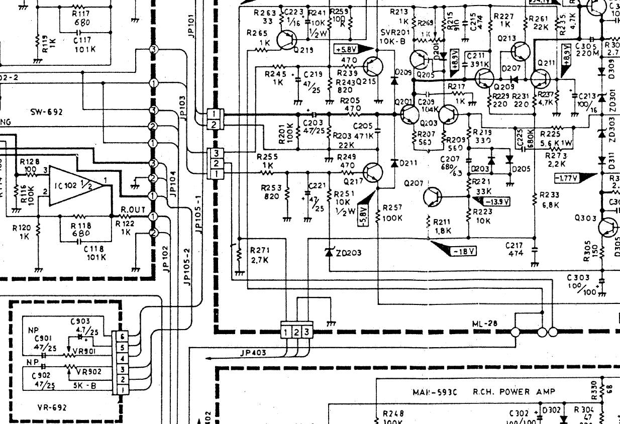

While doing some work on my 2600a I discovered there is no 2600a manual that I could find so was using the 2600 but there are some differences. The 2600a is a cross between the 2600 & 2700. Using only the L channel in these examples, C215, 217 are not there in the 2700 or 2600a. C310, 303 in the 2600 are 4.7/100 and in the 2700 & 2600a, 100/100. My 2600a has these glued to the solder side of the pcb. For better filtering I can see.
But especially C207 in the 2600 & 2600a 220/10 vs 680/63 in the 2700. And C901, 902 - 10/25 in the 2600 & 2600a and 47/25 in the 2700. C203, 204 - 10/25 in the 2600 & 2600a and 47/25 in the 2700....what effect on sound would they have? Would it be a good thing to change these in a 2600a to match the 2700?
