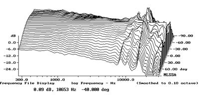

Why would a coaxial inherently have "lousy" pattern control? That makes no sense.This is why I don't approve of coax (except in space critical apps.) - no vertical lobes, but lousy horizontal pattern control.

What exactly is "lousy" about the horizontal pattern control?
I'm curious about this too. The coax drivers I know have the same vertical as horizontal pattern. How is the control worse than in the horizontal direction?
Look at these graphs. Same drivers. One 15" coax driver. The next with the same tweeter taken out and placed in a cheap WG from parts express. I'll do one right after the other in 11.25 degree changes from 0 degrees out to 45 degrees. I'm not saying this is going to be the case with all coaxials. I bet Genelec's don't do that and possibly even Tannoys'.

I wish the graph periods were the same, but I changed them b/c I can't measure Bass when gating anyway. I didn't realize the coax measurements I had were still w/ the different periods. The coax doesn't look that much worse overall than the cheapy waveguide, just different and much less smooth overall. Maybe it's a wash? The coax definitely sounds brighter in the room, and more diffuse. It's harder to pick out what's going on with the coax even though it's brighter.
What do you guys see?

A typically terrible coaxial speaker.What do you guys see?
Nothing inherent about the format (as incorrectly stated by Earl and Wayne, who sell non-coaxials) and everything to do with poor implementation/construction.
Still waiting on comments on the data I posted...and what is "lousy" about the pattern control...as well as listening panel subjective perception of this "lousy" control vs "not so lousy" control (JBL/Summa), in an actual living room, rather than cyberspace speculation and chatting.

I see the cheapo waveguide holding constant-directivity pattern control in the highest octave and the co-ax having essentially none.What do you guys see?

Take a look a a UREI Coax. On axis great, horizontal OK. Vertical is terrible. You have to be right on axis. I use an 811C as my center channel in my HT set-up.
