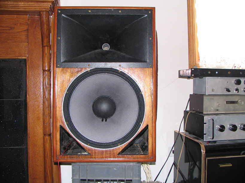

Here's a frontal photograph of one of the Iron Lawbreakers with the woofer grill panel removed.
It is easy to see that the center to center distance between the 15.25" diameter bass driver and the horn throat (non diffracting but not HOM optimized either) is less than the diameter of the bass driver itself.
To minimize vertical lobing as much as possible and to try to gain the advantage I described earlier with floor and ceiling reflections, the electrical xover point is set to ~550hz which is lower than normal for this type of horn without the use of high order xovers. However, by adding a xover zero around 300hz (modified elliptical type), both a rapid xover rolloff starting above the ~400hz acoustical cutoff of the horn and a decent approximation of a first order xover phase transition is achieved, when the setback of the 288 G HF driver compared to the 2220A woofer VC and LF quasi first order xover is considered. Without the 300hz notch (i.e. with a straight first order HP xover to the 288G), its audible distortion at higher program levels becomes significant.
It so happens that near this xover frequency, the disperson of the 2220A is beginning to narrow, so a reasonably seamless horizontal as well as vertical integration of each driver's polar response is achieved.
