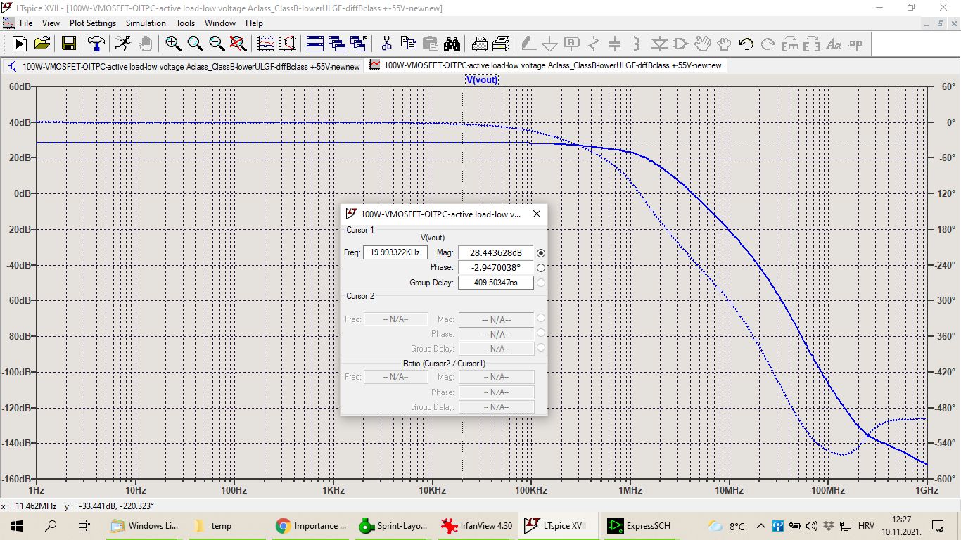

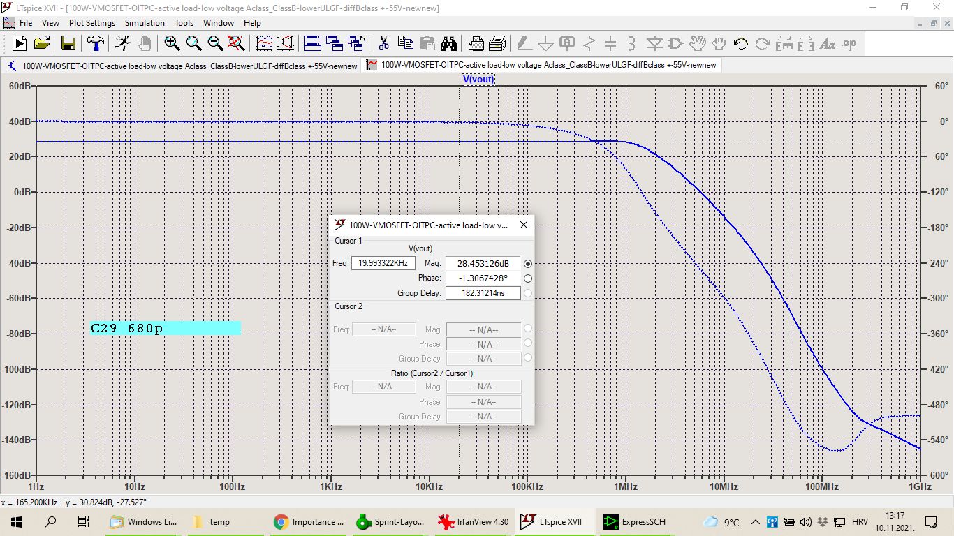

The closed loop phase response of both of these amplifiers is exemplary - I can’t zoom in , but my guess is it’s less than 1-2 degrees at 20 kHz.
The loop response I’d a different thing, and there you get the typical saddle arising from TPC or TMC. I don’t think this has any baring on ‘sound quality (ok, that’s my opinion 🙂 )
Re closed loop phase response, people agonize over it in power amps when the electro-acoustic part of the chain (recording side and pickup cart if you are using vinyl) and then the speaker side is spread over orders of magnitude more than an amplifier.
Basically, it’s a non-issue IMV.

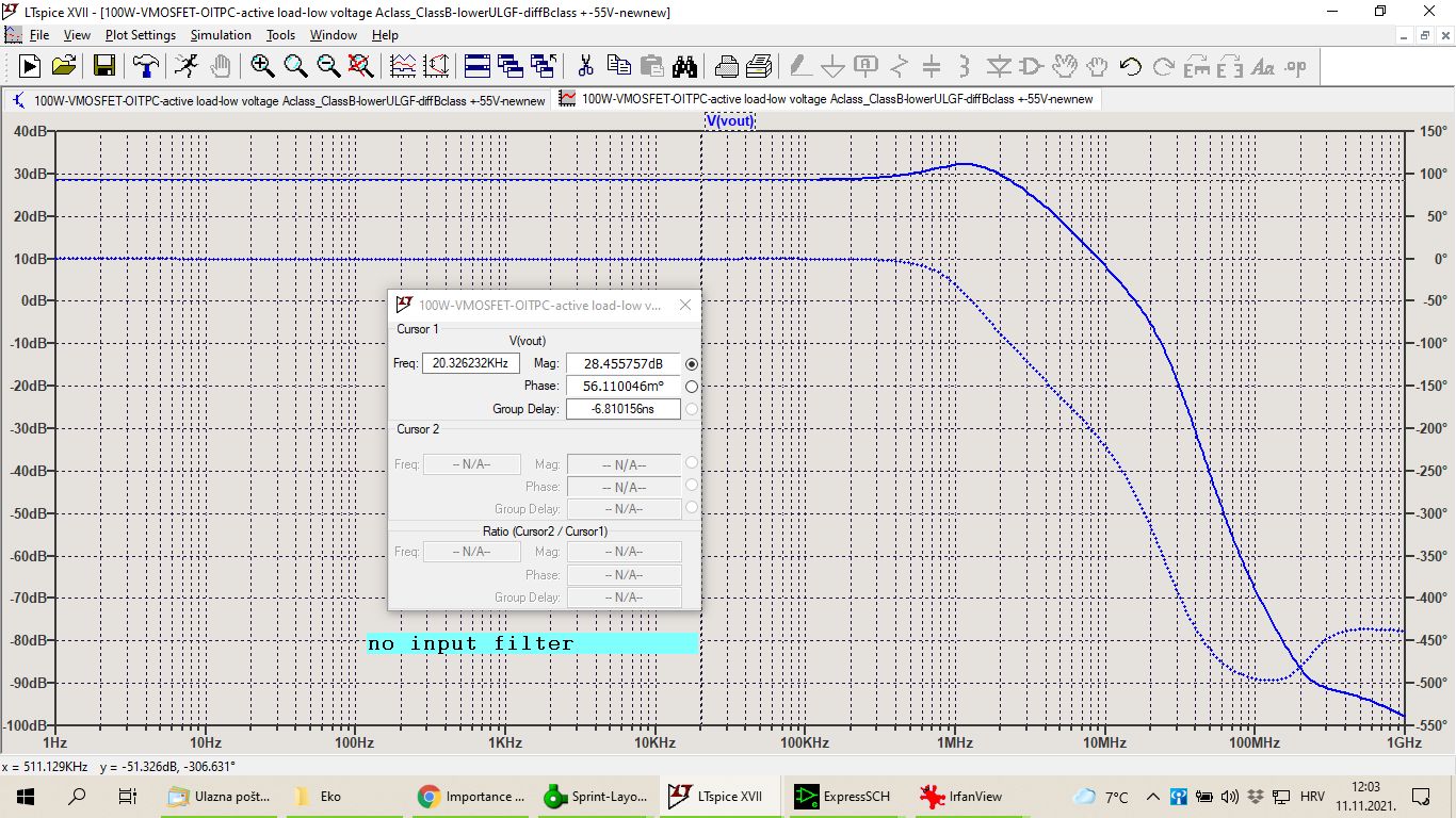

CLG plot of an amp with TPC or TMC has typical increase in high frequency, in this case at cca 1 MHz and phase response at 20 kHz is defined solely by input filter.
attached CLG plot with no input filter.
PS why you can't zoom in?
