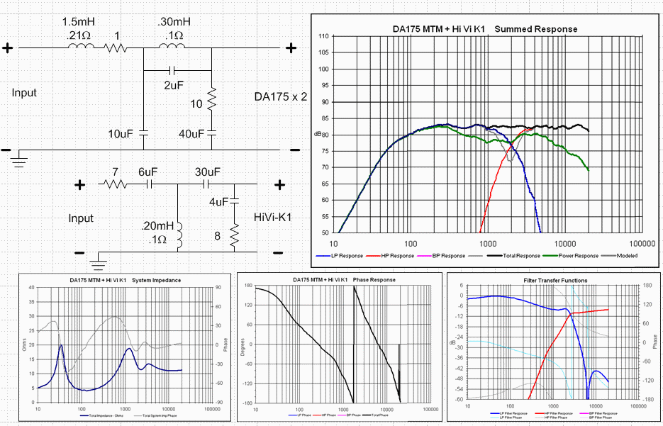

Patchwork,
I'm sorry I didn't realize you requested this until now. Below is the crossover and drivers. One tweet, two mid woofers. They go into a box very simular to the aluminum MTM at Parts Express except the enclosure is sealed. Got the crossover parts from Madisound and Parts Express.
The have great sound and imaging. Let me know if you are interested in more details. Remember, the magic is in the crossover!
