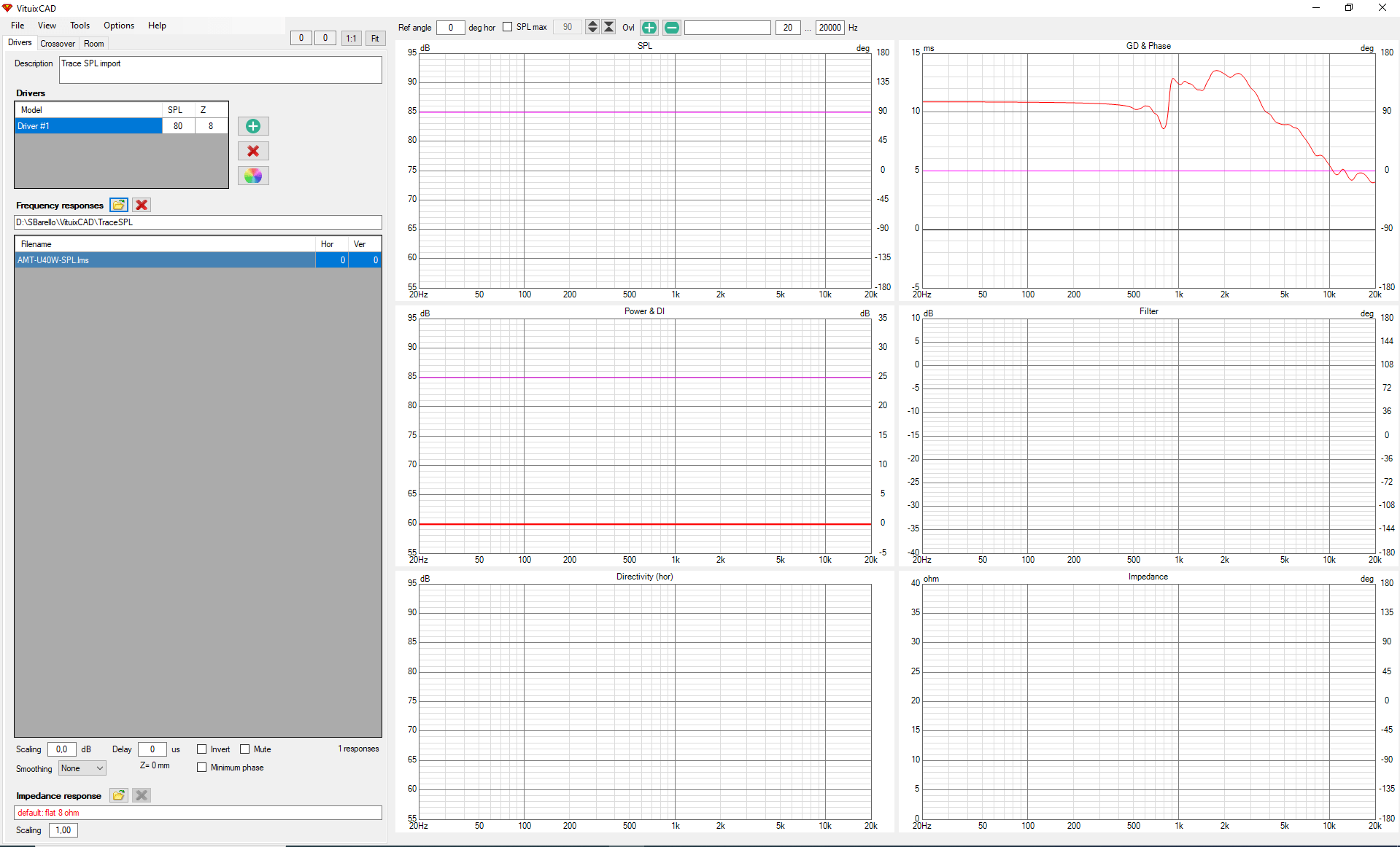

1. managed to open the Trace SPL tool and obtain the SPL and impedance files from screenshots of the measurement curves

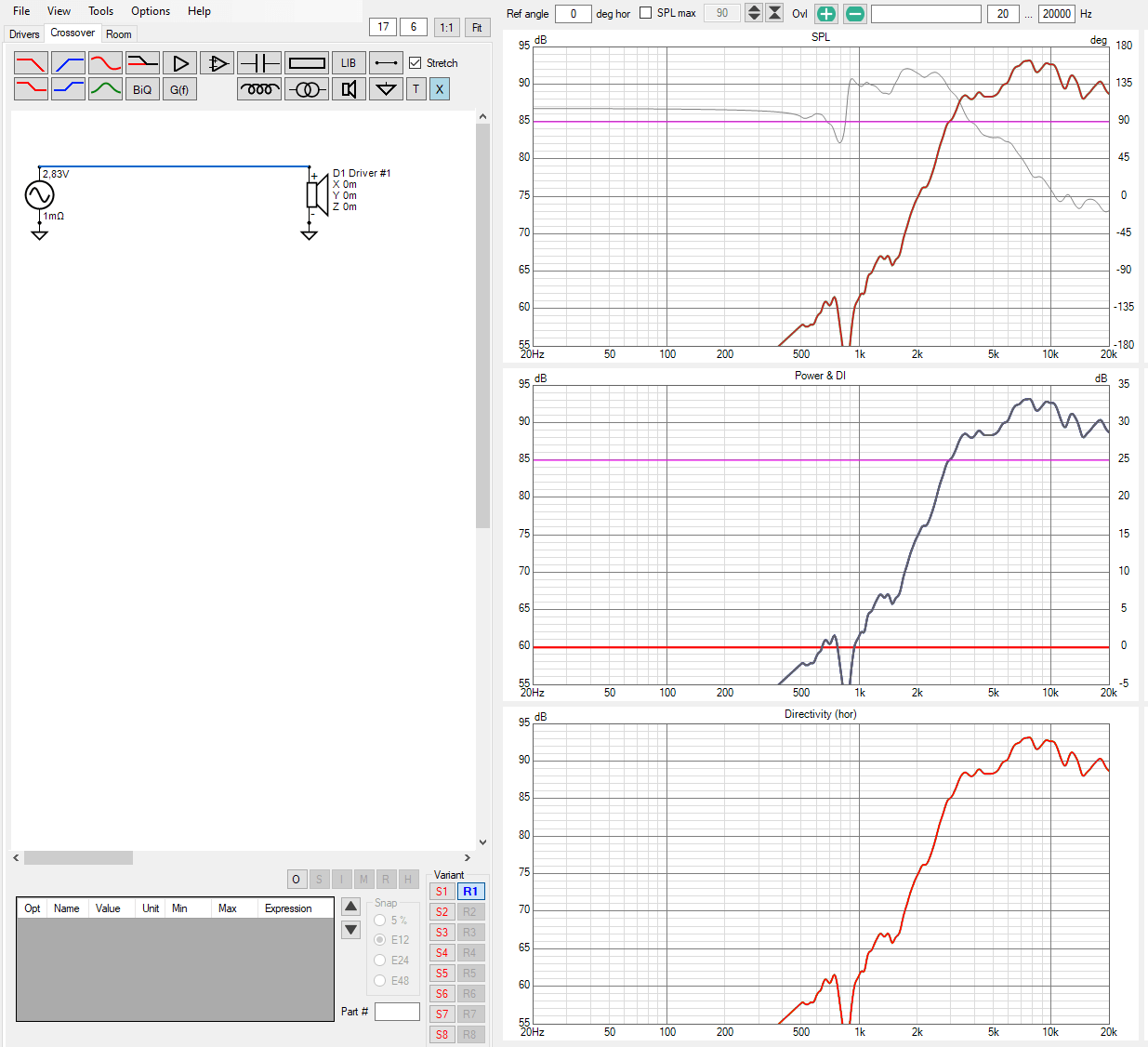

2. opened VituixCad2 empty project and tried to import the stuff from 1. for the driver and get all the time the curve imported here - obviously wrong:
i just want to get the values imported in the correct graph for the on axis frequency plot and not in the group delay and phase graph... should be a piece of cake - embarrassing to have to open a thread for this - sorry!

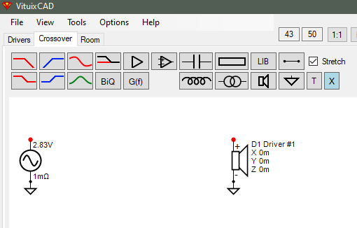

Program opens like this to show as clearly as possible that something is missing:

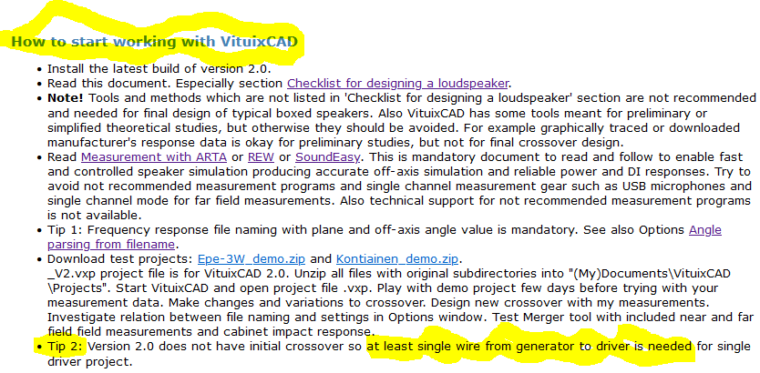

If that does not wake you up, user manual tells:
This happens few times a year so you're not entirely alone. I have not added the wire because next group of users would drop the first component on it and ask why it does not work. It's like a test: pass the entrance exam or look for other tools.
