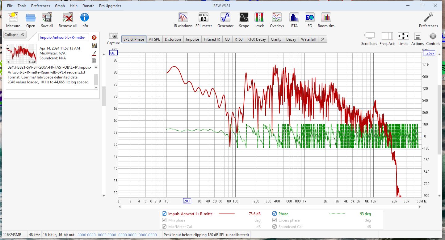

REW do not like the format, frequency graph values of the impulse response import from Clio pocket to Room EQ Wizard works like a charme

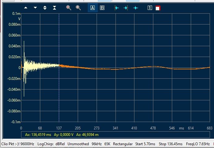

Hi all,
there is an option in CLIO itsself, you need to display the measurement this way
then save as WAV file directly, no export needed
then there is no problem to import thew time data in REW

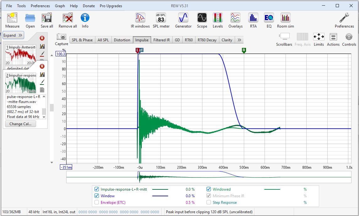

sorry for the stupid question - problem does not exist at all since the WAV from CLIO works well for the import in REW
