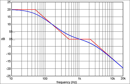

The RIAA standard does not have any cut at low frequency.as the RIAA standard they already are doing drastic cuts at low freq.
I'm pretty sure I remember it having -18 DB in the low freq range. That's quite a cut. Will pull up the freq curve in a bit.The RIAA standard does not have any cut at low frequency.
You remember wrong. It is flat from DC to 50.05Hz, then 6dB/octave LPF to 500.5Hz, then 'flat' to 2122Hz, then 6dB/octave LPF forever. See the graph above.I'm pretty sure I remember it having -18 DB in the low freq range. That's quite a cut. Will pull up the freq curve in a bit.
You may be thinking of the obsolete IEC amendment.
Ok so sorry yes maybe I mixed it up.
So its obvious that I need a low pass filter. (I see my old posts where I kept calling it a high pass filter.) Its not its actually a low pass filter.

If you're talking about rumble you need a highpass filter. You don't need to worry about > 25kHz as a low pass filter is already in place from 2122Hz, so you are already < -20dB at 25kHz. Unclear what you're really asking here.
So I need a rumble filter if I plan to use Phono. at any point. With a matching RIAA filter.If you're talking about rumble you need a highpass filter. You don't need to worry about > 25kHz as a low pass filter is already in place from 2122Hz, so you are already < -20dB at 25kHz. Unclear what you're really asking here.
Then I need one filter to make sure that Freq below 20 Hz do not enter my system.
Then I need one filter to make sure that Freq above 25Khz does not enter the signal.
I don't understand your comment that low pass filter is already in place from 2122Hz.
Im looking at all the boards I have plus those I want to design and none of them seem to cover all the bases I need covered.
I repeat. The RIAA curve is already a low pass filter from 2122Hz upwards, so by definition it is already at least 20dB lower at 25kHz than it was at 2122Hz, which is already nearly -3dB from what it was at 1kHz. See the graph above. Why isn't this enough? Why do you think you need to filter again from 25kHz? What is your requirement?
Ok understood your point. Its the way my mind works. Im planing the project in blocks as in first build the opamp preamp then add tone. Then at a latter date add on RIAA or a RIAA section . I try to break down projects into blocks and attack them one at a time. That is how my Akai AMp is designed i.e. phono only kicks in when you use Phono input. Without it its just your tone control. Sorry about the confusion.I repeat. The RIAA curve is already a low pass filter from 2122Hz upwards, so by definition it is already at least 20dB lower at 25kHz than it was at 2122Hz, which is already nearly -3dB from what it was at 1kHz. See the graph above. Why isn't this enough? Why do you think you need to filter again from 25kHz? What is your requirement?
