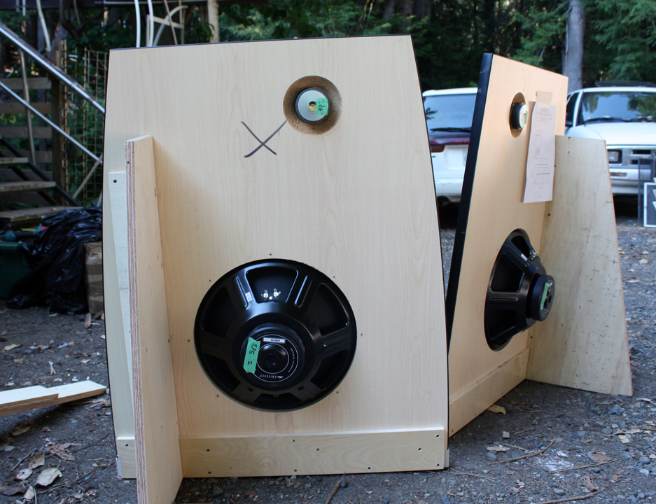

We did a version of the MJK passive baffle with the FF85k and Eminence Alpha 15. The FF85 worked wnderfully, i was not so thrilled with the woofer.
As Jeff suggests, both woofer & midTweeter should be OB, or both be in a box.

Baffle was made of a surplus meeting tabletop cut in half.

I would recommend Open Baffle for the FF85k with a crossover placed a bit higher, e.g. 500Hz, then support with ML-TL woofer to give best of tradeoffs concerning bass impact, size and room placement.
IIRC the MJK passive OB crosses the midTweeter over at about 450 Hz. It works well and th espilt XO deals with the baffle response.

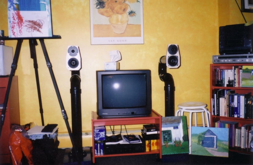

The 'baffles' on these pipe monsters I built for a friend ca. 2000 (MLTL, although I did not know this term back then) were hacked from melamine kitchen top. Woofers are modified vintage Radio Shack 40-1197 with added mass and white glue coating (carefully avoided the fabric surround). Surprising amount of bass in a small appartment! Tweeter heavily padded down so efficiency is best studied by speleologists...
