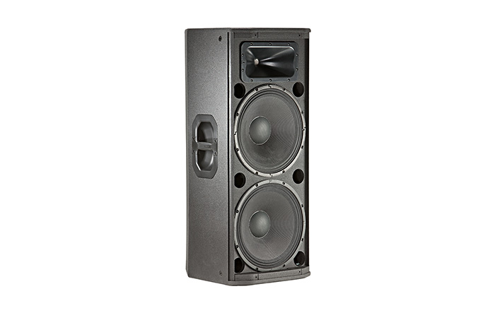

"Argument" that 16-ohm models are designed only for twin PA cabinets is the same as the identical "argument" that 8-ohm models are designed only for twin PA cabinets, making 4 ohms. Picture of JBL PRX425, nominal impedance 4 ohms:

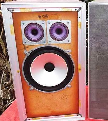

Don't be put off, simply wire 2 tweeters in series, one facing forward and the other facing upward for greater ambience. It might work to your advantage.

I'd guess a 16 ohm version is not the end of the World. As Tweet says, there is an option to wire two 8 ohm tweeters in series to keep to 16 ohm. My own favourite solution is a cone tweeter with an 8" bass.
But to match impedance, it is not unknown to double the tweeters. TBH, I'd align two tweeters vertically rather than horizontally. But Harold Leak knew what he was doing. Thing is, that a flattish impedance is a good thing, IMO. Gives an amp an easy life.
