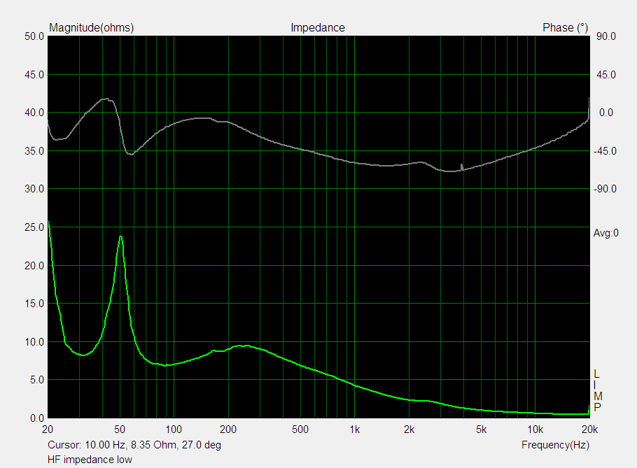

I have just finished a 3 way tarkus style but with woofer Peerless P830667 , Mid Peerless P830875 and Tweeter Scanspeak D2608 91300.

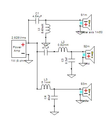

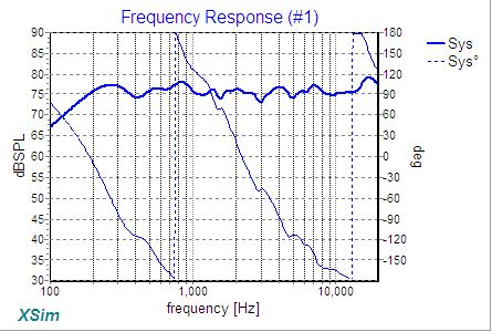

Before passing on to listening test, I checked the impedance and found that the impedance is very low at the high end. Have double-checked all components, wires and connections and also swapped a new tweeter but still the impedance is the same. Enclosed are the measured impedance using Limp, the simmed impedance, the FR response and and simmed xover using XSIM. This is driving me crazy. Can anyone explain where is the fault?

I have found the culprit. I did not think of opening the separate bass enclosure before.

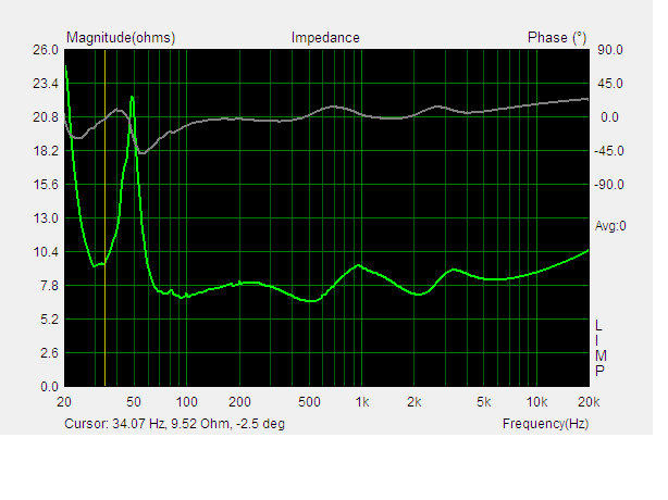

In fact when I simmed the bass part of the xover and had an impedance sweep with only woofer connected I found that the HF portion of impedance remained identical as before. Upon examining I found that cap C4 was soldered before the inductor L3 causing short to ground. tks to you all for pointing me about a shorted cap to gnd. Here is the updated and correct impedance sweep. Now on to listening tests!
