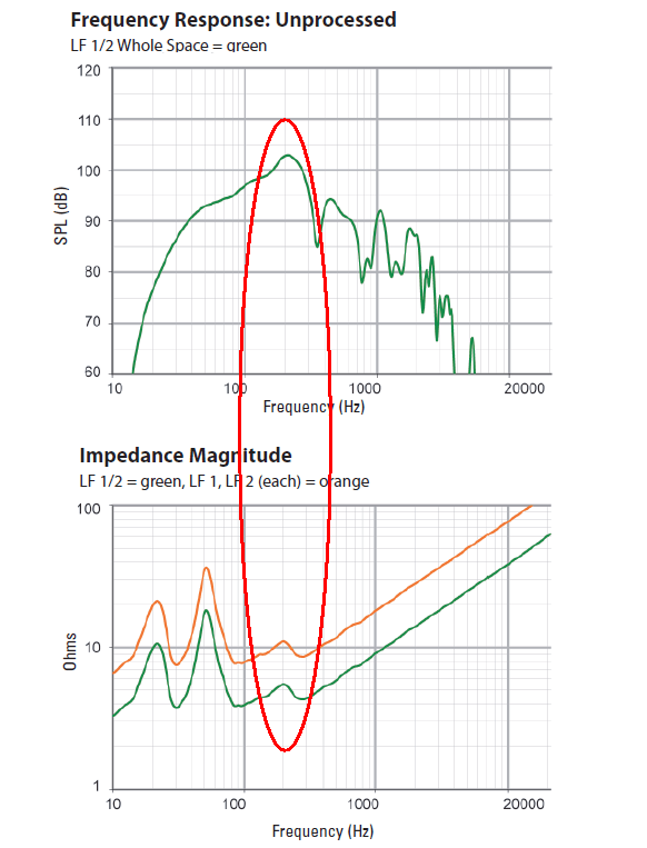

To add a little bit more to Galu's succinct summary of the basics, when a horn acts as an acoustic transformer, it effectively gives the driver something stiffer to push against.
That typically results in the Electrical Impedance of the system increasing as well.

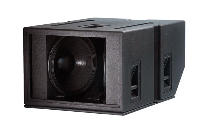

One example I like to illustrate this is EAW's SB1000 series of subwoofers. They are technically Bass Reflex but have the drivers mounted on angled baffles, which creates a flared cavity at the front of the box.
Helpfully, EAW also publish unprocessed frequency response graphs and impedance curves for these.
We can see that at a narrow range of frequencies, corresponding to where the depth of the cavity is about 1/4 of a wavelength, the cavity is providing acoustic gain (the hump in the frequency response) and a matching increase in the electrical impedance.
Hope having a real world example helps a bit.
David.

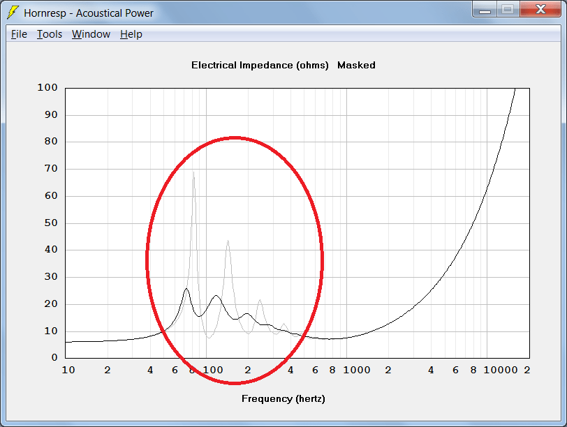

Your graphs would appear to indicate that the electrical impedance of the loudspeaker is not only dependent on mechanical and electrical factors, but also on the acoustic impedance seen by the speaker diaphragm.
The attached chart compares the magnitude of the electrical input impedance of an exponential horn loudspeaker radiating into free space (grey trace) to that of the same loudspeaker radiating into eighth space (black trace). The only input condition that has changed is the acoustical impedance loading the front side of the driver diaphragm.
The chart results show that the electrical input impedance is reduced when the acoustical impedance is increased by switching from free space to eighth space.
This is because:
Zem = Bl ^ 2 / Zm
Where:
Zem = Motional electrical impedance
Bl = Driver magnetic flux density x voice coil conductor length
Zm = Total mechanical impedance
It can be seen from the above formula that for a constant Bl, increasing Zm, which includes the total acoustical impedance Za (Ra + j * Xa) converted to mechanical impedance, will reduce Zem (Rem + j * Xem), which forms part of the electrical input impedance Ze.
Zm = Rms + Sd ^ 2 * Ra + j * (w * Mmd - 1 / (w * Cms) + Sd ^ 2 * Xa)
Ze = Re + Rem + j * (w * Le + Xem)
