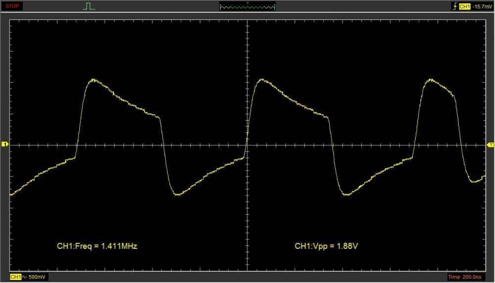

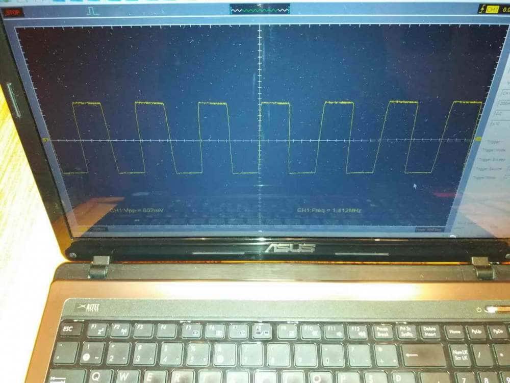

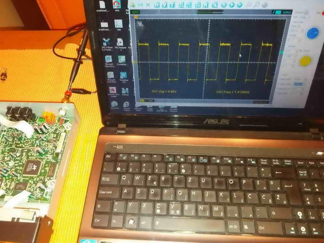

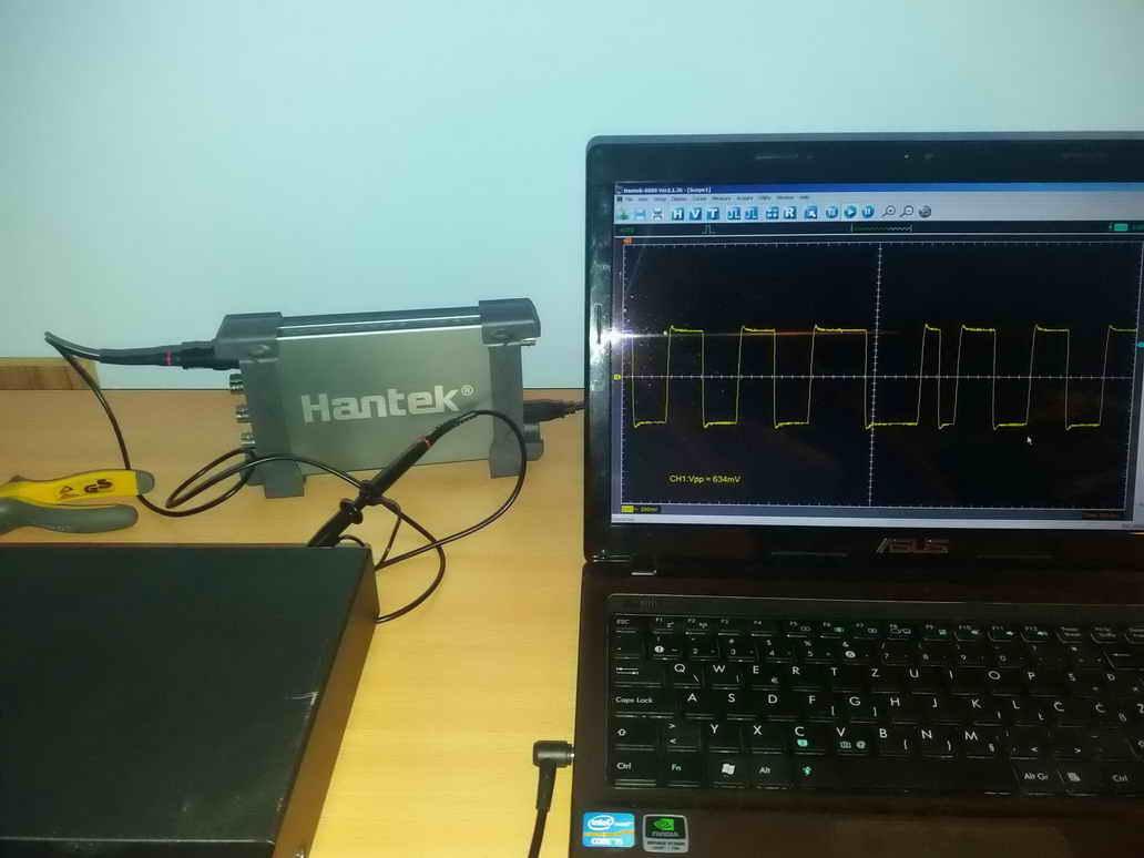

I measured SPDIF signals a couple of times, various cables, various lengths, RCA and BNC. I didn't notice any reflections even with the 50ohm BNC cable that came with the oscilloscope. I think SPDIF has too low frequencies and too long wavelengths for that.

As far as I remember, sampling rate 192kHz corresponds to SPDIF frequency of 12.3MHz, and 44.1kHz to 2.8MHz. I only measured at 44.1kHz and there the wavelength in a typical coaxial cable is over 50m. The exact values of the wavelength or the signal propagation speed probably depend on the insulation material of the cable itself.
And I also measured with very short cables of 30 cm, there are no visible reflections.
What can be seen is that different CD and DVD players have different forms of signals at the output. Some are almost pure squares, and some have very irregular distorted signals. And it all works somehow. 🤔
