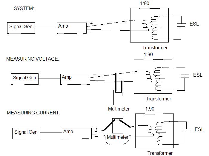

I have been trying to measure the input impdeance of my transformer's primary with my DIY ESL connected at the secondary. I am using a signal generator and a digital true RMS multimeter to measure the input voltage(Vrms) and then the input current(Irms). I then calculate Zin=Vrms/Irms. As expected the impedance has fluctuated wildy with frequency from 120 down to 0.3ohms.
What wasn't expected is the variation of the input impedance with the input voltage and power level. At low frequencies the input impedance appears to decrease quadratically with increasing input voltage. I have gotten similar results at several low frequencies. At high frequencies the input voltage and power doesn't seem to have an effect on the input impedance.
Anyone have any explanations on this behaviour?
Pete
I've never attached a picture before but hope this works.
I'm a little suspicious of internal resistance or something the multimeter may change?

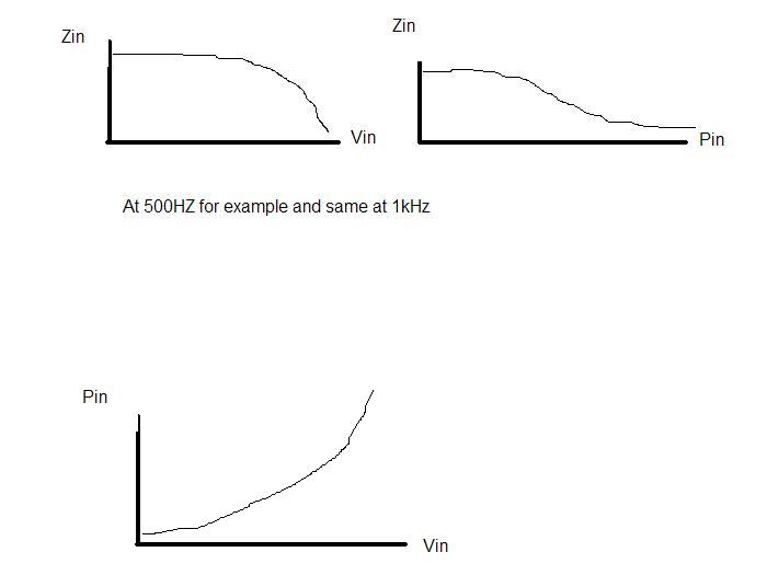

Here is another sketch showing the trend in impedance as a function of input voltage and as a function of input power. I also included a sketch of input power as a function of Vin since it wasn't immediately obvious to me that the two graphs agreed.
As you have discovered the impedance at any given frequency is a function of many factors. I THINK the variation with power that occurs at low frequencies is because the amount of power coupled to the air is a larger (smaller?) fraction of the total power dissipated. You are not the first person to have seen this behavior. The attached image is from the Quad ESL-63 service manual.

The meter has a precision resistor inside it (called a shunt, used when measuring current), so the only reason to use an external resistor is if your meter is more accurate at reading voltage than current. I would not expect the resistance of the shunt to change during your tests.

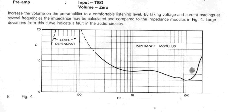

I was not confident with my results because the amp I use has two 32Vrms secondary windings giving rails of about +/- 45VDC which should mean the maximum Vrms measured at its output was 45/sqrt(2)=32Vrms(unsurprisingly!) but I got a reading of 44Vrms??? Any ideas?
This variation with power level makes it very difficult to design an amplifier for low frequencies since I don't know the impedance it will drive. If the impedance trend continues as voltage increases the impedance will be very very low with the voltages I am planning to apply.

Much of this difference may be something simple like your meter changing ranges- that causes the internal resistance of the meter to change. The quasi constant current method (using a constant series resistor) avoids those errors and is much more accurate.

I HAVE A THEORY!
As I mentioned in a previous post I was getting more RMS voltage than I should be able to obtain with the voltage rails and a sine wave. This must mean the amplifier is clipping and producing something closer to a square wave. This would create high frequencies and hence these would see a low impedance and draw larger currents. The more I increased the voltage the more clipping and the more current. Hence I detect a falling impdeance as voltage is increased!
However I have detected similar(but slightly more moderate) behaviour with an amplifier with high enough voltage rails.

A valid question.
I have always been curious, and ever so slightly uneasy, about the label applied below 200Hz on the impedance curve of the Quad 63 that reads “level dependent”. I have not satisfied myself as to why this non-linearity exists to a significant enough degree that Walker felt it necessary to call it out. Here are some possibilities, thrown out without a lot of analysis or research on my part:
1.) Mark, with your “turn off the bias” comment, you seem to be implying that constant charge assumption may no longer be applicable, and that diaphragm charge is varying with signal. Maybe I’m reading too much into what you said. But perhaps the 10M series HT resistor and neon bulb plus the diaphragm resistance is not enough resistance to meet the 2fRC>1 criterion at these bass frequencies. This seems plausible. Still the Quad’s bass seems very clean to me (at least up to a limit), compared to the many significant non-linearities of moving coil bass cones.
2.) The input impedance due to primary inductance of the step-up transformers drops gradually below 200Hz. The secondary is lightly loaded and the input current is a non-linear function of voltage due to B-H non-linearities. Perhaps if driven by a true voltage source amp, much of this factor of impedance non-linearity is not transferred to the air.
3.) The intended operating range of ESLs is where the radiation resistance exceeds diaphragm stiffness reactance (due to stretch or springiness). Think of a series RL circuit. As frequency decreases, stiffness reactance starts to become comparable to and then exceeds the radiation resistance. The stiffness reactance of a stretched plastic film is bound to be non-linear, and the linear radiation resistance gives way to this non-linearity at low frequencies. The effect would show up in the impedance curves, as well as in the airborne response.
4.) Mark, you said “I THINK the variation with power that occurs at low frequencies is because the amount of power coupled to the air is a larger (smaller?) fraction of the total power dissipated.” I don’t see how radiation loading by itself is a non-linear function, but perhaps you were thinking of these other factors.
So, I don’t know which of these is at “fault”. It could be that more than one of these factors is at play at once.

I've been thinking about this too. I can't remeber ever seen a review where the impedeance varies with signal ampitude, except for the esl63.
One other datapoint though. Baxendall writes in "Loadspeaker and Headphone Handbook" describing the esl57s sound stepup transformer:
"The loading choke...will also be ignored. It consists merly of of a few shorted turns round the transformer core and its pupose is to reduce the magnitude of the input impedeance peak that occurs somewhere in the 100 Hz region - thr actual frequency is very dependent on the signal amplitude"
What would be intresting is if there is other esls known that does not have these impedeance variations.
örjan
Interesting. To my knowledge the ESL-63 has shorted turns only in the delay line inductors, which I believe to be air core, but not in the step-ups. I would be surprised if other ESLs do not exhibit this impedance non-linearity. Walker was just more honest. And ingenious.

Try this, bub...........
Put a large resistor......say 1 K between your amp and the transformer. Measure the voltage on either side. Figure out the ratio of the two. Mutliply that number by 1K. That will give you a reasonable impedance number. This way, you don't have to measure current, variations with frequency should be negated, as you will be making 2 measurements at all frequencies. As long as the series R is larger than both the amp and load Z, you won't have to do a lot of math.
