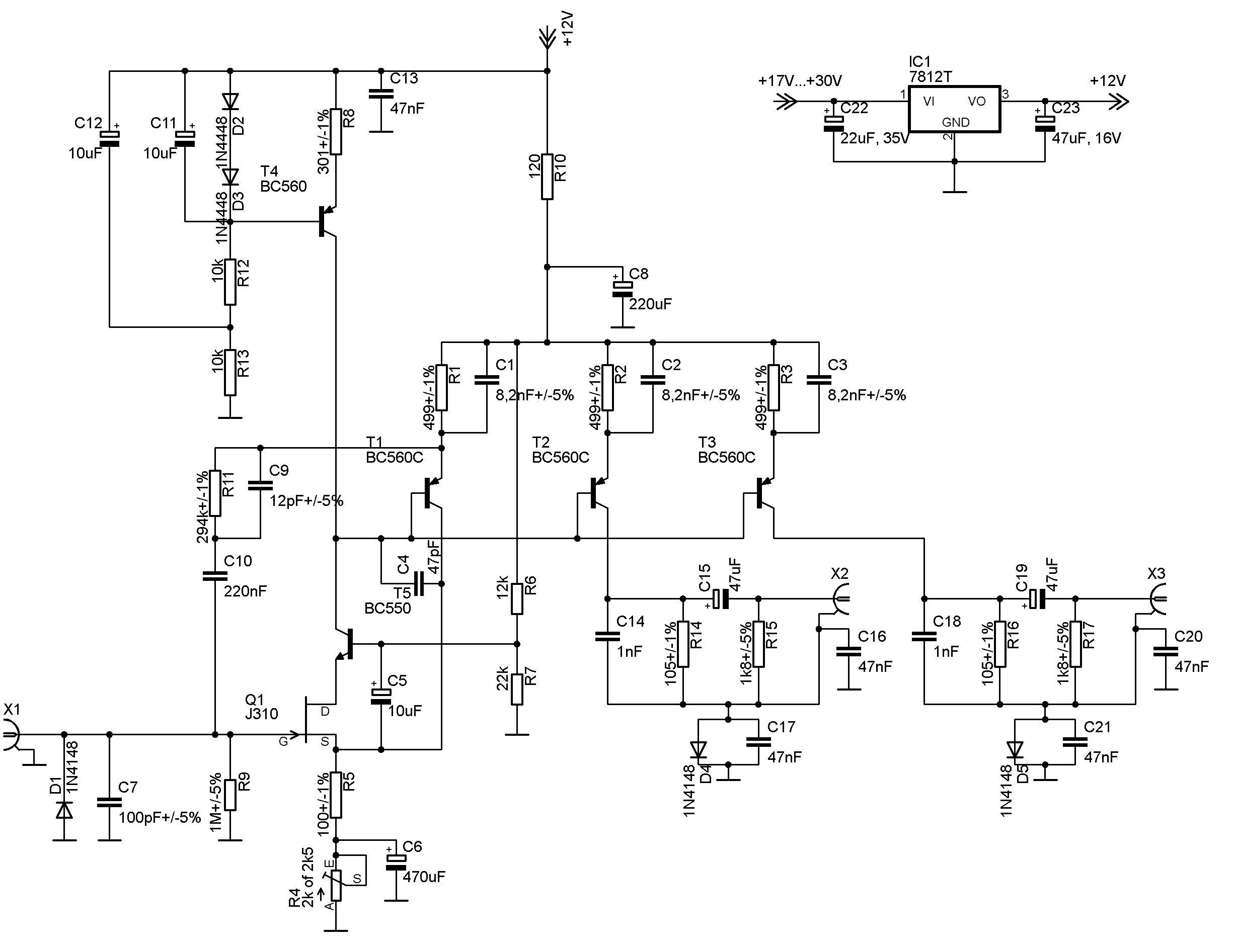

This is another solution, a distribution amplifier designed specifically for moving-magnet phono signals. Its 47 kohm input resistance is realized with a combination of series and shunt feedback. R4 is to be adjusted such that there is about 1 V DC voltage across R1. Q1 can be a J308, J309 or J310. The 7812 can supply four channels without cooling.
