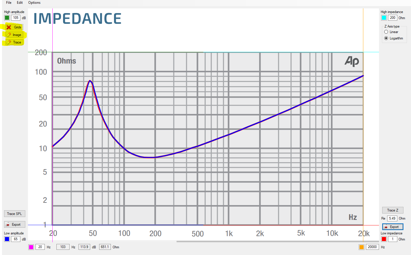

if you wouldn't mind, I really need some/your help, please. I am trying to trace the impedance curves for Eminence Beta 12A and Fane Sovereign 12-300 but, no matter which software I've been using, (vituixcad, spltrace and another one whose name i can't recall now) couldn't get it right. could anybody help me, please?

Use the Tracing tool in VituixCAD .
It's by far the best ( the rest aren't worth the effort ).
VituixCAD also creates + exports a phase trace that's lacking in most others.
Learn to use its extra 3 picture tools which are found in the upper left hand area of the window ( highlighted in yellow in my posted pic of the FANE 12 ).
For the first pic that you posted, you'll need to use the "Grid Removal" tool ( since the impedance trace is the same color as the grid ).
The second pic that you posted is for a Fane 10" ( btw ).
- In the 2nd pic there shouldn't be any problem getting a clean trace when the printed trace is such a different color ( red in this case ).
- Maybe it's in your setup ( see my pic as to how to get this to trace properly and spit ought good numbers ).
I'll post files tomorrow if you can't get it together by then ( learn how to fish, etc. etc. etc. )

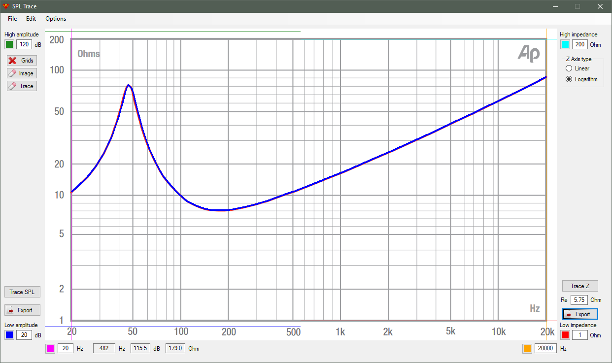

Settings for ZR tracing Fane with VCAD2. Note that Re is entered after tracing, just before clicking Export ZR.

Settings for ZR tracing of Fane with VCAD2. Note that Re is entered after tracing, just before clicking Export ZR.
Thank you! I got it now! I had to set the Z axis on Logarithmic.
Thank you all! My problem was the Z axis which was set as linear instead of logarithmic.
