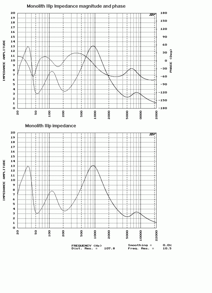

I am trying to build two mono block amps specifically designed for the ascent i's but need an Impedance Curve vs. Frequency diagram. Does anyone have or know of one that has been published? I tried the ML site, but the Ascent i's are no longer posted there.

This is one for my Monolith III may be similar from the upper bass up.
Contact Jim Power @ Martin Logan he is very helpful he sent this to me promptly.
