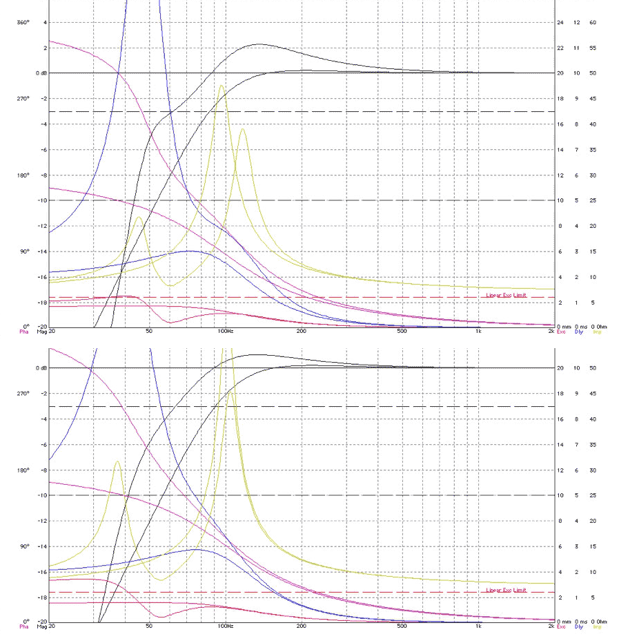

Since you can't seem to get it thru your head that the measures are for the same individual driver, i have attached is a 1st pass sim. With my measures it takes 40 litres to get a sealed box Q of 0.8 (top graph). With Mark's 10 litres. The other sim is 13L vented (something we have built many of and know work very well). I fiddled with the tuning to get the nicest shape i could (i know how to loose the bump in the curve using Mark's number).

The reason I can't get it through my head is because you said it's ESSENTIALLY the same driver, not the same driver.
Unless he measured it and mailed it to you it's not the same driver. Probably not the same production run, and subject to probably 10 - 20 percent natural consistency variation.
And measured by two different sets of equipment under completely different conditions. THIS IS USELESS DATA for what I want to do, which is exactly what Bagby described doing.
If you have measured thousands of drivers and over 200 of this exact model of driver and you have measured some of the same exact individual driver several times why can't you just give me what I'm asking for instead of this data of two completely different (essentially the same, lol) drivers?
If this issue of drifting t/s parameters was as prominent as you say I'm sure you would have done comparisons to show the effect and you should have the data I'm asking for onhand for just this purpose. The sims you posted above just show natural t/s consistency variance in drivers from different production runs, not t/s parameter shift due to differing drive levels in the same driver.
But as Bagby (and many others) say, and as compression measurements show, this drifting in and out of tune simply is not an issue.
I measured many, choose a very closely matched pair and mailed the pair to Mark. I say essentially because i don't know which of the pair he measured. My data is for the average of the closely matched pair (near identical T/S), Mark's is for a single driver from the pair.
For the FE127 the unit-to-unit variation is on the order of plus/minus 15%.

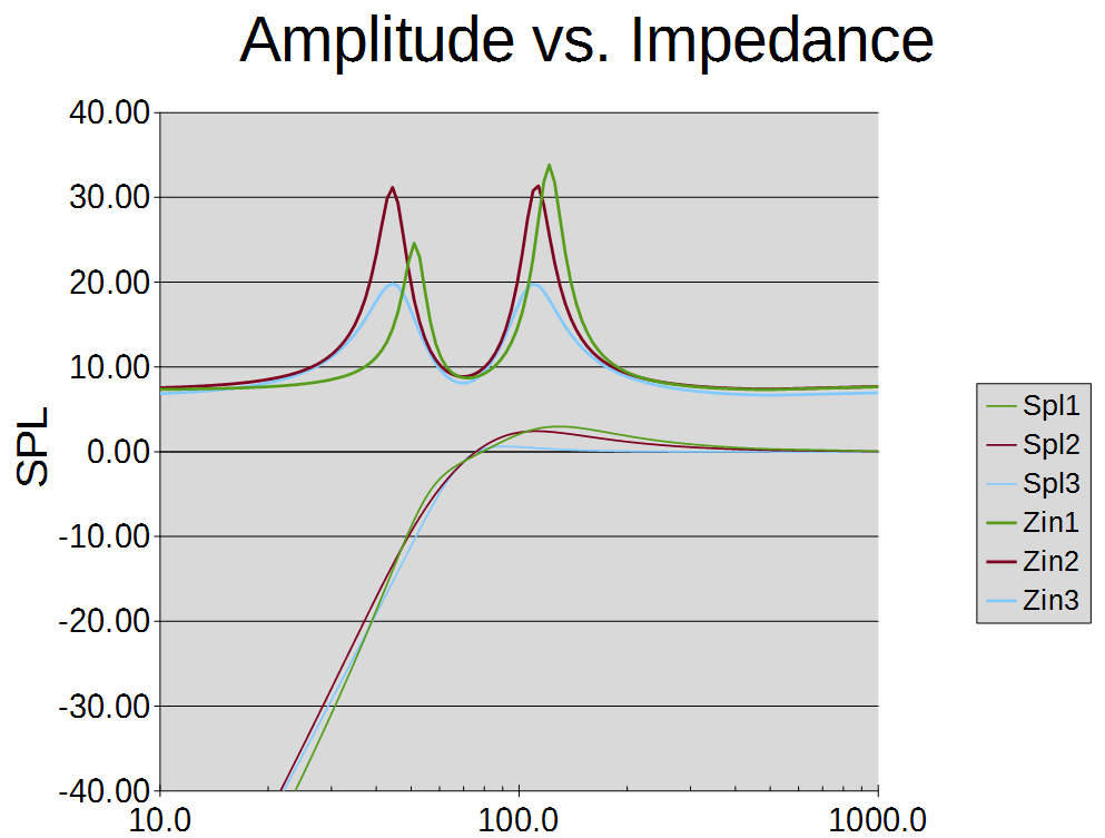

For planet10 - your example doesn't really have much to do with significant changes in parameters causing frequency response changes at different powers. Your data is not sufficient to make a case yea or nay.
A graph of your three parameter sets. I designed a roughly maximally flat box (didn't run any numbers, just off the top of my head used 12 liters and 70Hz tune) using the factory specs, then used the other two sets in the same box.
1st set, your specs
2nd set, the LEAP specs
3rd set, factory.
Note very little difference between yours and mark's, mostly less than a dB. Then note the factory...
