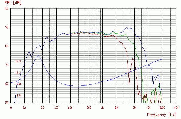

Here is the Fostex 208 E Sigma driven by a voltage source, Rg < 0.1, and a current source, R0 = 47 ohms. Voltage source, with little bass output is in dotted line, current source with 47 ohms output impedance is solid line.
