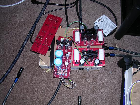

All I can say is build it. Use whatever pots you have laying around and listen to it while you wait for a proper attenuator. Here is a pic of my present preamp. It is a BOSOZ running off one power supply mounted to a Clementine box using a stereo pot on each side for each channel. Not quite enough balls for the F-4, but it gets the job done until I reach an Impass.

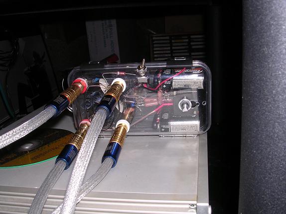

DaveM said:Here is the pre I was running. I used a small tackle case that I got free somewhere. Pretty funny when you know that I have a lathe and Bridgport in my garage and work as an engineer with full access to a machine shop.![]()
Get to work🙂
I try to re-use old boxes, old surplus heatsinks or whatever.
Call it green, call it cheap. Call it DIY.
The second PIC looks like a DIY maniac IPOD.
